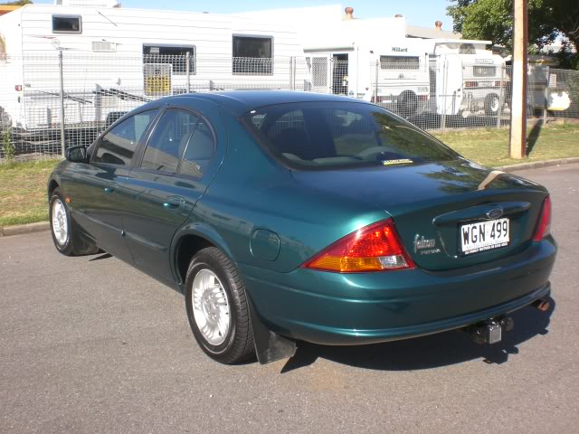

My biggest gripe with my S-Type is that it looks like a 99 Ford Falcon from the rear, which is one of the least loved Falcons of the modern era (the new millennium's Edsel). & people keep asking me why I bought one of those old dogs.
I doubt that it's a coincidence, as Jag was under Ford ownership at that time, & the elliptical curves were part of Ford International's new "edge styling" language, which was a dismal failure in this country.
Are there any Fords in your country which share that design philosophy, & look a little like your Jag? & does it cheapen/lessen your Jag ownership experience? eg I really don't like the look of the rear of my car now, due to that association. & I think the S-Type would have been better suited with a rounded rear, more like the original 60s Mark II S-Type.
& I don't think they look that similar either, as I've always admired S-Types, from every angle. & I've never liked AUs. It's only the curve of the boot/trunk, the licence plate holder, & the angled tail lights that share the visual cues. However with such a large number of friends thinking I've bought an old Falcon, on seeing the rear of my car poking out of the garage. I have to say that for your average Aussie Drongo (drongo australis) it's an AU Falcon.
