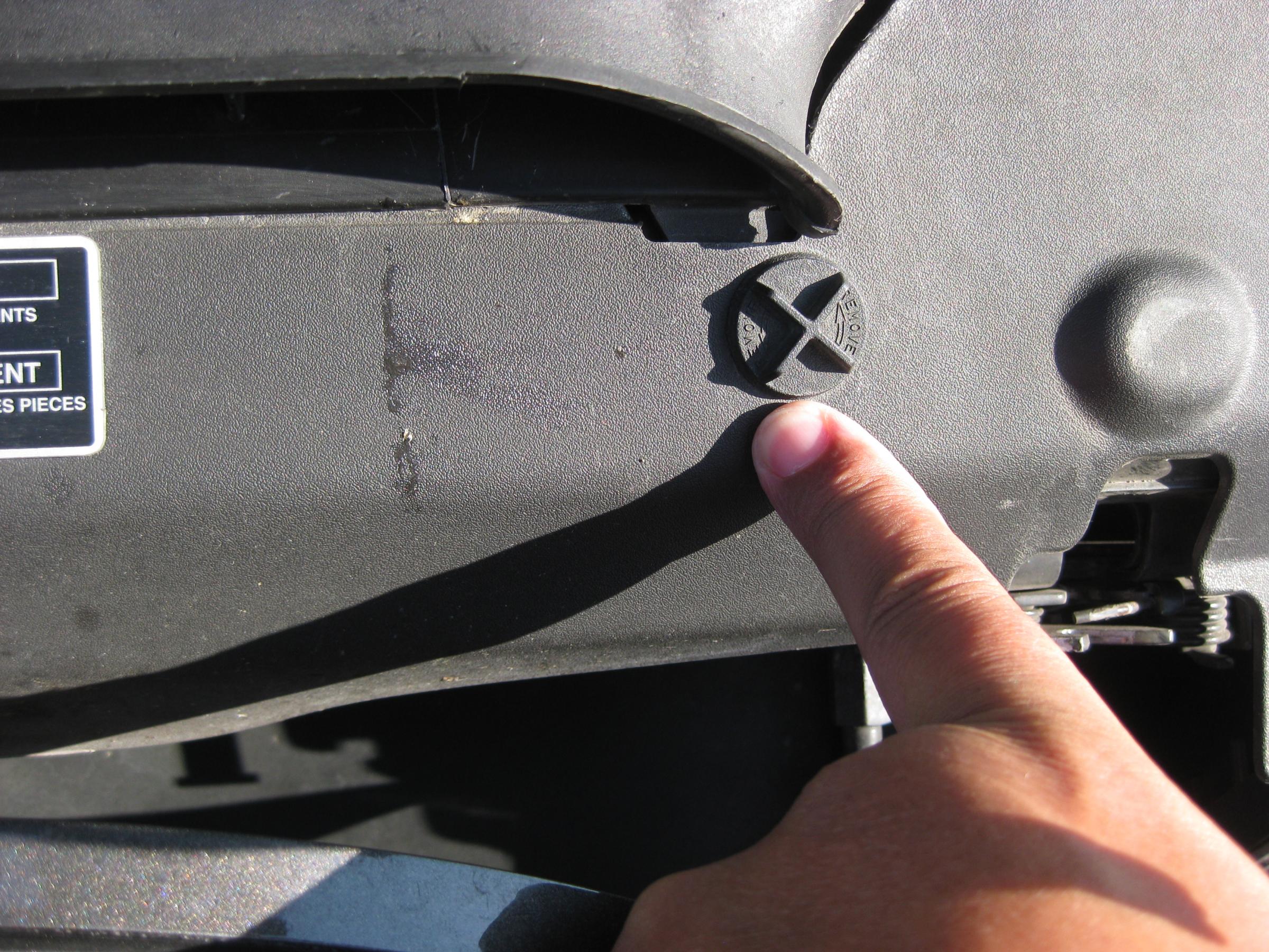

Hey folks YES I've looked in the JTIS and searched here and tried an internet search with no luck.
I am looking for the little plastic screws, tabs, clips (not sure what they are called)that holds down the radiator cover and air intake.
Two are missing and the two that are on are broken.

I believe Bonnet "Fasteners" - download S Type Parts listing for exact part number.

I couldn't find it in the parts manual because they don't show it but I found it on another site, Gaudin Jaguar. Its called the "Sight shield clip" FYI the part circled on the downloaded parts catalog is not the clip but the number 9 as a part reference. On the Gaudin site it shows the clip.

part number for those is
XR8-12941
about $3 each

It's in JEPC under exterior fittings and sunroof/body trim and fixtures/engine compartment covers/item 4

They are also used on the Lincoln LS so any Ford dealer will have them in stock.

Just bring in the old one and they should have no trouble finding them. If they need to look it up the LS uses them to hold down the same radiator shield as the S Type does.

I found them on the internet at Northland Fasteners. The ones you want are Part Number N 20518 for the radiator cover. You may as well pick up some N 20233 for the cowl scuttle while you are there. They charged me $6.75 for shipping, which beats running all over town trying to find these things. Good luck!
