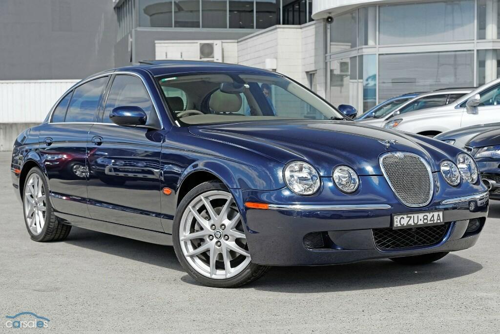

I just picked up a 2007 3.0 S-Type to keep my 2005 XKR company. The new baby drove delightfully on the trip home, but I noticed that the door armrest mirror/windows switch panel became quite warm. Everything still worked okay but I doubt the panel should be other than normal temperature, especially on a cloudy/showery day. I'm taking it back to the dealer where I bought it for them to check it out, but any tips/thoughts on what might be causing it would be most welcome. Many thanks - all the very best, Graham.
