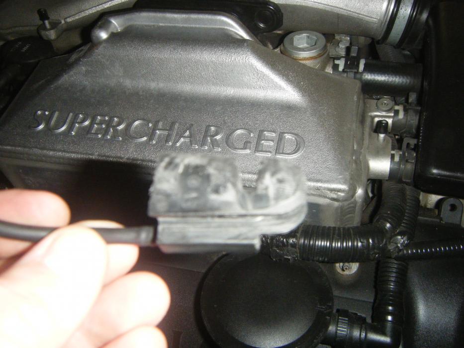

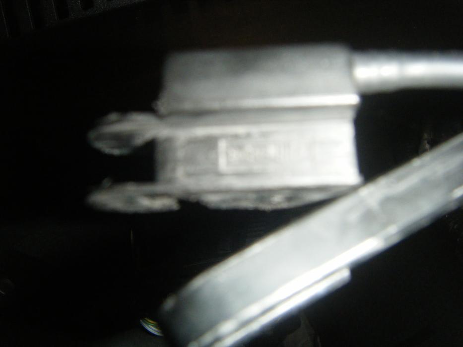

I just used a standard Anco blade from Autozone. I was taking a 800 mile trip one way and knew I was gonna hit rain to I replaced my passenger side since it wouldnt hit the windshield at all. Switched out the blade arm and now its all good. My drivers side it starting to streak so I'll probably put a new one on there soon. I just checked out the clips I was talking about and I think you were right Rick cause they say Trico on them so I think is was an aftermarket item that was added by the previous owner. They work great though they just replace the clips that hold the wipers on and there is your nozzle. Below are some pics of the nozzle that I have which is why I was confused.
