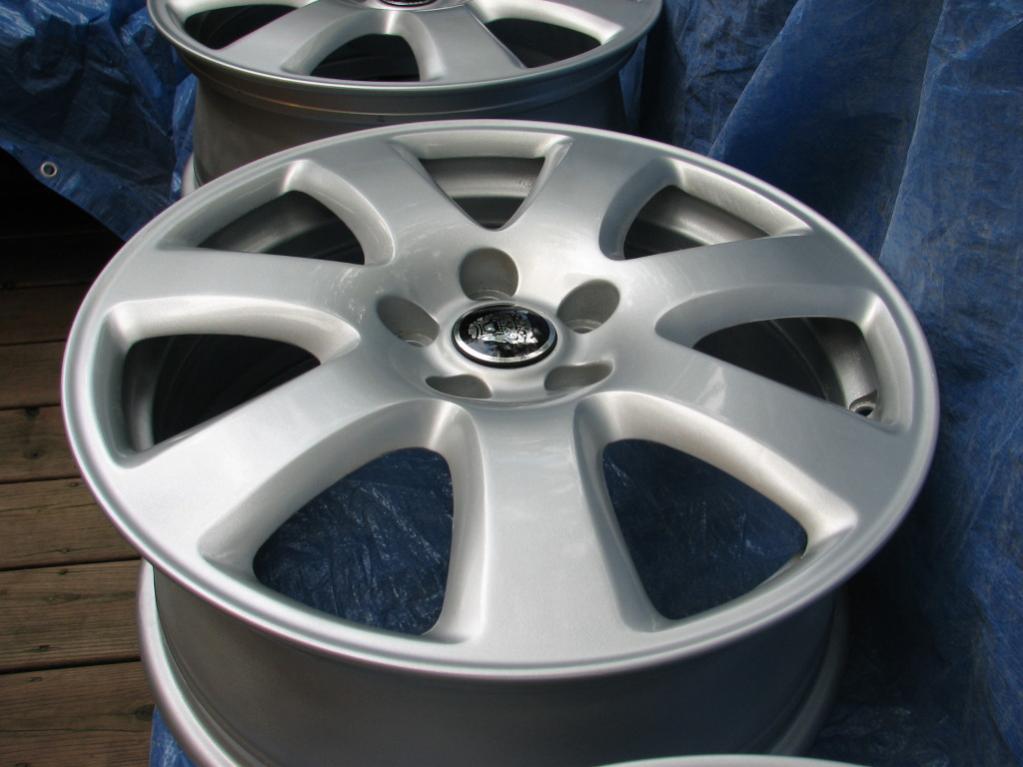

I am about to buy Jag OEM wheels that fitted an X-Type to mount winter tires on. Thes are 17" 108mm x 52mm offset. Please can anyone tell me for sure if these will fit an S-Type? If they will fit do I need alternative lugnuts? Please see attachment.
Thanks
2006 S-Type 3.0

They should fit fine. Do you have OEM wheels on your S? The reason I ask is all the OEM jag wheels have a flat seat for the lugs while aftermarket wheels take a conical lug nut.. So, if you have OEM lugs you are fine...
BTW>> Search here on lug nuts and you will see that the Jaguar factory lugs are really bad and I recommend when you switch wheels change the OEM nuts as well...

I thought they may fit as they share the same 108mm x 5 pattern. Yes I do have original Jaguar wheels.
I am looking to get ready for winter and will mount winter tires to the soon to be purchased rims in December. I've found snowfall renders the S-Type virtually unuseable with regular all season tires and hope this is the answer.
