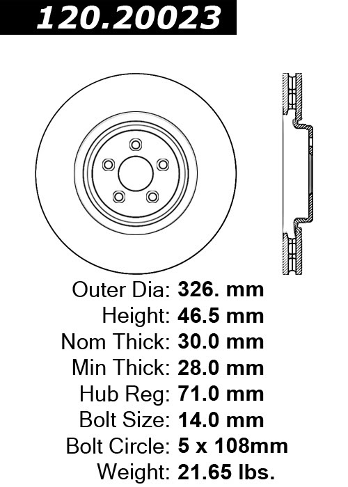

I was surprised too actually. But when I look up the part numbers they arer indeed 326mm.
Front
Rear
Old Oct 13, 2010 | 06:36 AM
twastheglow's Avatar
Joined: Oct 2010
Posts: 19
From: Binghamton, NY
^ And those are Centric part numbers/diagrams...but after measuring and find them both to be 12.8", I guess it's correct.
