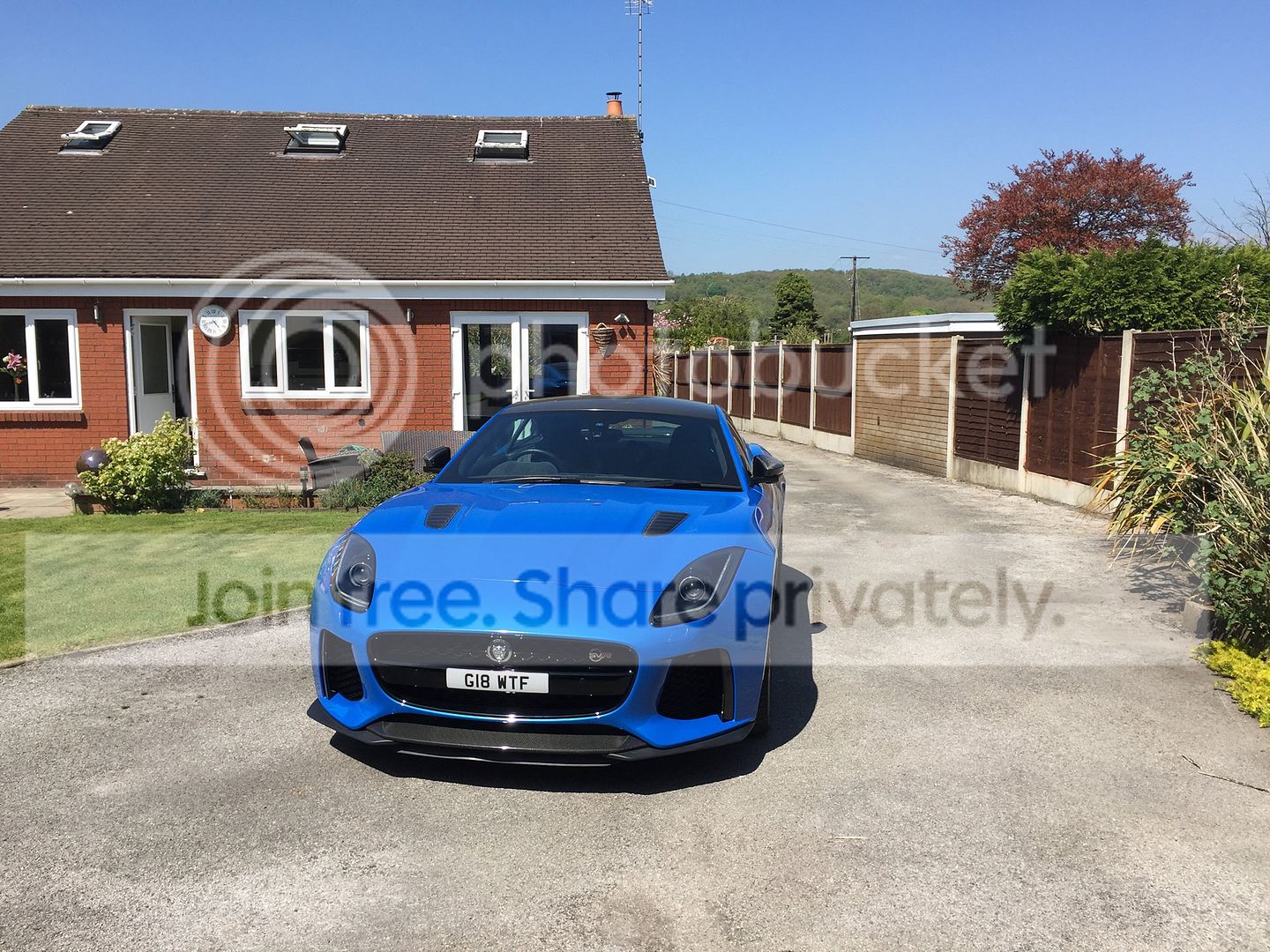

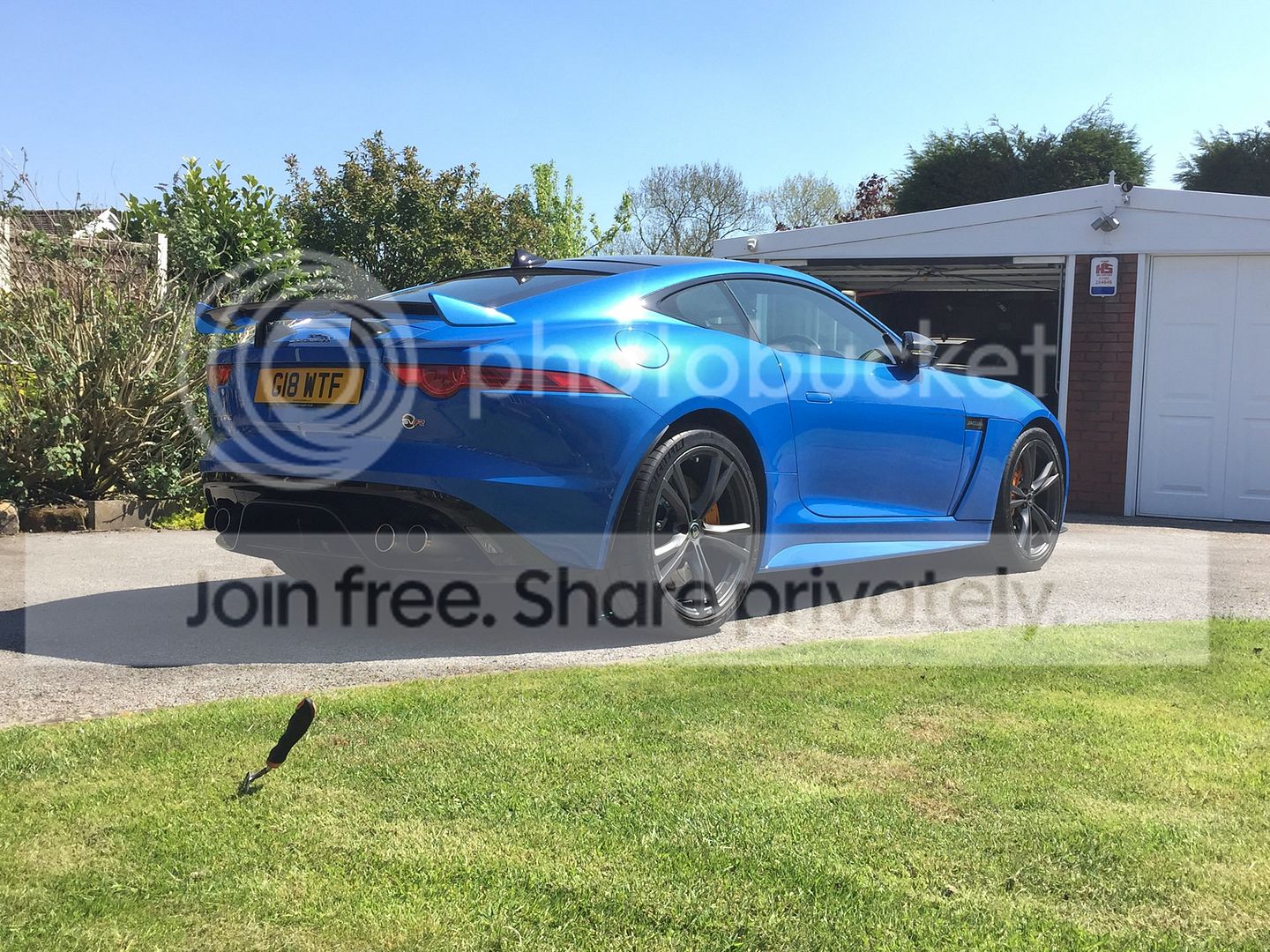

Some photos of the car in the sun.
Its a much neater install, cannot be seen behind the grill with the benefits of drawing cooler air but also been able to catch air in motion to try and a create an ram air effect.
Will it make me go any faster, who knows, probably not but it certainly did not slow me downon the trial setup resulting in a PB of 11.2@124mph in not ideal conditions. Hoping I can get an 11.1s run, which will make me very happy considering the car is still stock and that pretty much then guarantees a lower pulley and map should yield a high ten second run.
