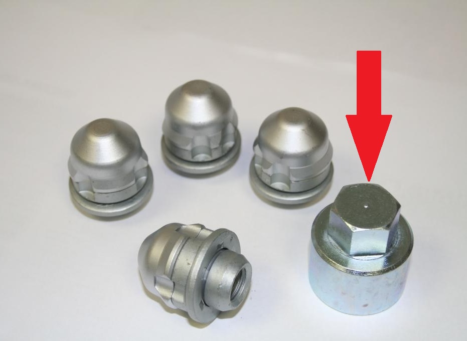

If your car has standard Jaguar locking wheel nuts, you are looking for this adaptor to remove them:
It should be in the polystyrene tray together with the lifting jack and other wheel changing tools. If it's missing, a Jaguar Dealer can lookup the correct code number for it from your VIN and supply a replacement.
