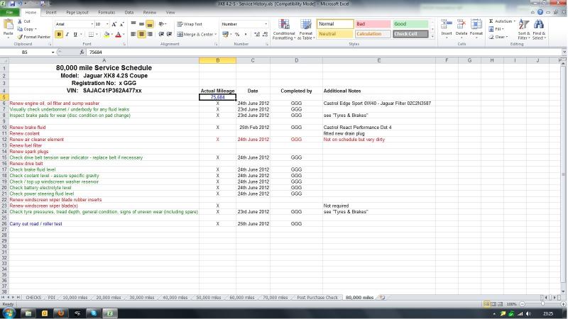

I've always done my own servicing:
1. to know it's done properly
2. gives the opportunity for thorough inspection
The important thing is to document what has been done. I record the Scheduled Service sheets in an MSExcel Workbook and annotate dates and comments for each action. Here is an example of the latest service on my current XK8:

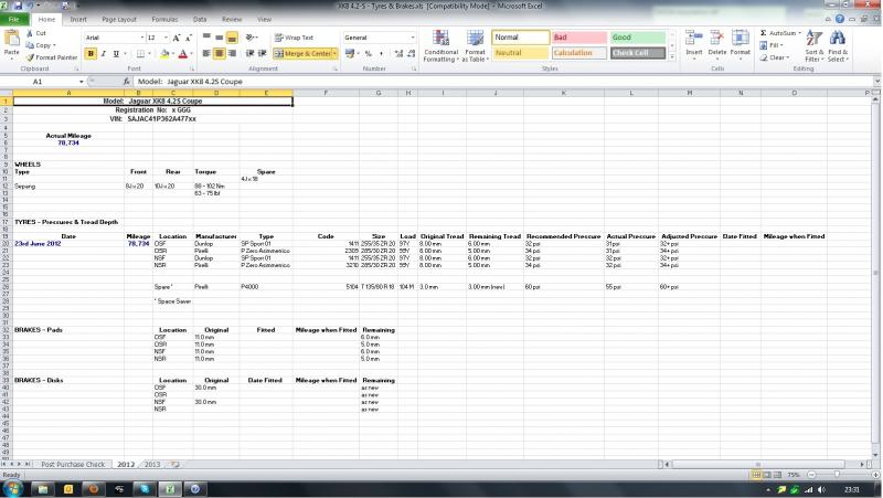

Tyres and Brakes are summarised on a second spreadsheet:
The completed sheets are printed off and attached to the Service Portfolio Booklet. Accompanying this is a file of receipts for parts and materials.
Whenever I've sold a vehicle, the buyer has never failed to be impressed with the documentation which exceeds the usual rubber dealer stamp as a detailed service history.

Thanks Graham. Think I'd be impressed too and happy the proper checks had been carried out.
I'd have to go to a garage tho when it came to anything too techy - ie drive belts etc, but I guess that's once every x years.

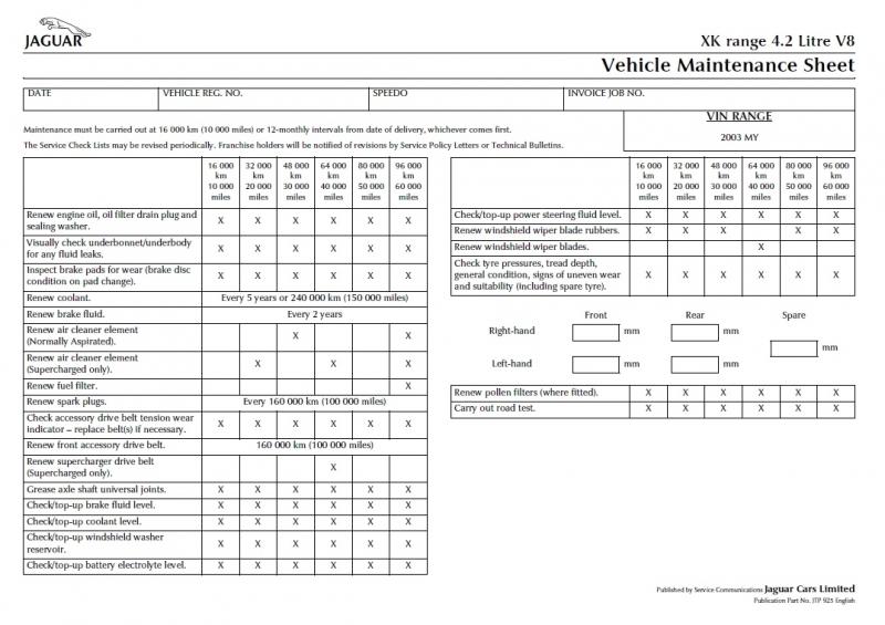

Jules,
Here's the official Jaguar schedule:
As you can see, it only goes to 60k miles. After this, the sequence is repeated.
Here's an extended version to 150k I did for a US member a few months ago:
Jaguar XK8 & XKR 4.2 Maintenance Schedules.pdf
Nothing too complicated in the schedules but major bills from a dealer or even an independent.
Note that transmission fluid doesn't get a mention in the Jaguar listing. It's controversial but many on the forum have changed fluid and filter.
