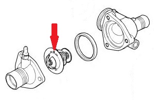

Provided there's no accompanying coolant loss, the regular favourite culprit is the Thermostat sticking followed by the Water Pump.

I agree it could be the thermostat but the header tank has hot coolant inside I would have thought if thr thermostat was not working I would have no flow to the header tank.could it be the radiator fan switch

The coolant in the header tank will heat up with or without the thermostat open. A thermostat can fail completely closed but more often sticks partly open, restricting the flow.
This doesn't discount a non-operational radiator fan switch as a contributor or cause of the overheating.
