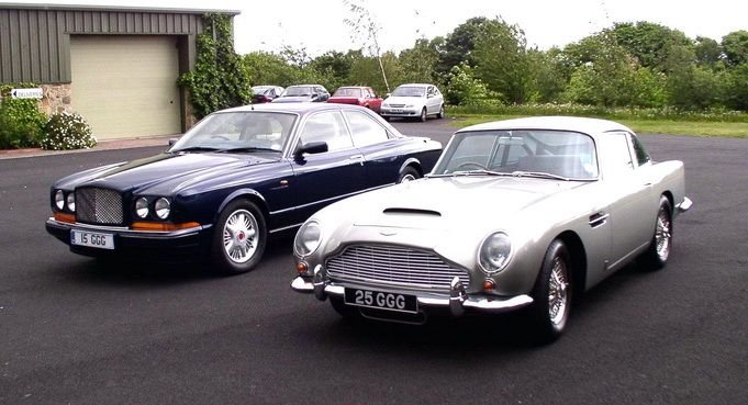

Attached is the Bentley recommended storage procedure I used to have carried out on my Continental R for three months each Winter and on my Aston Martin DB5 for considerably longer periods. The only thing I would change now is NOT to remove the battery but to maintain it on a CTEK and the transmission fluid level check does not apply to Jaguar.

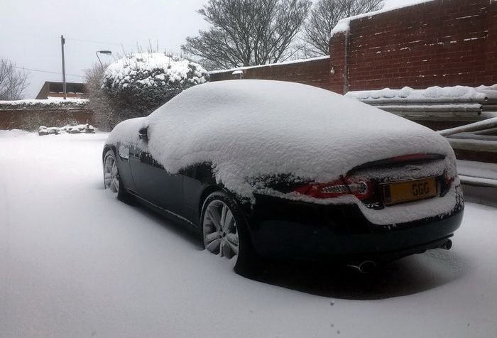

My current Bentley Continental GT rests safely in an unheated timber garage each Winter with no adverse effects. My Jaguar XK is used as a daily driver and must withstand whatever the weather throws at it.
