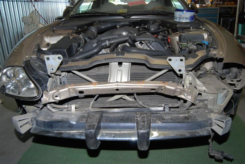

Hey
Would really be interested in the front bumper support (picture attached), looks like you've removed it for your kit install.
Thanks
Dwight
757 818-3878
