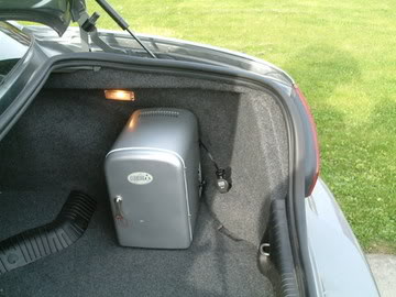

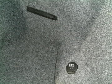

Jaguar sell a 12v auxilliary socket kit for not much money.It comes with instructions for fitting in the boot or glovebox
There is a12v permanent supply in the boot which I used for the Jag12vkit in the boot.
Its on the LH side wall between the CD changer and the LH rear light behind the panel above the 1/4 panel vent.
I cant find the link for when I posted pics of the install but if you go to
http://www.ownerinfo.jaguar.com/extf...prod/index.jsp
Click On X Type and then
Accessory fitting instructions then on
Continue
Then do a search for
Power Socket
and click on the link that comes up entitled Auxilliary Power Socket (you will need to disable Norton when you click on it or it wont open)
If you look at picture 97 it shows you the location.
Socket locationmoved since above pics due to fitting sub but you get the idea.
