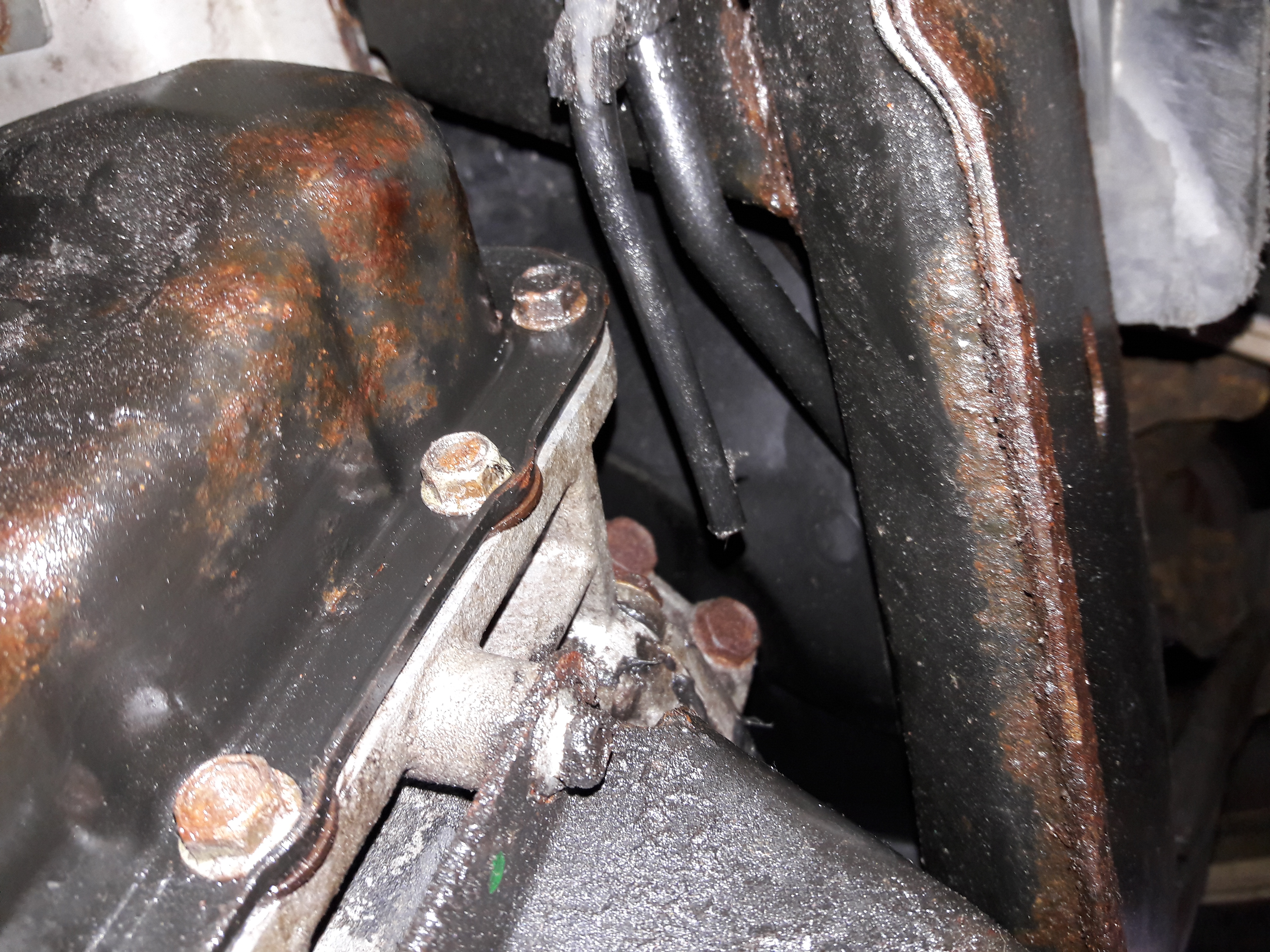

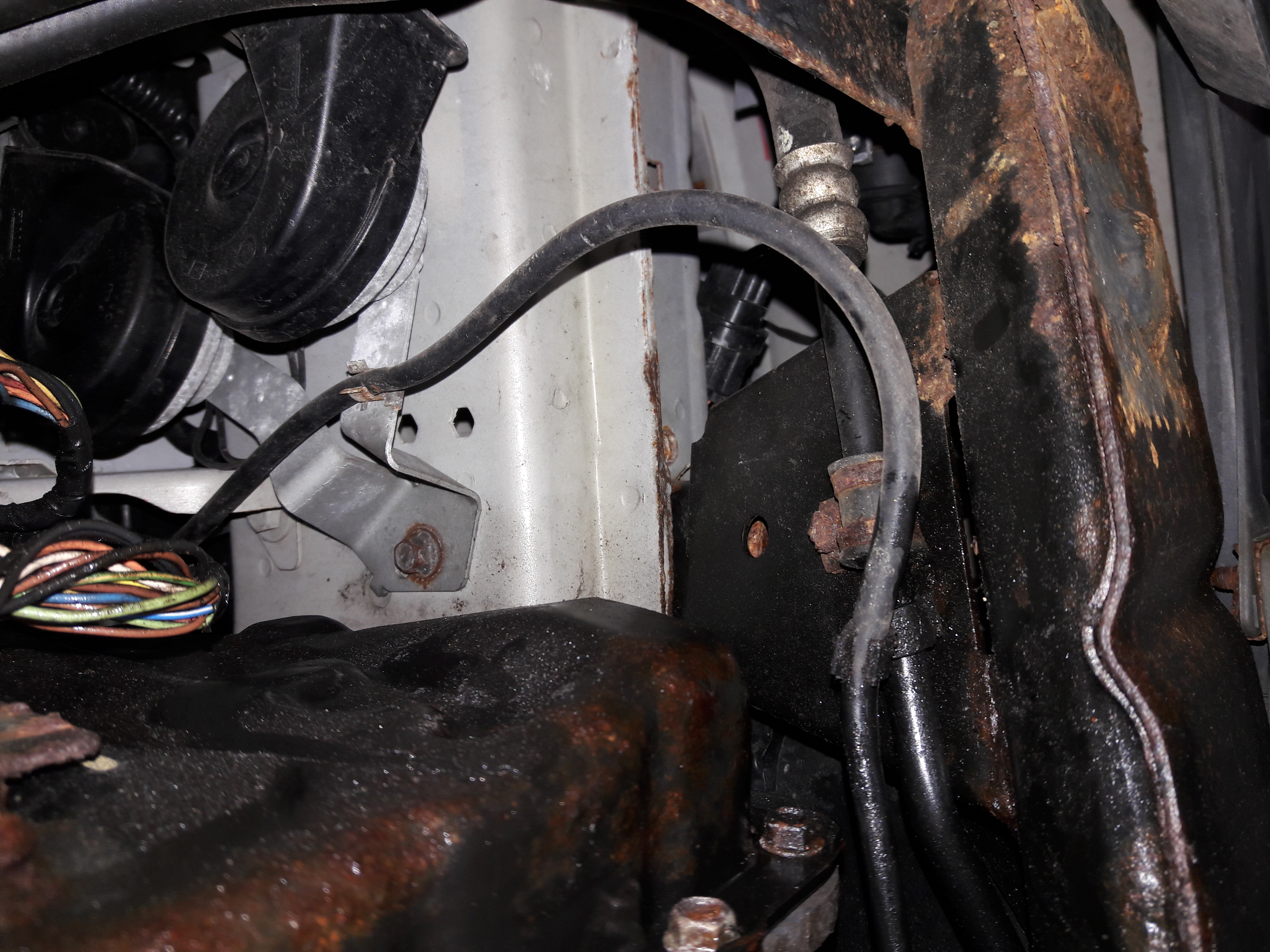

My 02 X Type 2.5 automatic has not in shifting smoothly, it shifts rough into 1st and 2nd occasionaly and usualy hesitates shifting into 3rd. I'm planning on changing the transmission fluid with fuchs 4400 titan atf tomorrow. I just put it on the lift at my body shop and noticed a vacuum hose that looks to be disconnected not sure if that could be the culprit there are no lights on the dash and I have yet to been able to check for codes with a computer I hope it's not too serious.

That looks very much like the battery vent pipe. How do you know it is a vacuum pipe.
