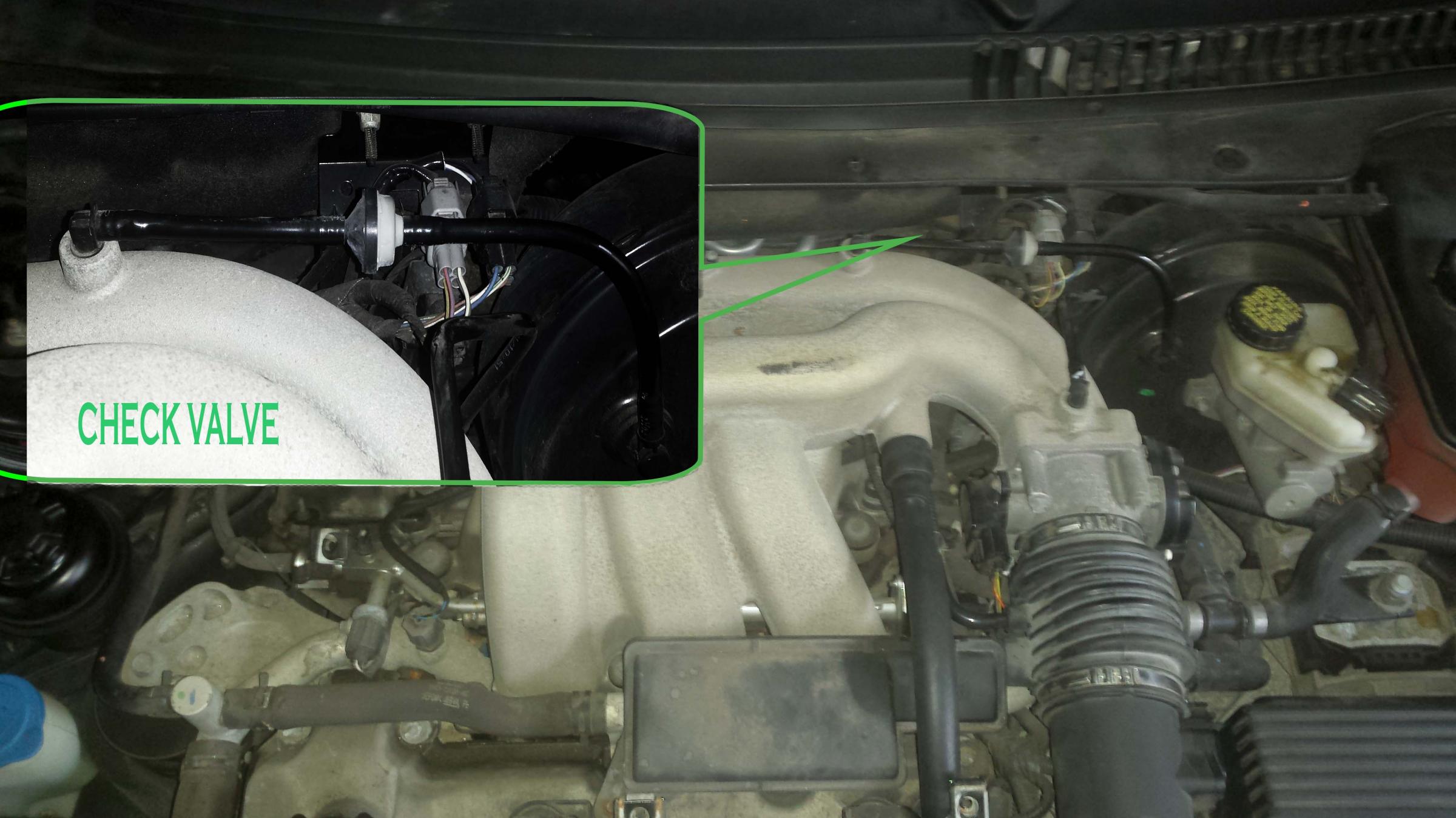

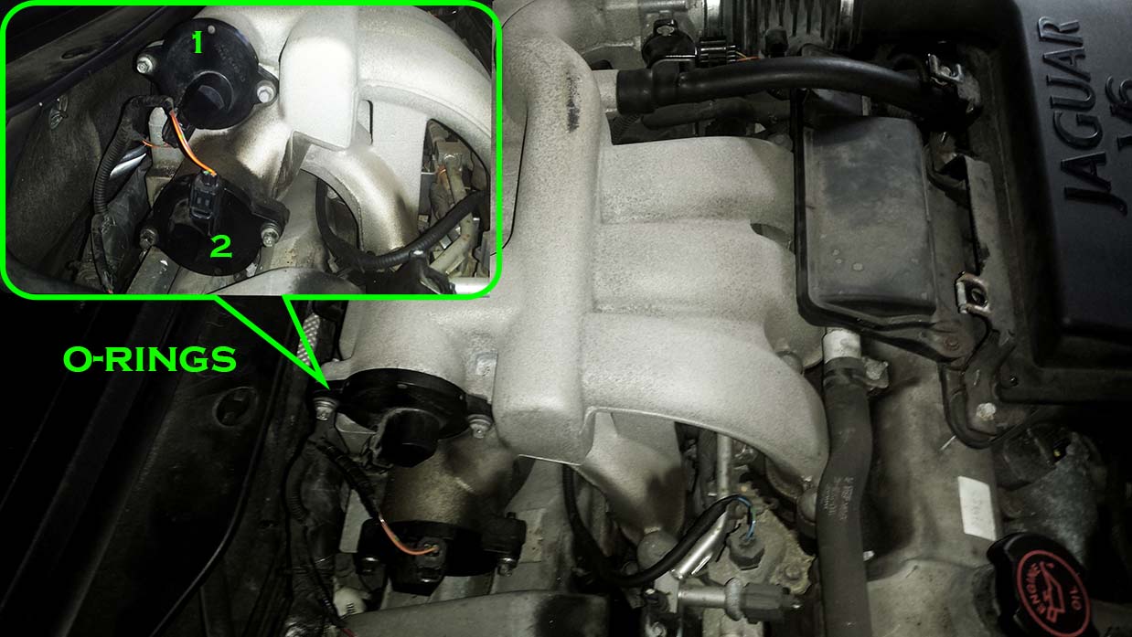

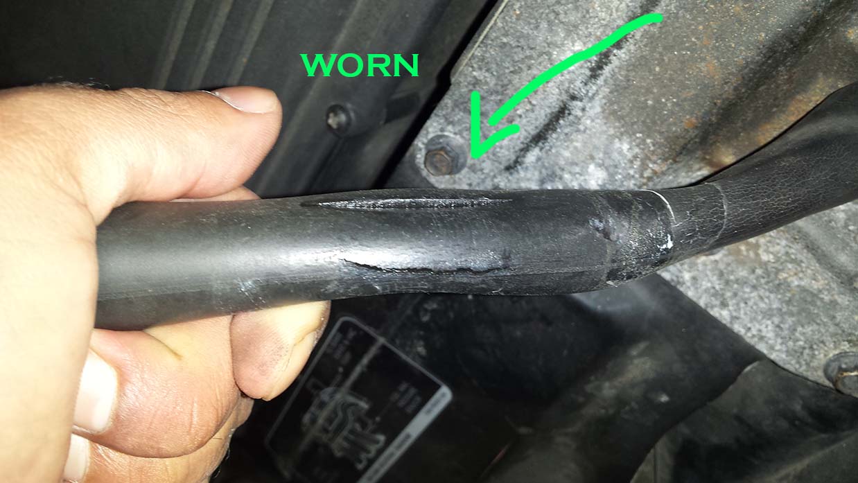

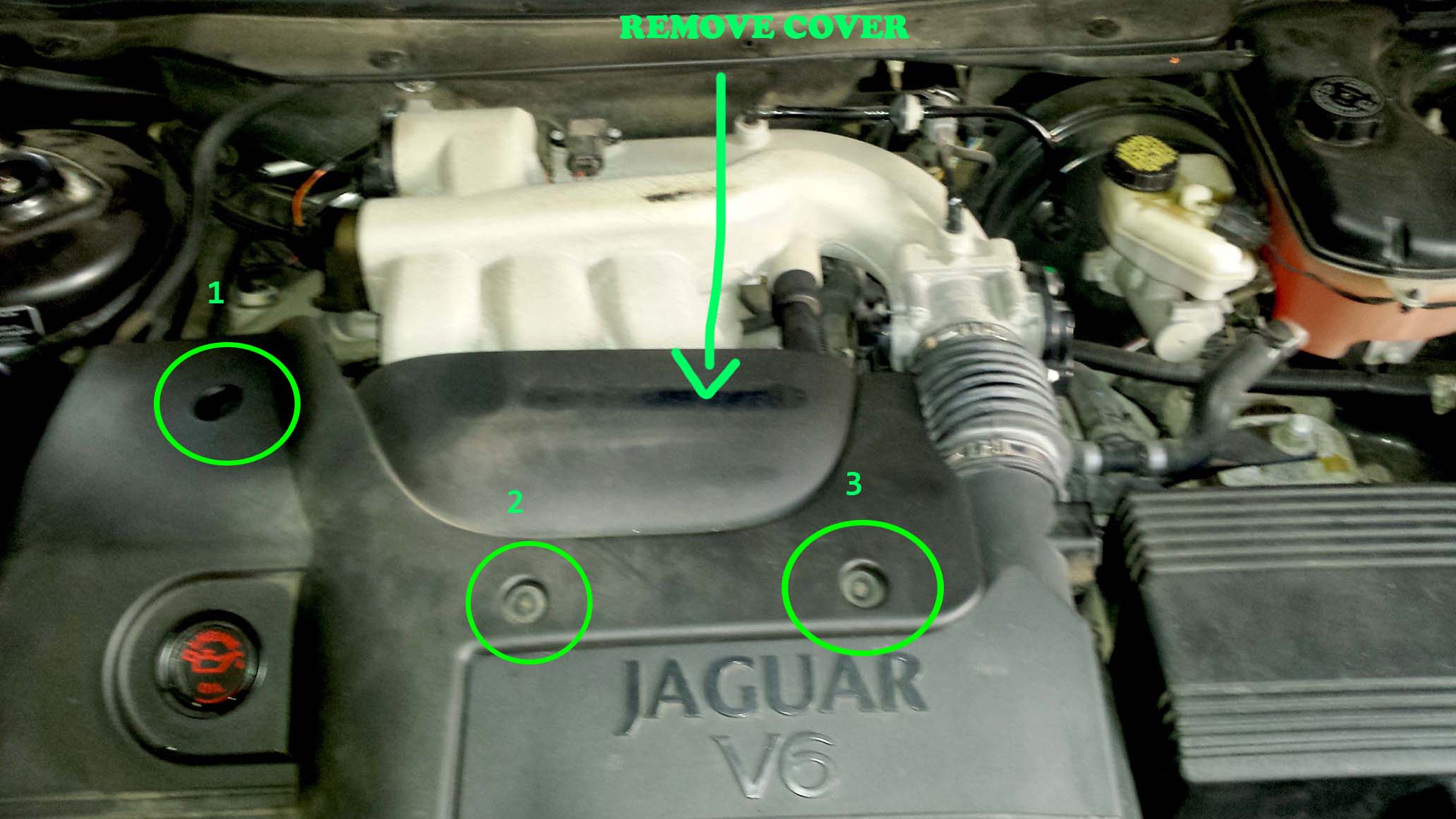

Default Cruise Not Available
I had the "No Cruise Available" fault. I had to replace all these parts, all were bad.
Three main causes.
