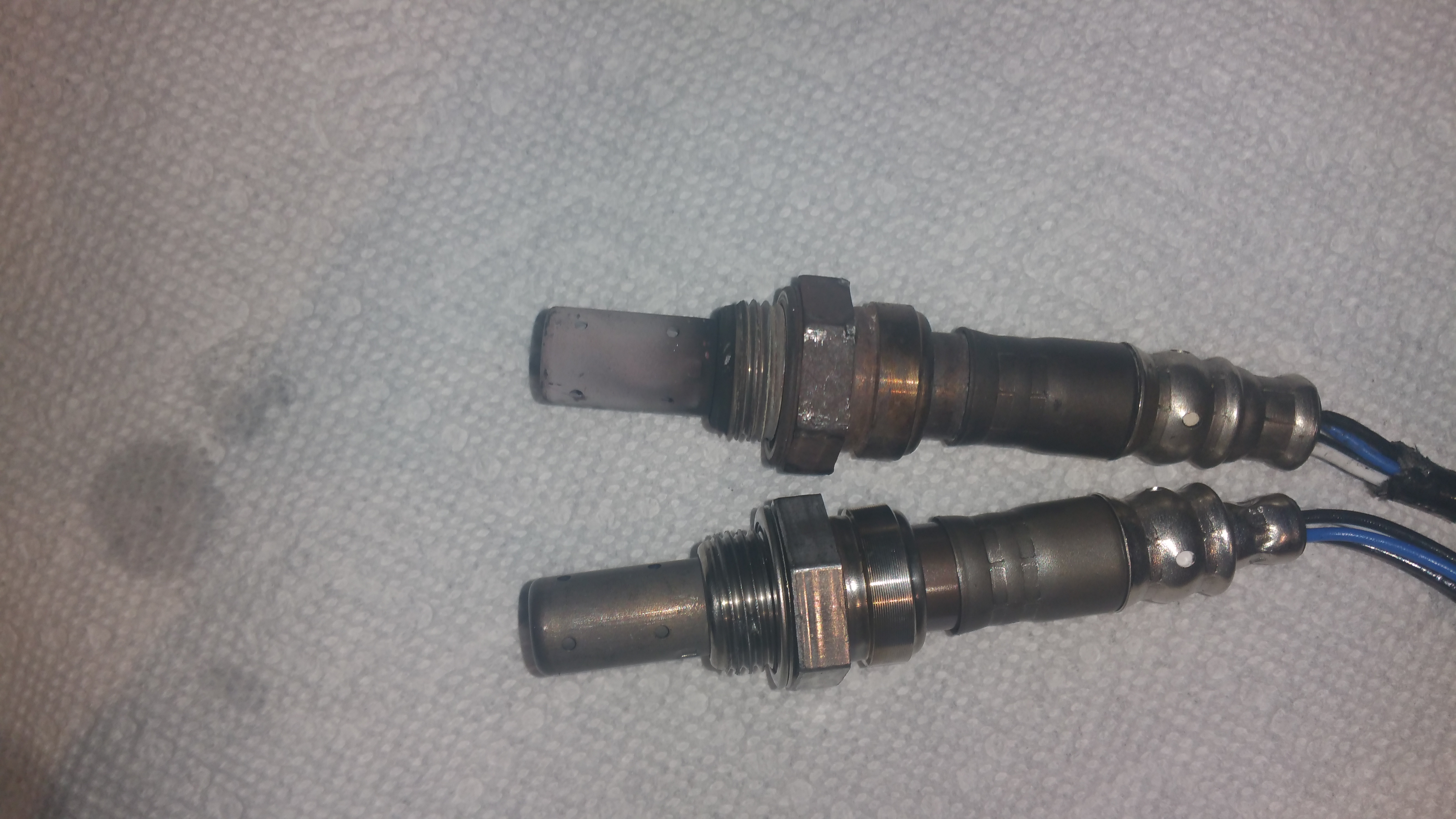

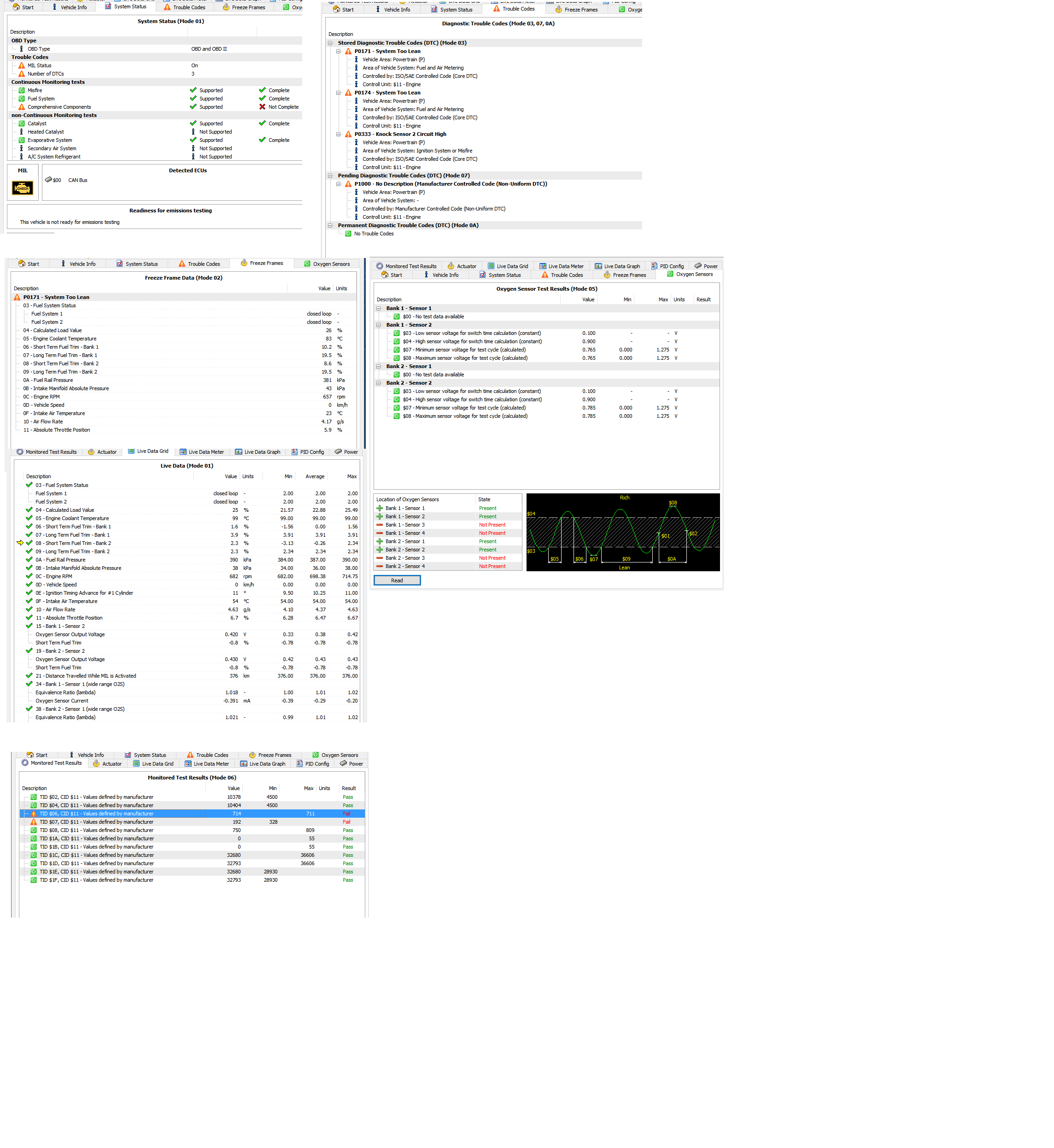

Same issue, replaced one of the sensors, the one closes to the radiator. I need to replace the one behind under the manifold. Need to run it to get the new code. Cruise not available wil come up and this is due to the O2 sensor on my end. The sensor I took out was beaten like a b****. So, it needed replacement. Check out the picture of the ODB reading and the bad and good sensor.
