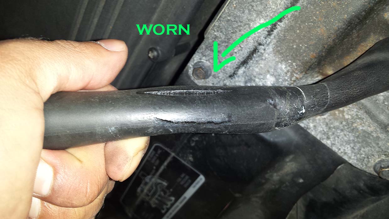

After a year and a half the problem came back and occurred more and more frequently. Ended up being leaking valve cover gaskets. Oil was getting into the spark plug ports and onto the ignition coils. The system would shut off half the engine, hence bucking or no acceleration. Replaced ALL ignition coils, plugs and gaskets. $1600. Now it runs like new, even with 208,000 miles on it.

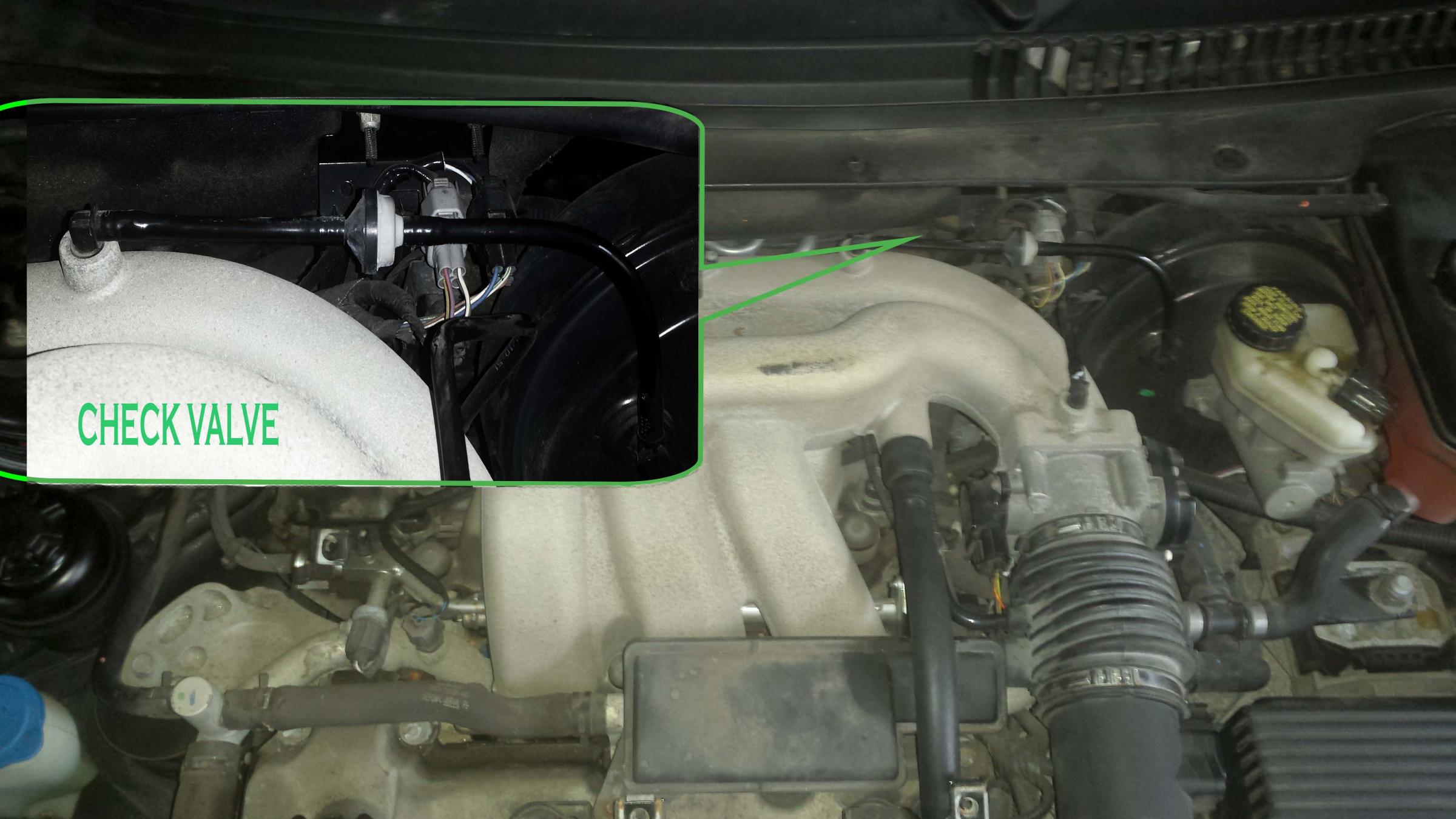

Hi. i have quik question, 2003 jaguar xtyp 2.5. im try Replacement Brake Booster Vacuum Hose Check Valve Tube. Booster side its easy, but how is comeout, take out intake side ??? Thanks...
