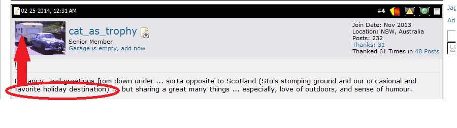

Originally Posted by cat_as_trophy
......... greetings from down under ... sorta opposite to Scotland (Stu's stomping ground and our occasional and favorite holiday destination) .......
These Australians are mad, absolutely mad -Scotland as a 'favourite holiday destination' !

Graham ... your sense of humour becomes you ...
The submarine you see hitched behind the Jaguar in my avatar, made for some interesting, wet, but very long drives from Australia to Scotland for holidays ... LOL. Of course we are all mad here in Oz. It has to do with our families being sent halfway round the world to a land of sunshine, surf and sand ... while our "betters" got to stay home in the snow, slush and cold. Actually, I am serious about our love of the Highlands. Our farm out here is "Glencoe Park" in celebration of Stu's native GlenCoe, where in recent years we bought a little plot of land.
