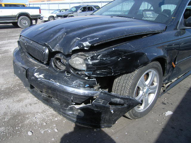

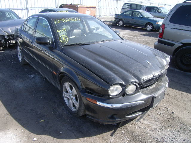

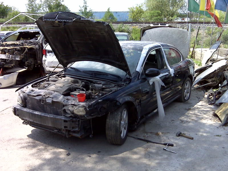

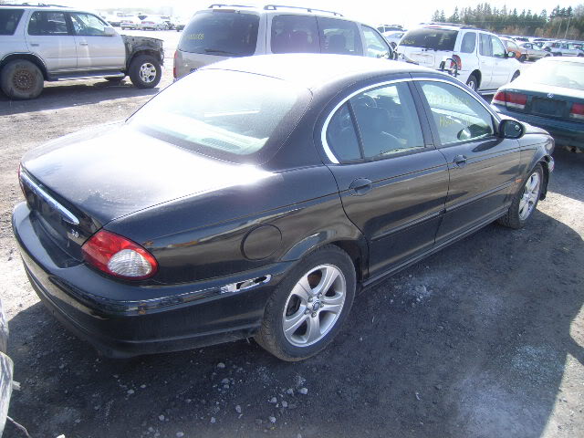

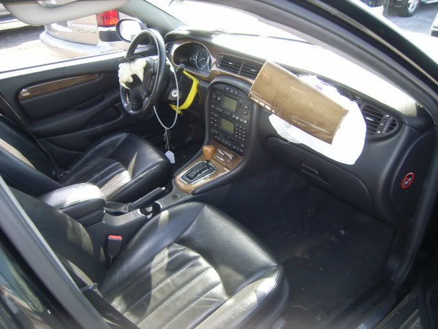

The way I saw it from an Insurance auction:

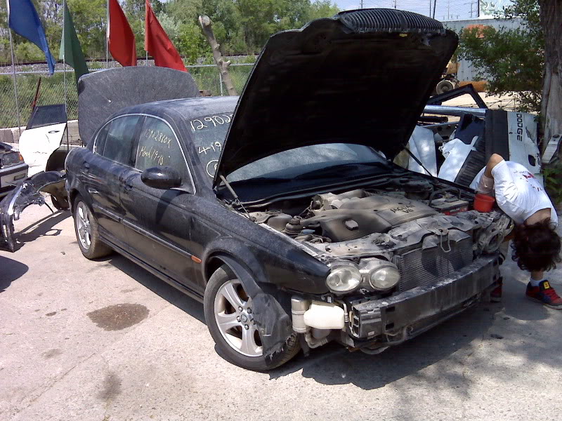

Finally Arrived took the pictures after I started to take it apart... The picture don't show the whole damage, but in short there is front frame damage, which needs to be fixed, Radiator Support needs to be fixed....and quite a few things actually but I'll get to it later on in:

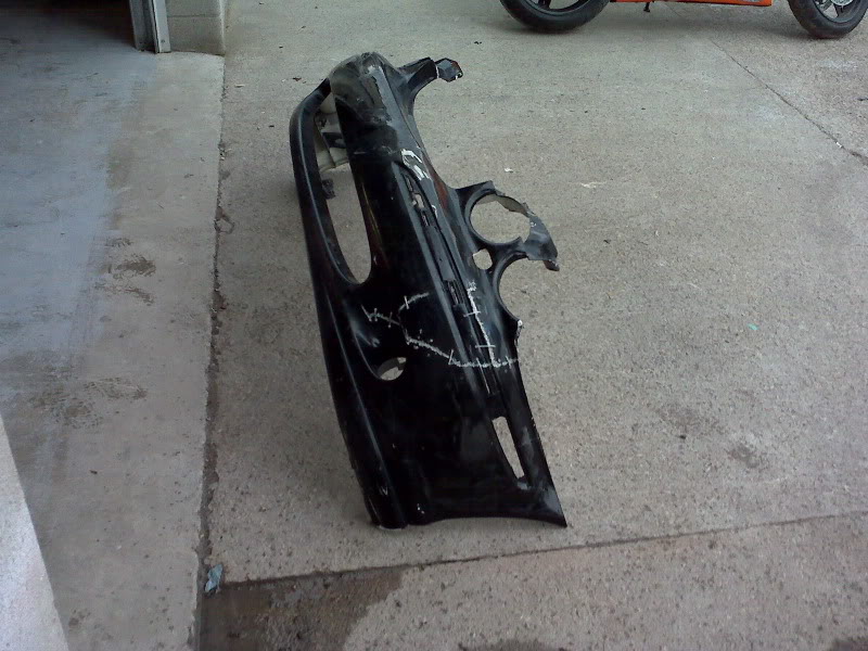

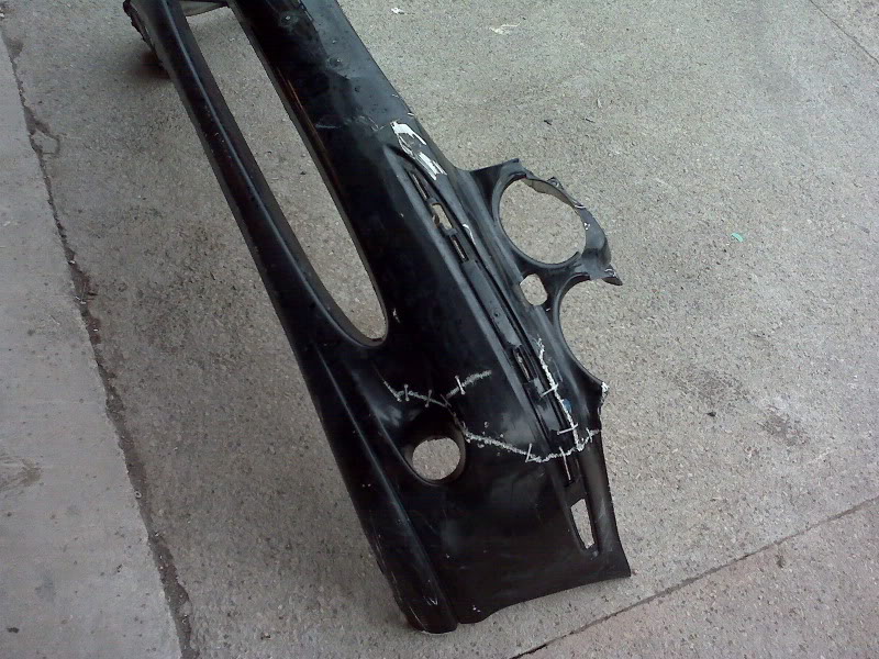

My first challenge was to tackle the bumper that was in pieces, I wanted to put it together because I didn't want to buy a new one and start cutting it to make it a bit custom/tastefully different.
so I drilled holes around the cracks, zipped tied it together to get the shape, plastic weld it, to make the crack stronger I put JB weld on the inside...

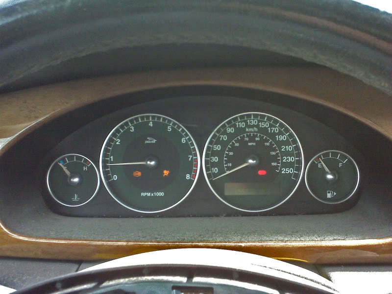

And Today, I finally first day after 3 months, Thanks to this forum and all the information here.... she finally started :
Thank You.... Jaguarforums.com
After some soul searching and losing my mind, she is running.... I can't describe how happy I am , although its a long way ahead of me, she sounds beautiful.
