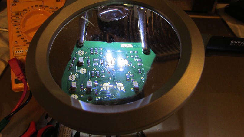

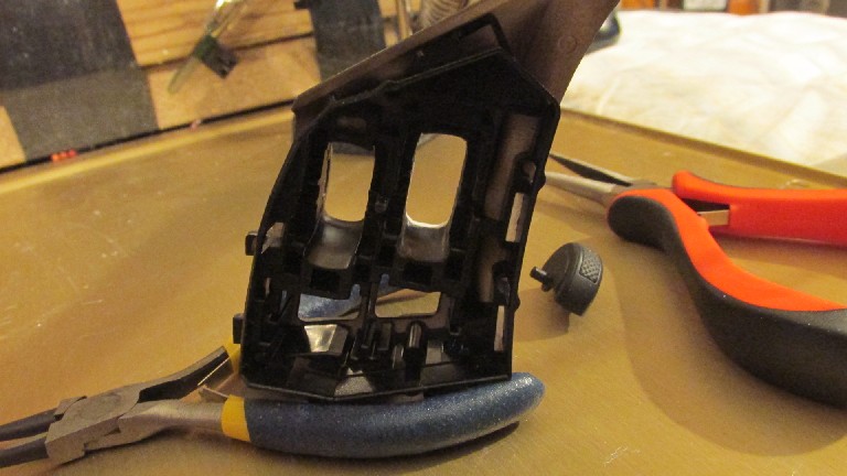

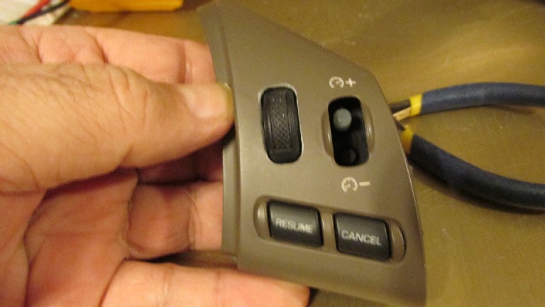

The airbags are different, and the 'new' cruise controls on the wheel do NOT play with the 2002/2003 controller, although if you are mechanically inclined, the controller can be made to play by adding the 'missing' control to the switch pack.
