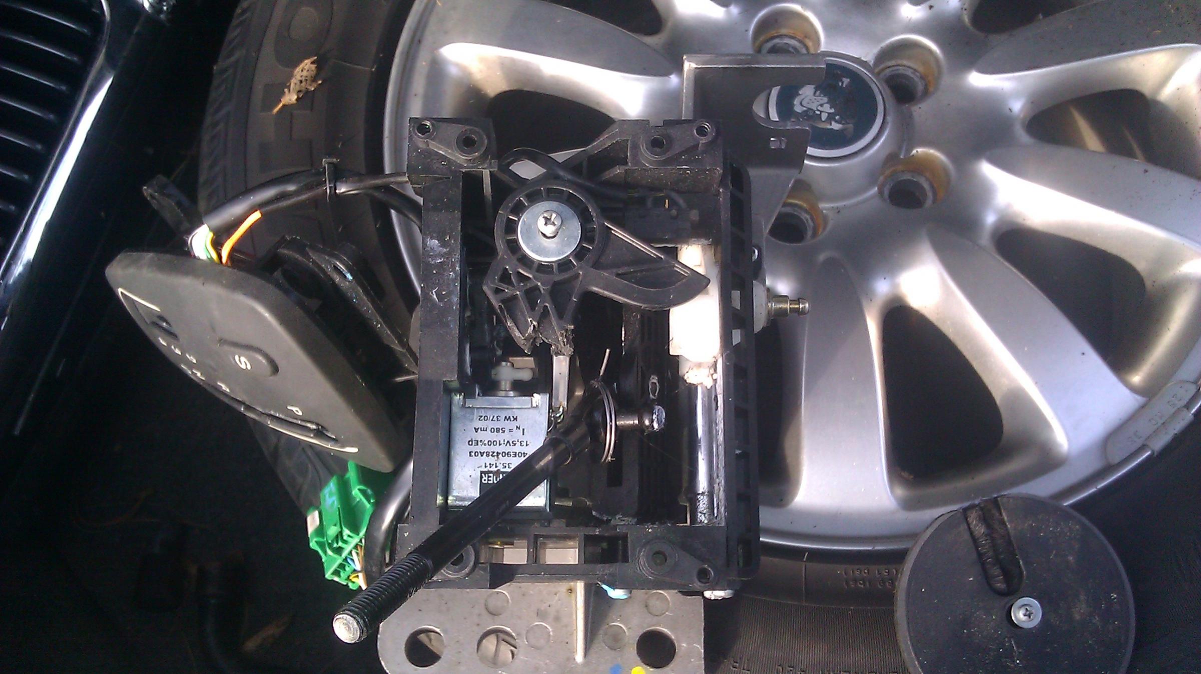

ok, my Jgate is installed but it will not get out of reverse, The reverse light goes on,
here is you tube video of it, and the pdf, file i have not went under the car to to do the cable adjustment,
Please advise,
Thanks Herb
https://www.youtube.com/watch?v=wkdC...ature=youtu.be
https://www.youtube.com/watch?v=SBPe...ature=youtu.be
Attached Thumbnails 2003 xtype J gate installation will not start-jag1130jgate-006.jpg
File Type: pdf
Old Nov 30, 2013 | 02:24 PM
mikesmith2's Avatar
Posts: 326
Likes: 63
From: Reading UK
Is the interlock disengaging?
Is the foot brake switch working?

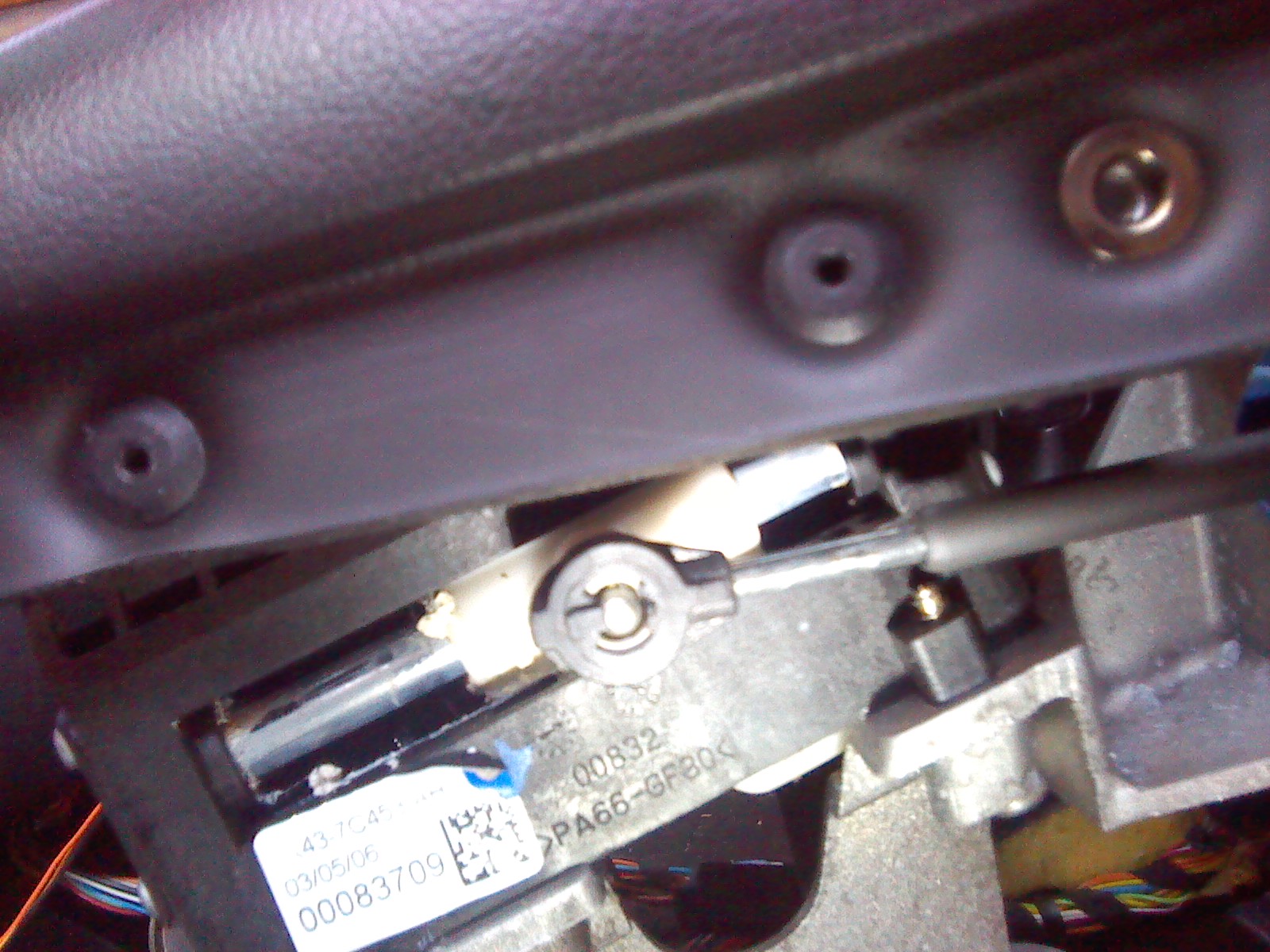

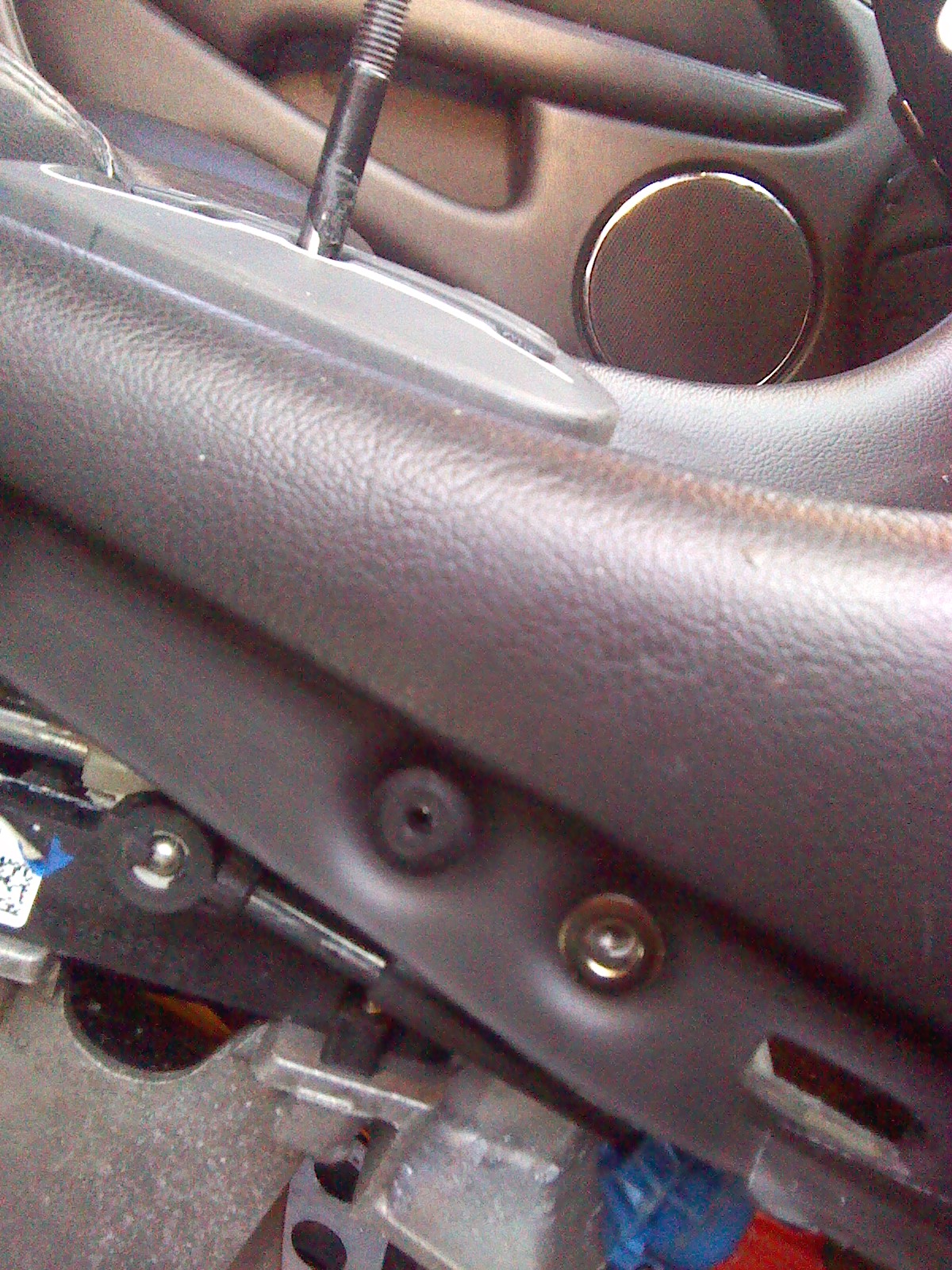

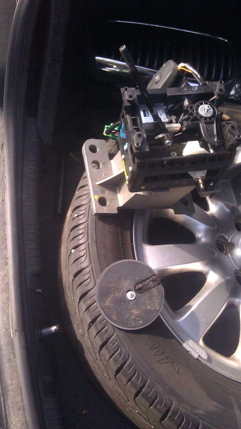

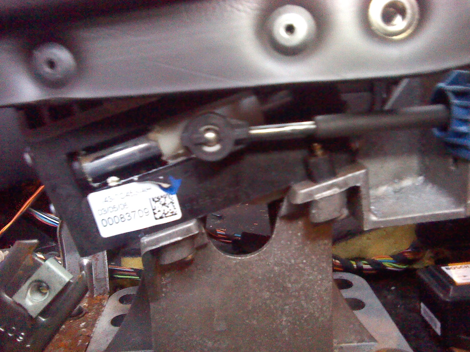

it will not go to the park, position, i moved the mechanism shaft, tried manually,
Is the foot brake switch working? what is the foot brake switch, i will post, pictures,
Please advise, thanks for the response
Attached Thumbnails 2003 xtype J gate installation will not start-jagjgate1130-009.jpg   2003 xtype J gate installation will not start-jagjgate1130-005.jpg   2003 xtype J gate installation will not start-jagjgate1130-003.jpg   2003 xtype J gate installation will not start-jagjgate1130-001.jpg

The switch operated by the foot brake allows the lever to shift into and out of the park position.
When you put your foot on the pedal you should hear a click in the J gate, this is the solenoid releasing the inter lock to allow the shifter to move

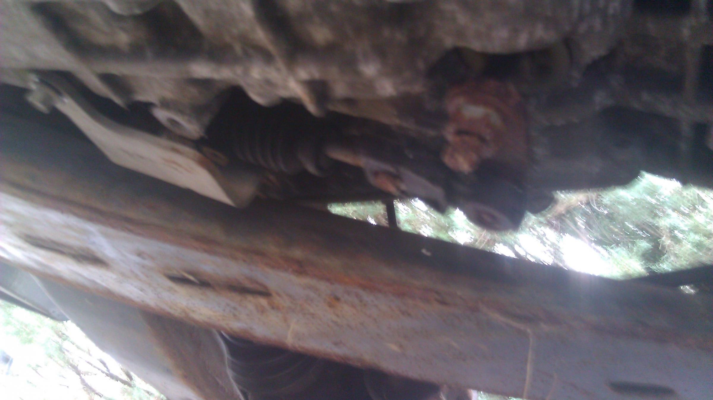

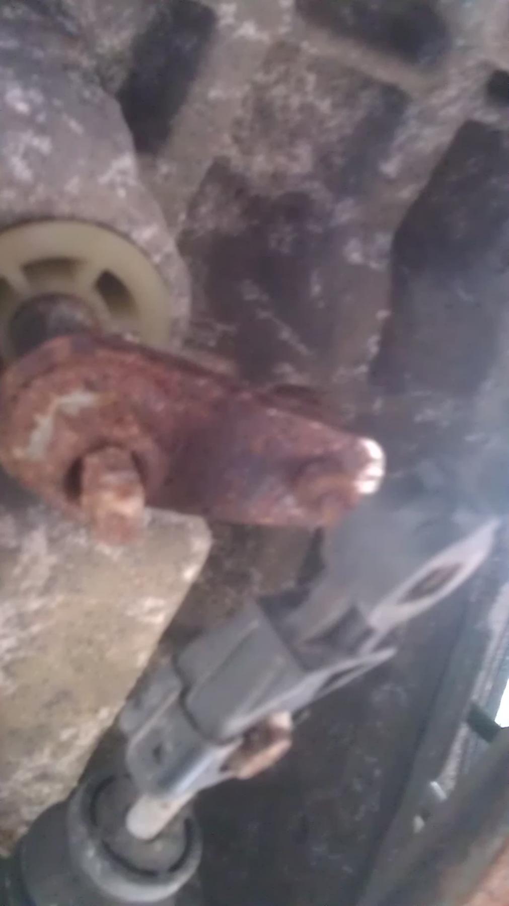

The manual lever at the transmission it self may be seized. If you take the 3 8mm bolts out holding the cover on (underneath the trans) you can pop the cable off the manual lever and see if the shifter moves freely. If so you will need to spray penetrating oil into the manual lever bushing and try and work it back and forth. There isn't a really good "fix" for this unfortunately

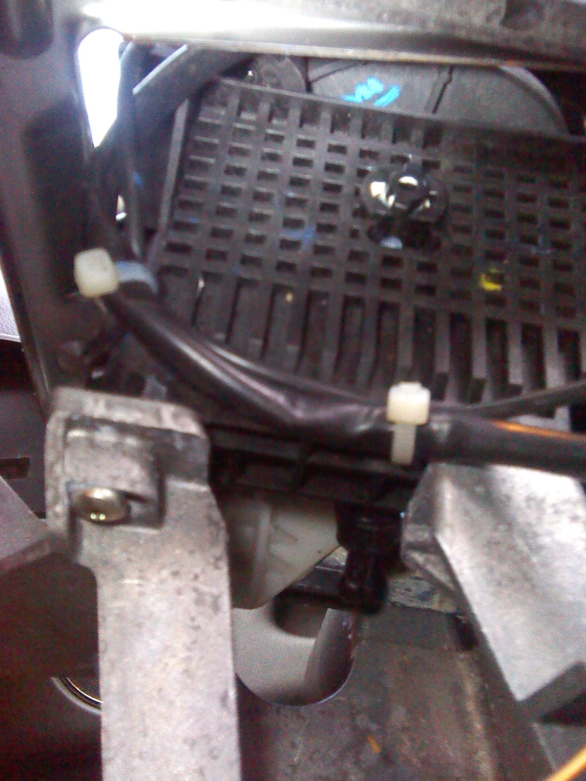

This broke, on the jgate, i replaced it , with new parts and still have the original Jgate, in thier ...
here are pics of the jgate i purchased on ebay, and the broken parts from the original , .... it was broken when it was towed, someone tried to force, the shifgter into gear, it was working and running before it , went to the body shop and could imagine that a shop / body guy, may of finished breaking the plastic, to get the key out....... hence hte broken piece of plastic...........

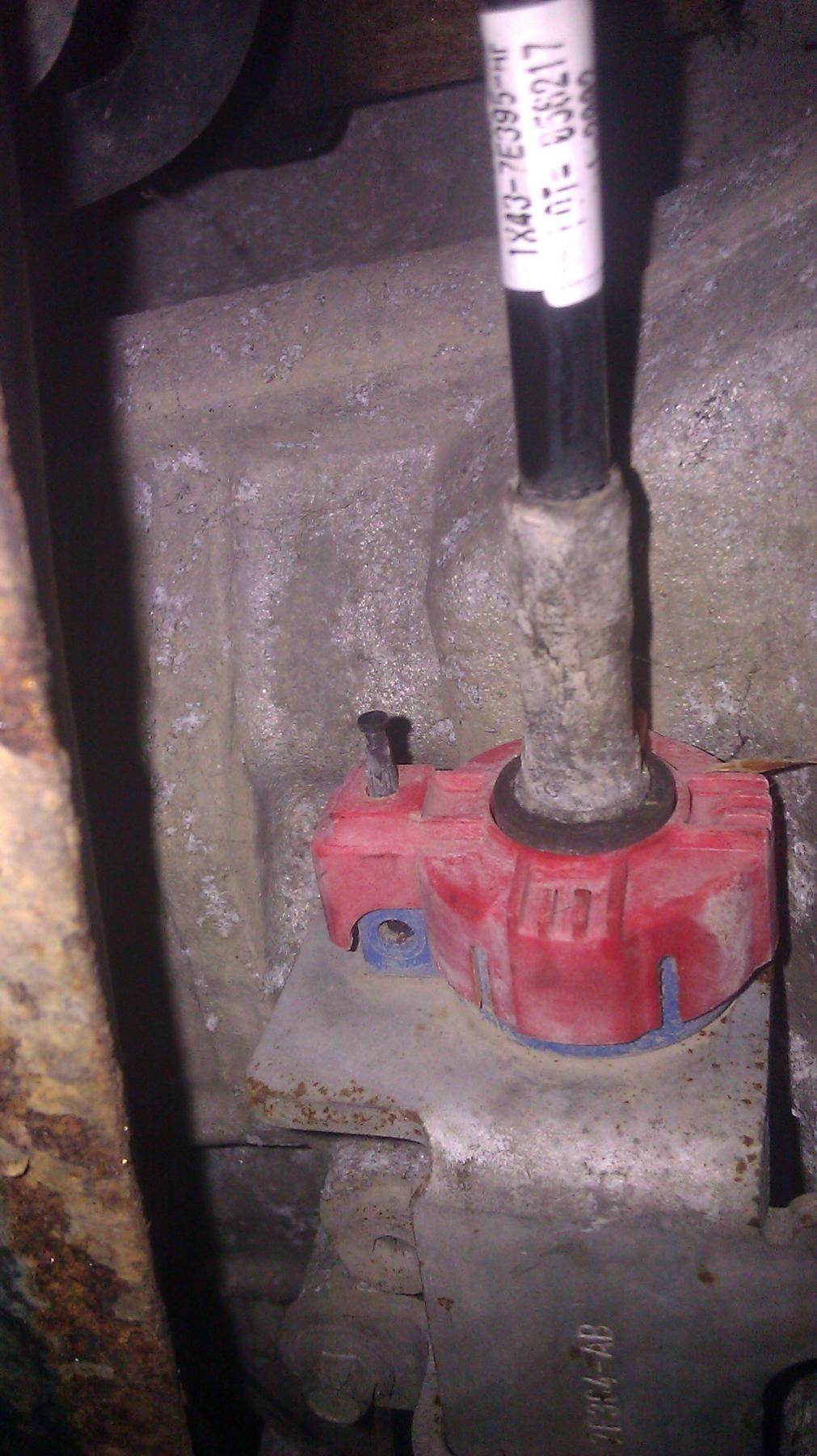

ok, removed the 3 bolts, and cable, the shifter under the transmission does not move,
but when i hit the brake the Jgate works.
well, does this mean my transmission is siezed, Please advise, on this

well after a bath with wd40, a halftime for the bears, i used a sledge hammer since the car has been sitting was able to make it move, and moved the arm forward gingerly with the head of the hammer,,, Now i have to charge the battery, but i am getting a clicking, now, ........ hmmmmmm
