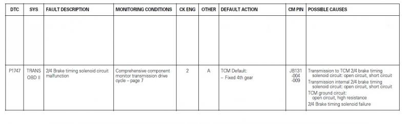

I can't help with the complexity of the fix here but can give you the possible causes for code P1747 from the Jaguar DTC listing:
The 'one gear' you have fits in with the Default Action shown when the code is logged.
With this information, other members may be able to advise on testing and repair procedures for the 2/4 Brake Timing Solenoid.
