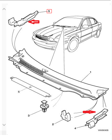

Location where cabin filter resides beneath w/screen wipers. You may find the gaskets either side, which were originally made of foam (as arrowed), have broken down, allow water ingress. Replace with latest rubber type.
