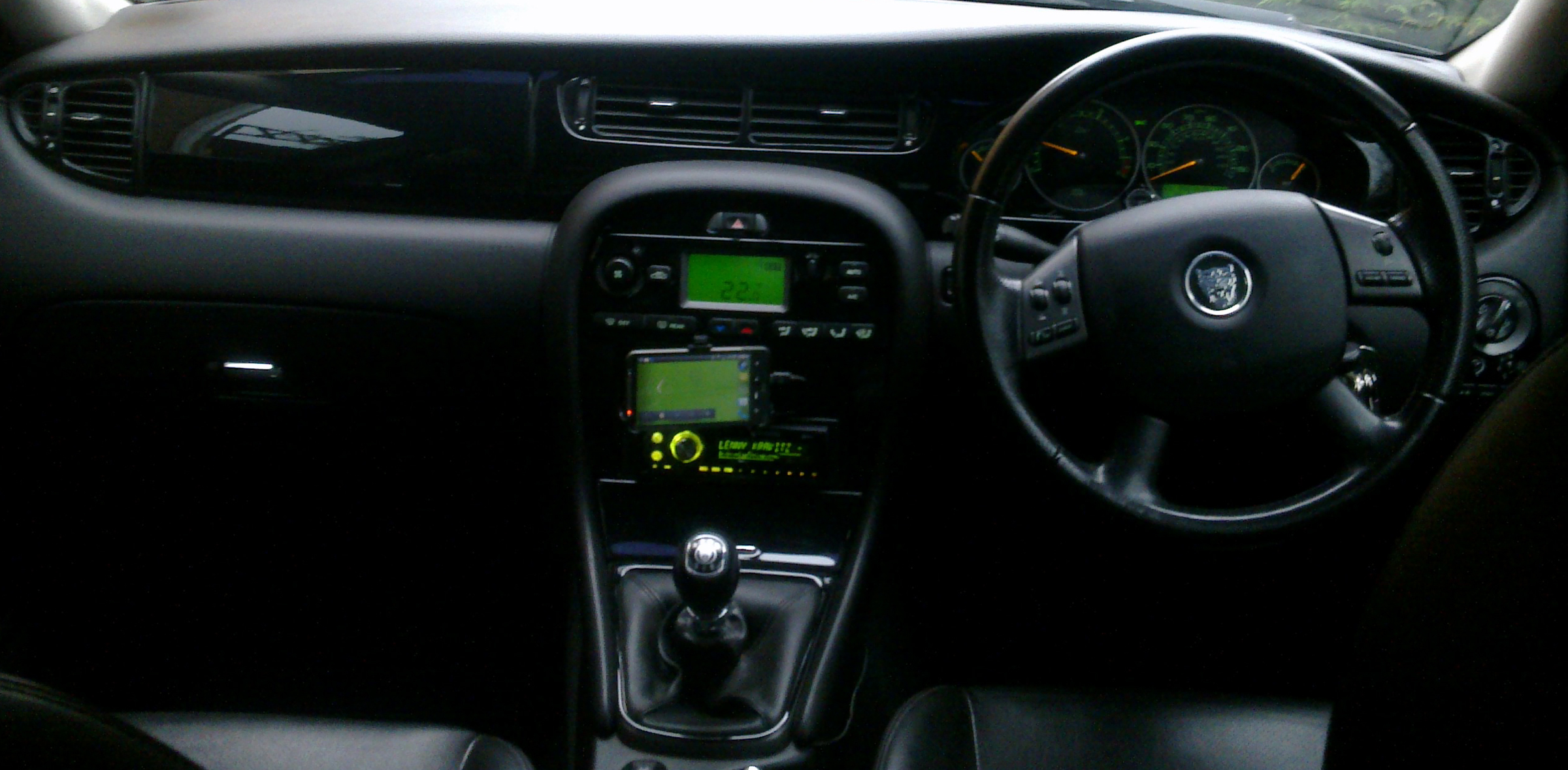

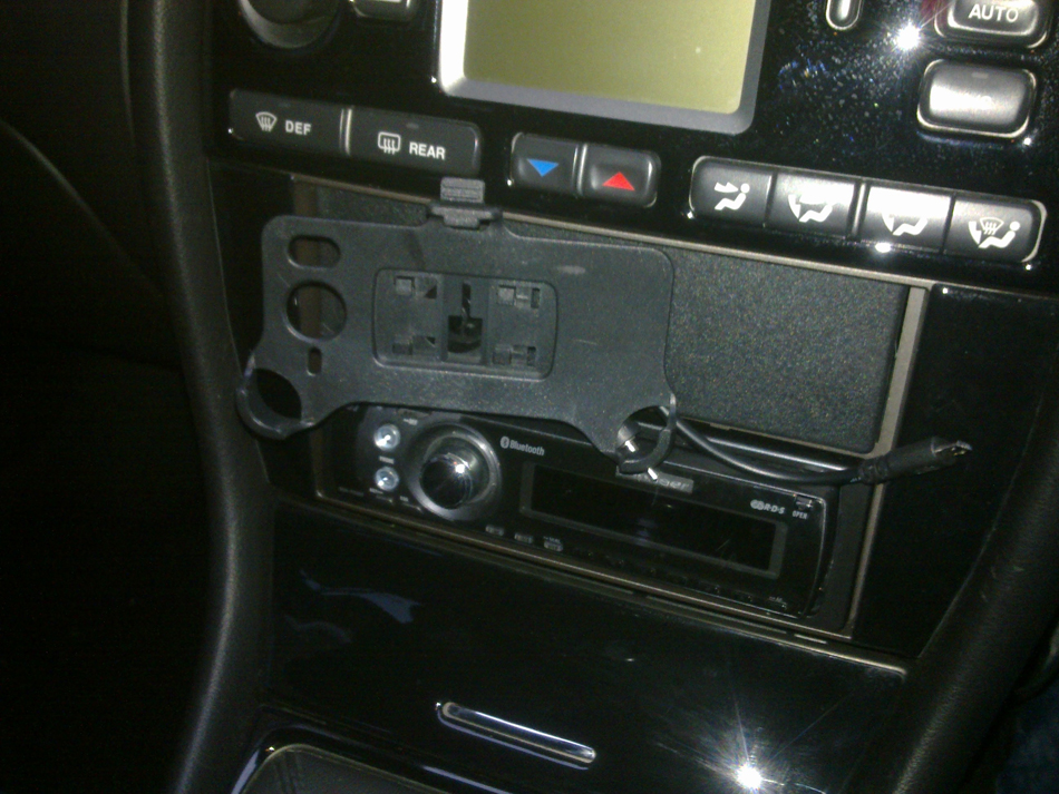

Hiya,
I've fitted an aftermarket stereo. You may find my post in this thread useful. Which has the Official Jaguar OEM pdf's you'll need to complete the installation.
https://www.jaguarforums.com/forum/x...amp-sub-69415/
Since then I've also added a micro usb power source and a dinn blanking plate through which I've mounted an adapted phone bracket. I've also added a bmi type dash kit. For the dash trim kit on the side of the stereo housing, I had them custom made for an extra $10.
see pics below.
And also here.
https://www.jaguarforums.com/forum/x...nterior-90723/
I was tempted to get a touch screen sat nav and an audio connectivity module and a parrot blue tooth, but even with this stuff you still end up with less functionality than having your android phone / iphone to hand. Also the Jag OEM stuff costs over $1000 to buy and fit.
Some members have installed an in car pc instead which would be my preference if I had the budget, but even then you need a mobile broadband dongle so it's not ideal. Overall in my opinion my personal set up has more functionality even though it isn't as pretty.
