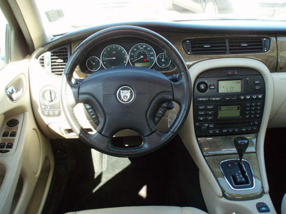

I have a 2002 Jaguar X Type and it is dual screens, one for controlling the A/C and one for the stereo. To my knowledge, a separate edition of the same year and model came with a single screen that served both A/C and stereo (and probably Navigation?). I was wondering if it is possible for me to get that screen somewhere and install it in my car in place of the usual two screens. It would look nicer, be somewhat more convenience and looks like would be necessary since the LCD screen for the A/C has started to act shady and I think will burn out soon. It seems pretty possible but seeing how the A/C and the stereo would require to separate hook-ups in the back, I just don't know whether the single screen would have one or two hookups.
Basically I wanna go from :
To :
Any thoughts on whether this is doable? Thanks all

jay, unfortunately, it is not a simple "unplug on, plug in the other and you are done" to make the modification that you are after. At a minimum you need to add in a few new sensors (ambient temp, solar temp, and in car temp) along with modifying the plugs on the back of the radio to a different pin configuration (your setup has 3 plugs, the one you are looking at has 2 plugs).
Can it be done, by all means. But, how much are you willing to spend to make this conversion?
