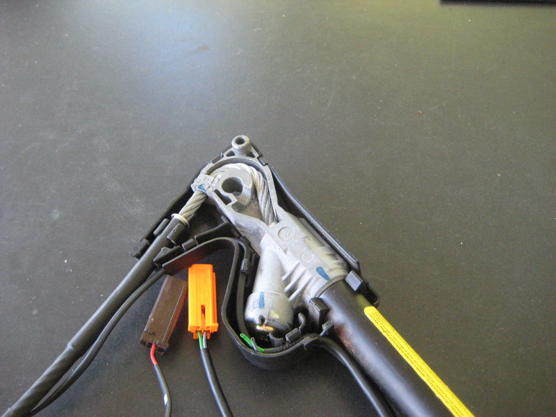

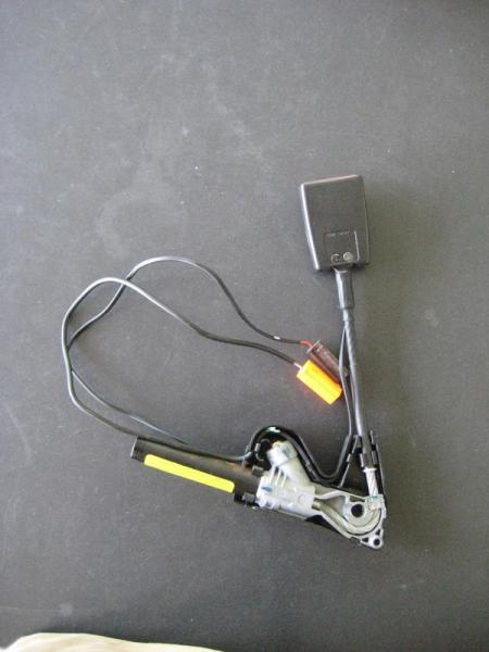

4927 is overall - side facing seat
4937 is closer detail showing stubs of wires broken off the "dome."
4939 close up broken connection pair are connected to yellow connector. You can see the ends of the wires and the two dots - the place of former connection.
I assume the "dome" is the trigger for activating the pretensioner. I think I could re-solder the wires, but FEAR this might set the trigger off if it is heat sensitive. I need EXPERT advice/warning here. I will NOT proceed without some kind of assurance.
Thanks

Originally Posted by stephen11962
Photos!
Thanks
Graham asked me to weigh in on this.
In short, my recomendation would be to get a salvage unit as a replacement.
I think there is definitely hazard to repairing this. A strong, reliable solder joint needs mechanical integrity, which mean carefully grinding away some of the plastic dome to get access to sufficient wire for solder contact area or better yet physically looping the wires prior to soldering. You would then solder and refill the lost plastic with epoxy. Just soldering to the wire ends will not last long. Since this is potentially a life saving device, reliablility should be a concern.
Between the grinding and the heat, it is a pretty hazardous job on an explosive device.
You could use a conductive epoxy such as Circuit Works CW2400: Conductive Epoxy Kit instead of soldering, but it costs as much as a salvage unit would and you would still need to grind material away to get a good solid contact area.

Well, it's been an exciting ride. I am not trying to fix this animal.
Am off to the dealer @ $260.00. Cannot find salvage parts around where I live. That and the uncertainties with the color and actual model (recyclers do not seem to catalog by VIN) leave no choice.
I want to thank all, especially Graham, for the assistance.
Stephen
