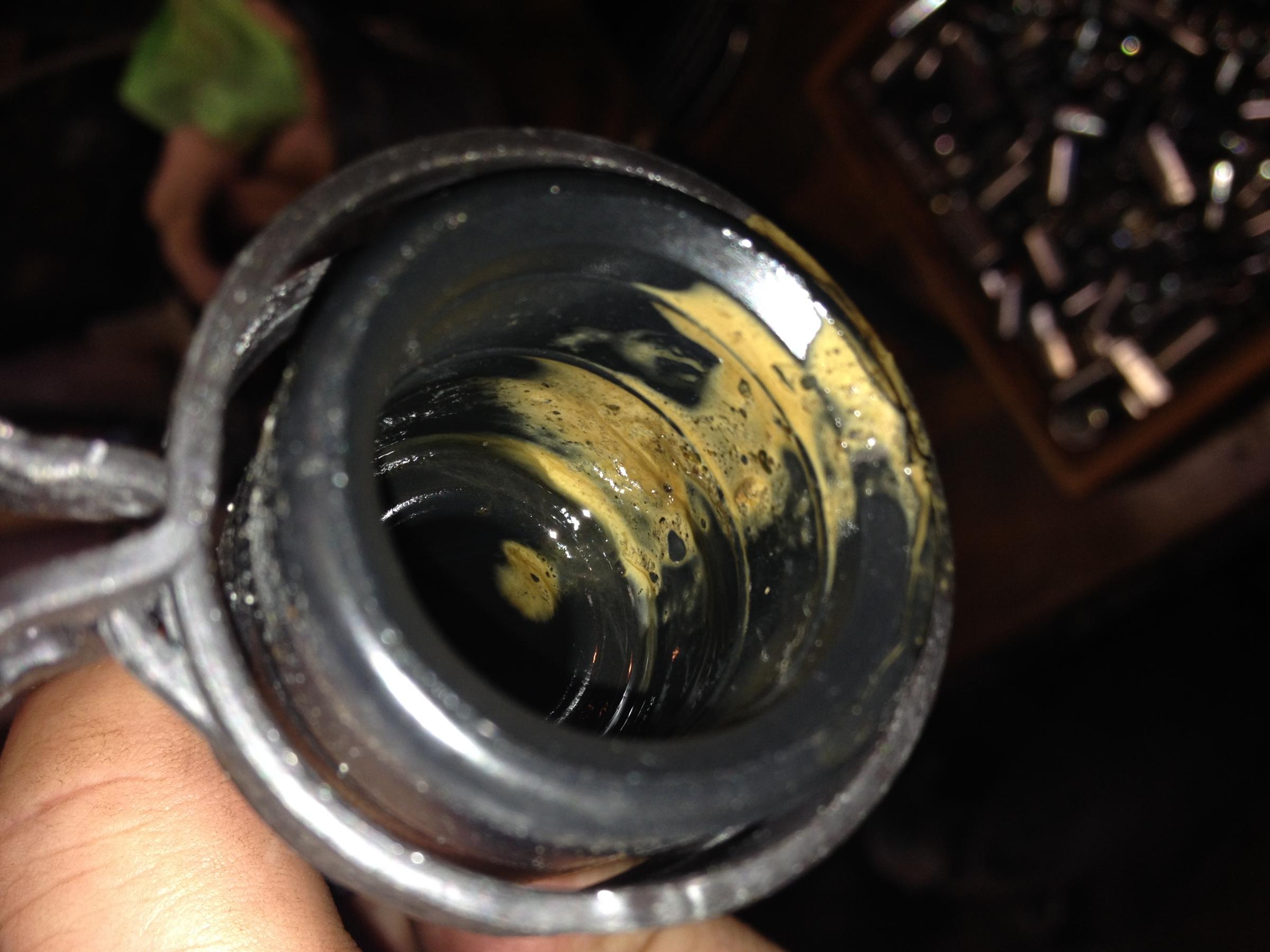

But, pull the big vacuum hose (the one that always collapses). Crap. White milky oil. Thick. stick my finger in there, pure white. (forgot to take a picture). Here's one of the inside of the hose.

Doogie, do not worry about the color of oil inside the big vacuum line. The purpose of that line is to pull any moisture that may get into the oil pan out and also to collect any oil vapor. As long as the oil on the dipstick is still a normal color, all is good. The oil in the vacuum line can become milky if you are in a humid area and are not getting a lot of oil passing through the PCV valve.
As for smelling gas in the overflow bottle, the best advice that I can tell you there is with the engine cold, remove the cap and then start up the car and let it come up to temp. Watch the inside of the bottle and see if you are getting gas bubbles out it then. The true teller will be doing a compression check of the cylinders. If you have a bad head gasket, you will have 1 or 2 cylinders that will be significantly lower than the rest. That may be something you want to add to your list when you do the plugs since doing the compression check will only add about 30 minutes (if that) to the job. Then you will have a firm answer as to what the status of the motor is. The numbers that you are looking for is under ideal conditions, all the cylinders will be up around 150-165 psi. But, the bigger thing to keep in mind is that all the cylinders are reading about the same (within 10% is a normal number, or within about 15 psi of the highest and lowest cylinders). If on your engine you are right there at 15 psi difference or even a little outside of that, I would call it good and you don't have an issue. If you have a bad head gasket, you are going to see like a 50+ psi difference.

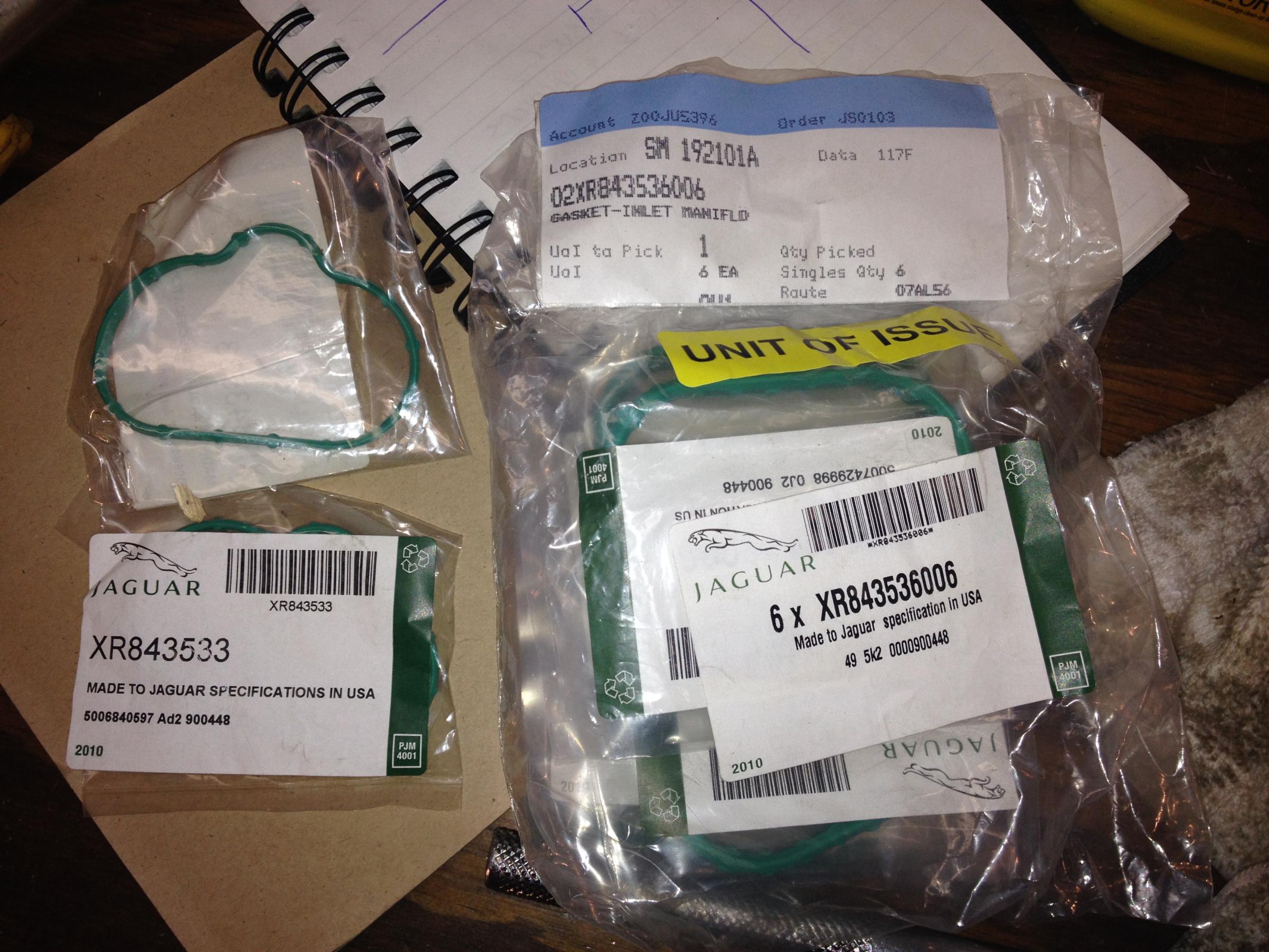

OOps. Which gasket is upper and which is lower? I have the six gaskets for upper and lower, they are different part numbers and set is thinner than the other. Anybody happen to know which is which? ...feeling like an idiot... Doogie
I "Think" the upper is XR843536006. These are the thicker of the two..
tia,
Doogie

The oval ones are for the top and the weird shaped ones are for the bottom. I just changed all my gaskets and plugs myself a couple days ago and now my Jag is running alot better. I was having problems with it starting up in the cold morning and now it starts up perfectly in any weather.
I found that an air leak causes alot of problems, so if you have one, get it fixed asap. I was also getting the p0174 and p0171 codes and after my new gaskets were put in, it cleared those codes.
Its also good to change your oil, oil filter, air filter, and fuel filter when you change your gaskets. I have never done this type of work myself to a car, but it wasn't very hard and it saved me a ton of money compared to taking it to a shop.

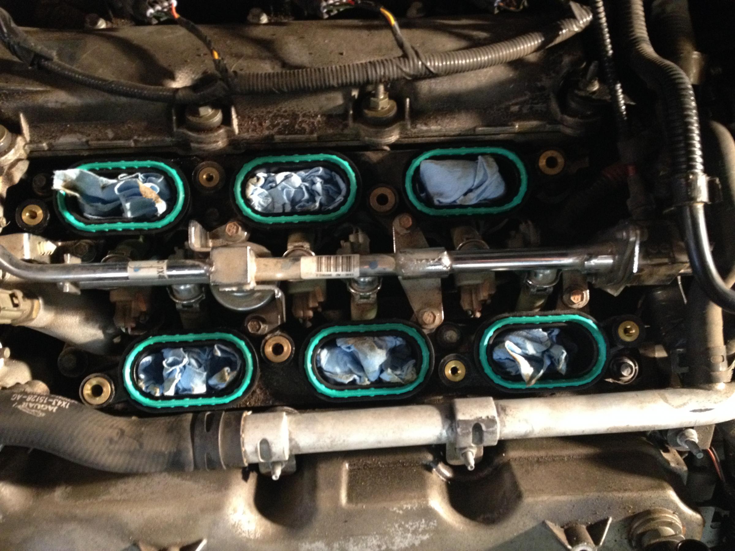

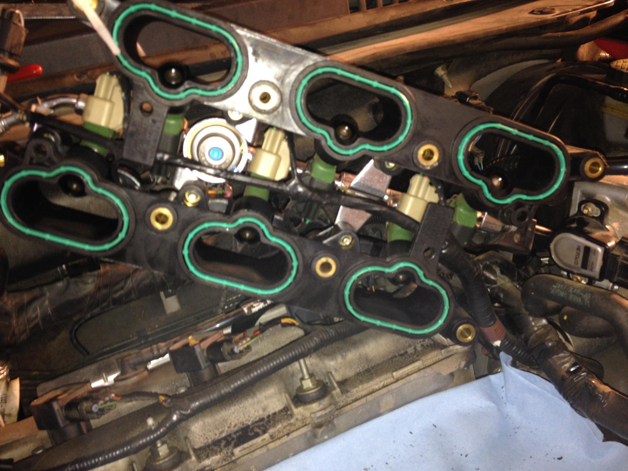

I got everything done easily. Took my time, cleaned everything well, and went step by step thanks to the postings on this subject on the forums.
The car started right up, and the brake boost was evident immediately! Took the kitty out for a spin and the CAT IS BACK! WOO-HOO! I had hard starts, hesitation, sputtering, CEL, "Cruise Control not available, etc" in the cold.
This thing feels great now! I still have an oil leak that I suspect is the oil pan, but I have a friend who has a lift and I will attend to that soon. I was AMAZED at how much oil was in the intake manifold! I laid it upside down while I worked on the gaskets, and was shocked to see oil streaming for a few drips when I put it right side up.

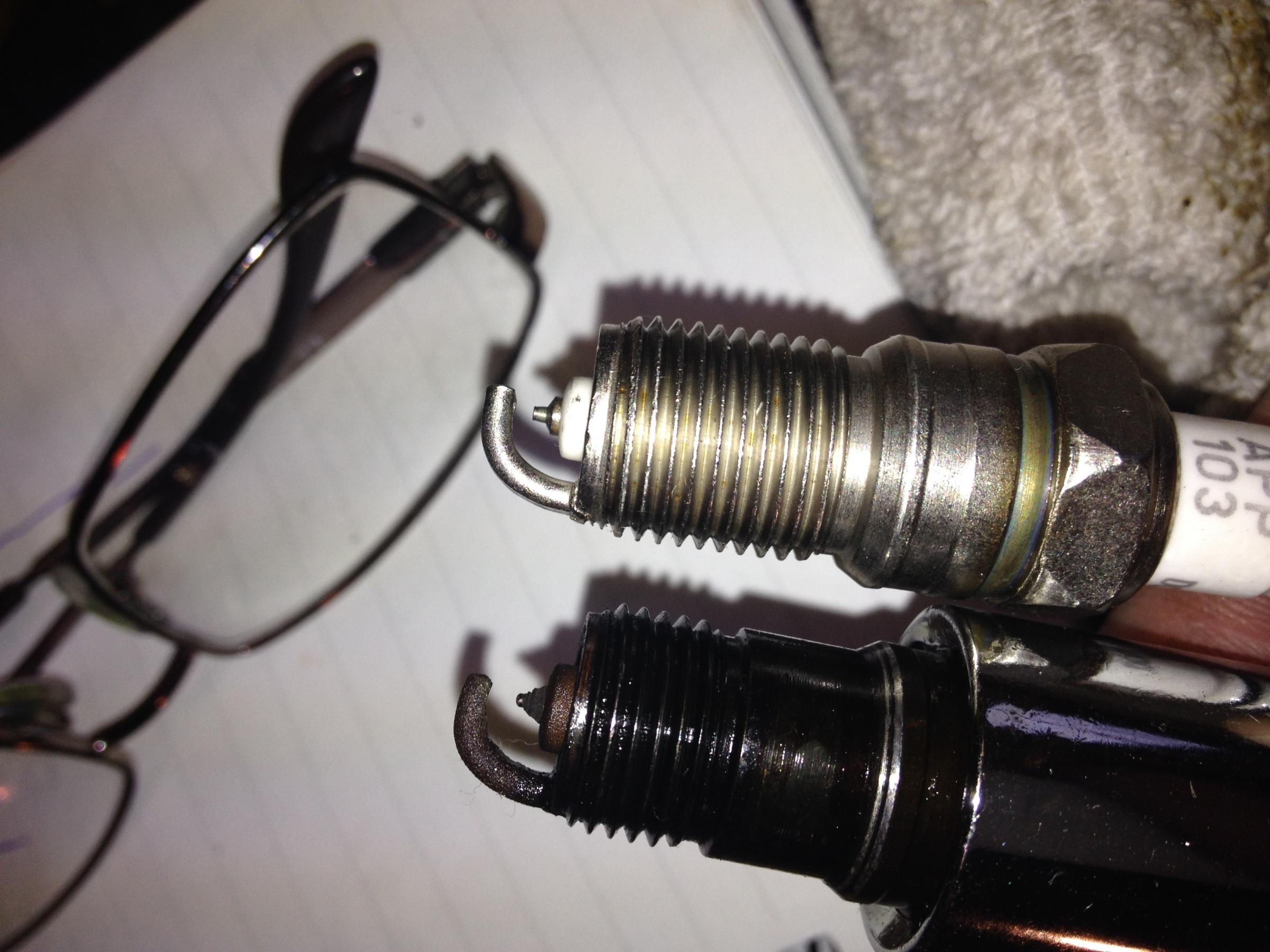

The Spark Plugs were done for sure also. (see pic). all in all, I am thrilled! Actually looking forward to tomorrow mornings cold weather (yeah , really cold, like -5 in the morning) to see how she does!
