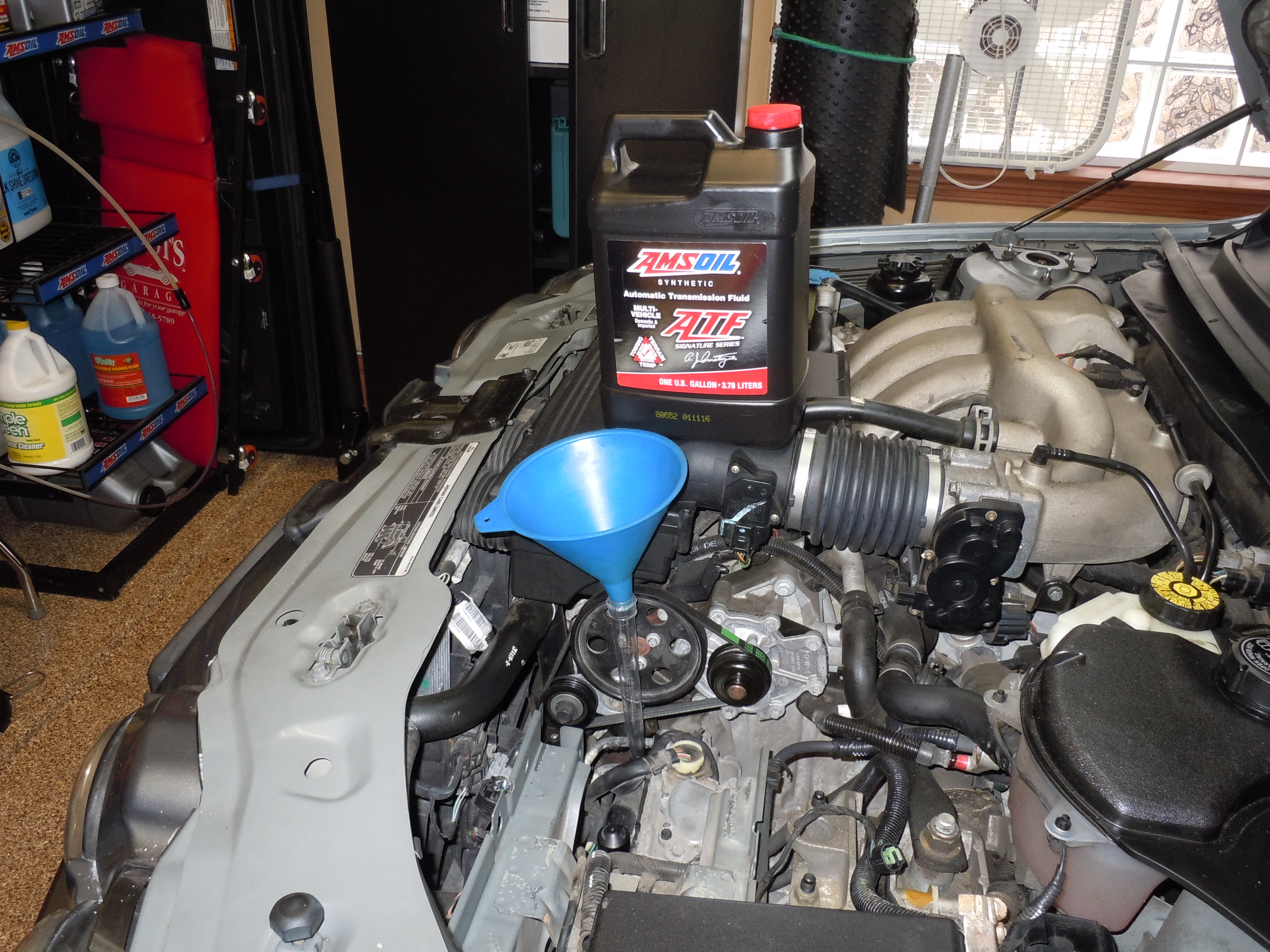

I'd say that for sure you got new ATF when the transmission was replaced. As for the transfer case and differential - probably not. You found what's called a Unicorn, so in my book changing out the fluids is a great idea. The problem with this car is that fluid changes for transfer case and differential are a b*tch because there's not a drain plug on them. The transmission fluid is fairly easy; I used the 3x drain/fill procedure you'll find on this forum and it made a big improvement. And by the way, power steering uses the same ATF; fairly easy to evacuate the reservoir and refill a few times to clean up dirty fluid and protect the PS pump.

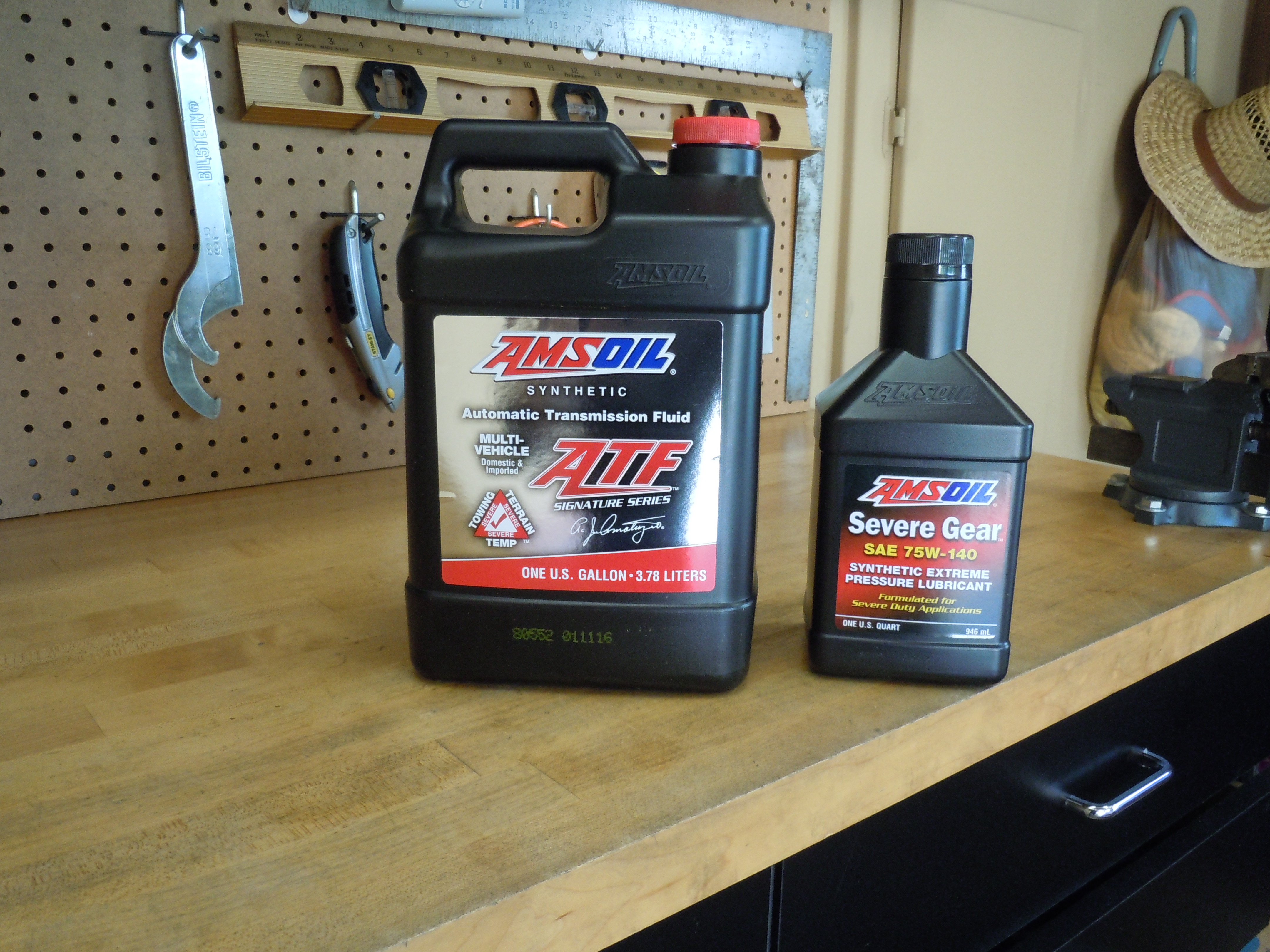

You can get a full list of fluids, filters and capacities at amsoil dot com. It's a free app, and you can also use the "MyGarage" app (also free) to "park" your rides in, log services, set up email reminders, etc.
You can PM me if you want more info on the products. I've been using nothing else for 19 years and am a dealer for them.
