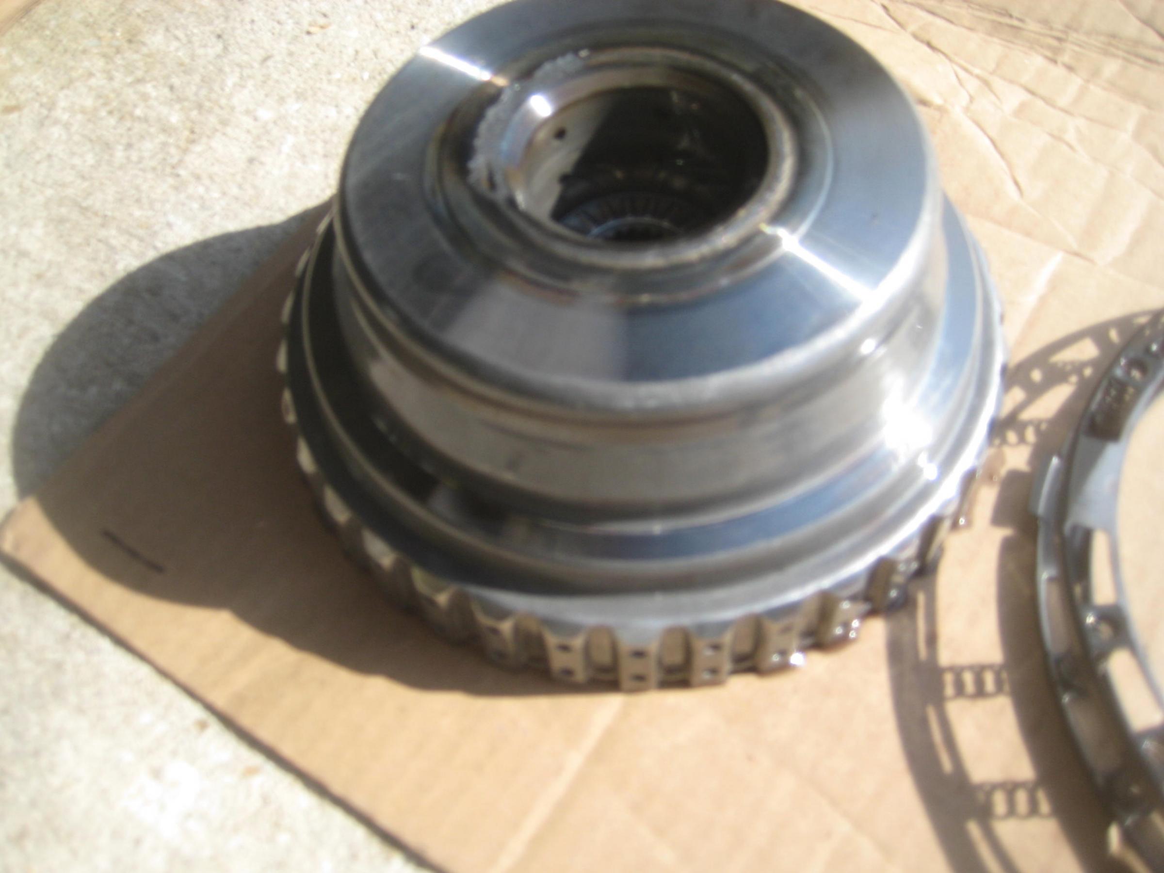

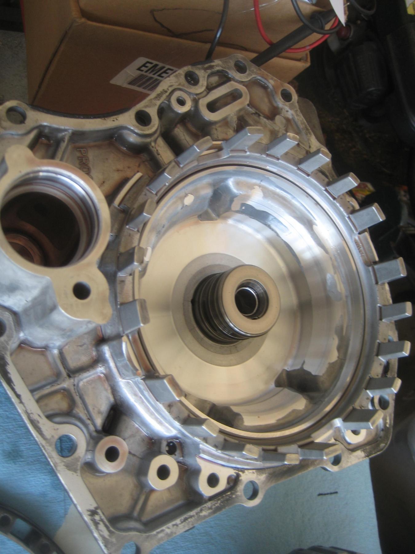

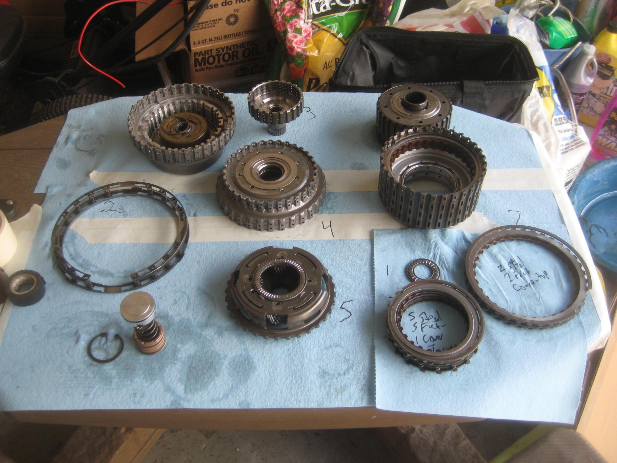

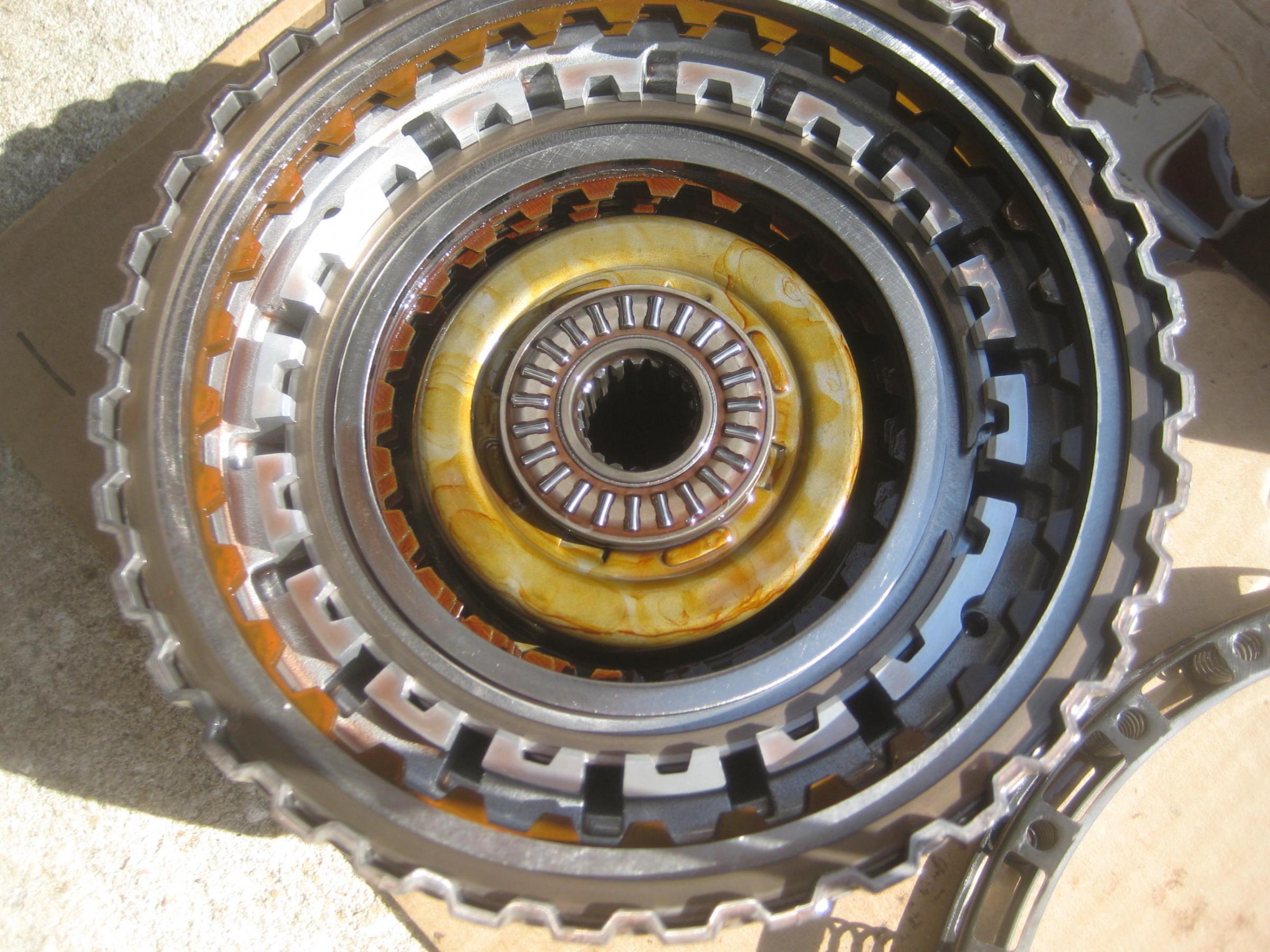

Pulled off the side cover and disassembled as much of the trans as possible with it still in the car. Found out that it was a 2004 unit with all the upgrades and was pretty clean inside with no burnt clutches. Unfortunately for me, I didn't find anything obvious but most of the o-rings and seals look to be worn out and need to be replaced. The reverse clutch/high clutch drum had some scoring on it but it almost looks like grinder marks and it doesn't appear to be on the wear surface so I don't think that's the problem. Posted a few pics to see if any of you might have some helpful tips.
Now I'm really not sure now if I want to put more money into trying to fix this one or just bite the bullet and swap it our for a working one.
Thoughts?
