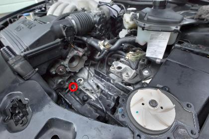

I've been looking those b/w drawings and I can't say I'm sure which one is it and is there alternatives, can you tell me are these two right plugs No1 I opened this and there's rubber seal in this, but how is it possible to put anything in through this tiny hole... No 2 I haven't opened this yet, but I'd like to, is it ok!

Anyone please... or is this picture totally outside of this question... Is one of these plugs atf refill cap?

See your picture below, I have edited your picture to add Item #3.
The refill is a rubber plug at the very front edge of the tranny, close to the large pulley drive for the water pump. It is not visible in your picture, but the arrow I added points to the vicinity of it.

Ok now I get it, I don't know why I have been looking so wrong place, but this makes sense isn't that tranny cooler over that area, in this pic it's barely seen http://gallery.photo.net/photo/11290932-lg.jpg

I think you've got it now.
Circled in red in your pic just to confirm for you.

Ok, quite tight place, so it's almost mandatory to take battery box away before there's enough room to do anything, thanks to you golden one.
