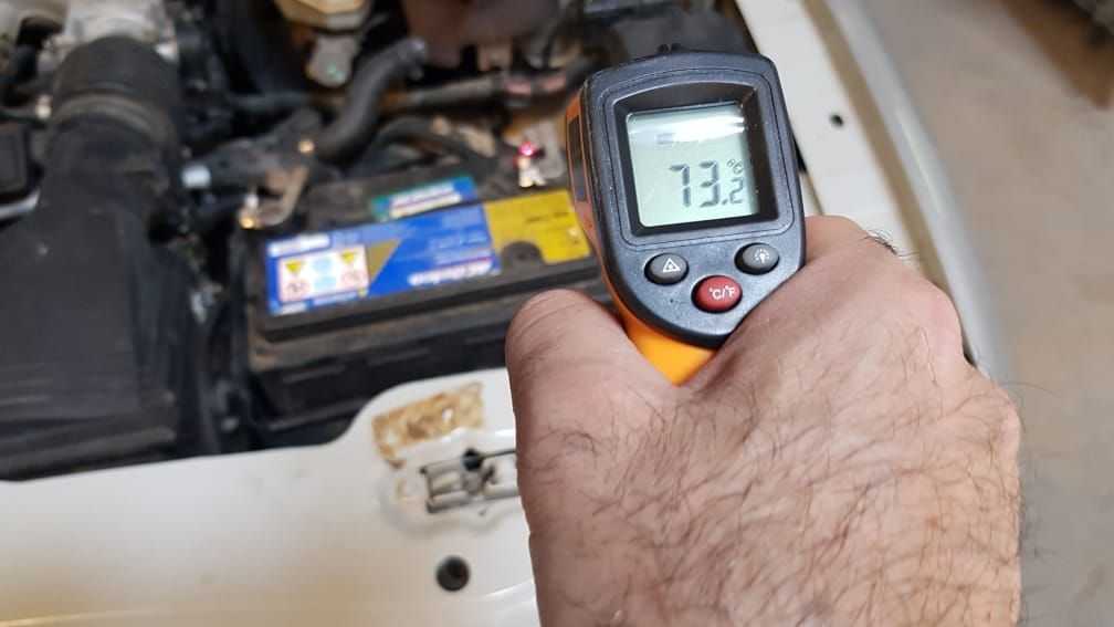

hello all.
I have read through the forum and every time the battery warning light comes on, the experienced ones will suggest checking the battery terminals heat,
I did have the light come on yesterday, i know i am using a lot of power since my fans a connected always at high speed, and my AC is on, so at night, when i turn my headlights on, the battery warning light comes on, and when i parked the car, after a 30 KM drive, here is my temp. reading on the terminals, hoping this will narrow down my options
negative, Car still running, Coolant temp. 95C No Battery warning light
Positive, Car still running, Coolant temp. 95C No Battery warning light
battery terminals temperature
Thanks

Drive the car till gets good and hot and light comes on thats when you check it. Youll find that usually the positive is to hot to touch and you need to replace the cables. See lots of xtype come in still for battery lights with new alternators from indy shops that dont know the cars. So whos more expensive? Just had another 2 weeks ago.
You can monitor the battery voltage throughtthe i pack while driving and see.more than a .2volt drop is too much resistance which just goes up with heat generating more heat and more resistance.

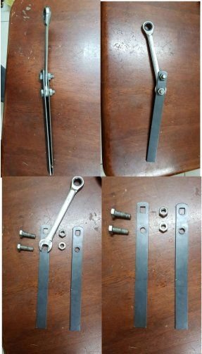

Could not wait until tomorrow, so i made the extension.
I will not try to replace the cable though, i have to lift the car up again.... i will test it today and see how it goes.
Here are the pics.
this will work only with automatic wrenches, pictures attached.
