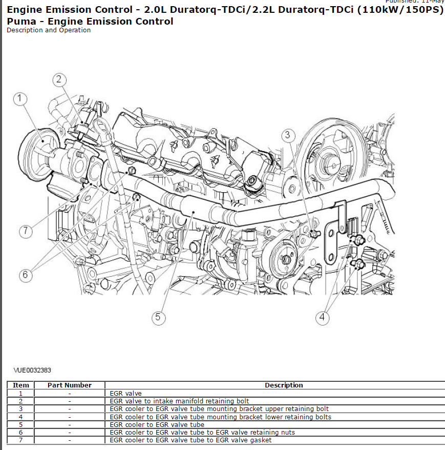

This picture might help.
It's page 1216 of the workshop manual. The link to download a pdf is at the bottom of the "How To / Quick Links" page:
https://www.jaguarforums.com/forum/x...essories-5915/

many thanks DWCLAPP I will have a look in the morning for any splits and check the clips , cheers for the picture and link, this is very helpful��

You're welcome, but Rapala deserves the credit - he diagnosed the disconnected hose. I simply provided the picture. Glad to help keep our X-Types rolling.
