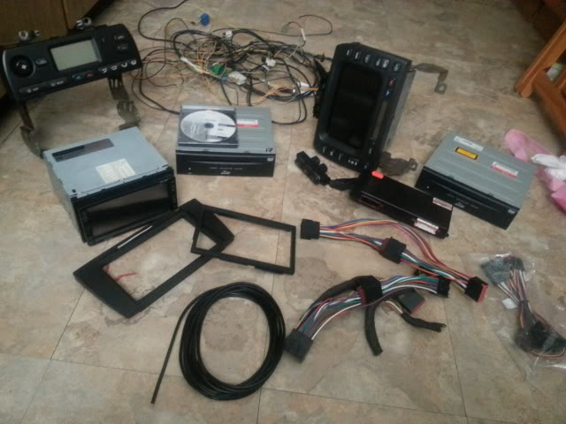

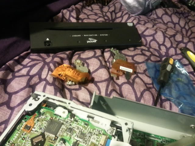

well i have had a few friends with x-types and had the same problem, how i fixed it was have them order a used dvd rom reader i installed it problem solved,
for one friend i adjusted the reader screw in side of the reader the worked also
