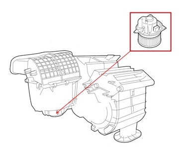

Forgive me if this is already explained somewhere. I did searches, but can't seem to find anything on a X-Type. I have a 3.0 that I've been told needs a new blower motor. Does anyone have an idea where this part is and what the difficulty level of this job would be. I can probable handle a 6 or 7 on a scale of 10.

Originally Posted by chiefshb
................. Does anyone have an idea where this part is and what the difficulty level of this job would be. I can probable handle a 6 or 7 on a scale of 10.............
You should recognise the Blower Motor location in relation to the vents in this drawing:
The removal and replacement instructions in JTIS are some of the briefest I've seen:
1. remove the Blower Motor lower cover
2. disconnect the electrical connector
3. remove the Blower Motor retaining screws
Of course, this doesn't guarantee you don't need to be a contortionist to get to it!
