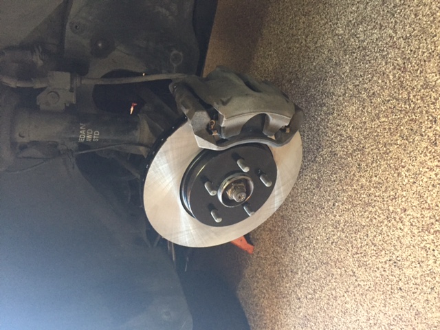

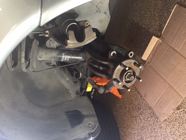

Used CRC Brake and Caliper Grease. Bought rotors and Akebono ceramic pads from RockAuto. There's good YouTube videos put up by English company called Autodoc. Brakes went together nicely; now just waiting on a replacement rear shock bolt to get car off blocks and back in service. Sorry for wrong picture orientation - took with my phone and don't know how to reorient them.
Attached Thumbnails Brake guide pins-fronts.jpg   Brake guide pins-fronts1.jpg
