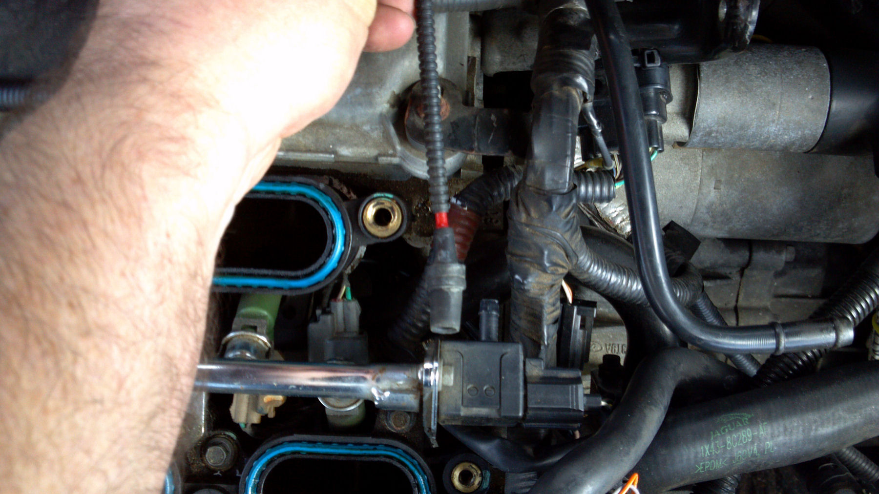

I attempted to do my first tune p on my 2005 jag x type....when taking off the manifold I broke a vacuum line attached to the back of the manifold and seems to connect to an ac line, its a line that is chrome and above the engine block. it is a hard plastic line that is red in color. Im not sure what it is to be able to replace it. Also I snapped the nipple that connect a line to the coolant res...I imagine that I have to replace the whole unit, unless anyone has any ideas... When bolting the manifold down two of the bolts on the front left, that are short bolts were screwed in but they don't seem to tighten. even thought they are down all the way I can still freely turn them, I also cant make them come out. Because of this Im not sure if the manifold is tightly secured. What should I spray around the manifold to see if there is a leak? How do I get those bolts to come out if there is a leak?....Any and all help would be appreciated. Thank you.

I'm not sure which vacuum line you broke. A pic would help.
Also not sure what bolts you're having trouble with. I think what you are talking about is the brass fittings in the black plastic intermediate manifold are spinning and you cannot tighten the aluminum plenum on the top of the engine. Is that it? If so, I had that happen on a Ford F-150 with the Triton engine and it is a similar connection system. On that one I had to remove the plenum and it was not easy with the brass nut spinning in the black plastic. If I remember correctly I had to grind off the top of the fastener to get the plenum off. Then I reset the spinning nut with some JB Weld. That's was a one time deal. I have no idea if I will ever get it out again.

My buddy says it looks like a pressure regulator vacuum line its attached to the fuel rail, is there any other name for this vacuum? Thank you kindly for your help.

Is this the Vacuum line?

YES THATS THE ONE...I was able to by new vacuum line and install it...Thanks a million.
