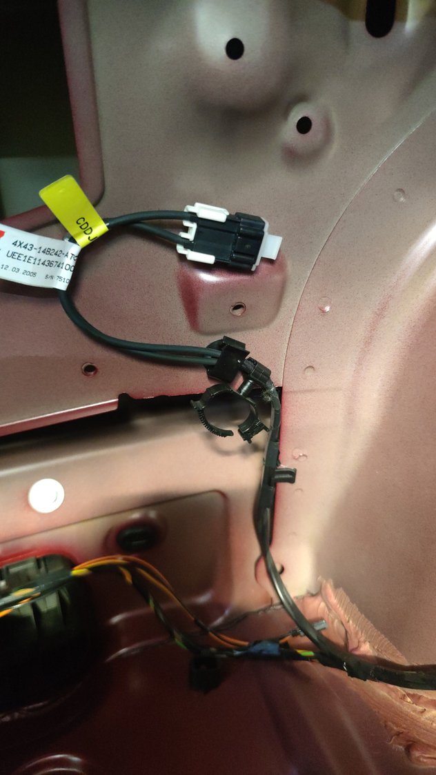

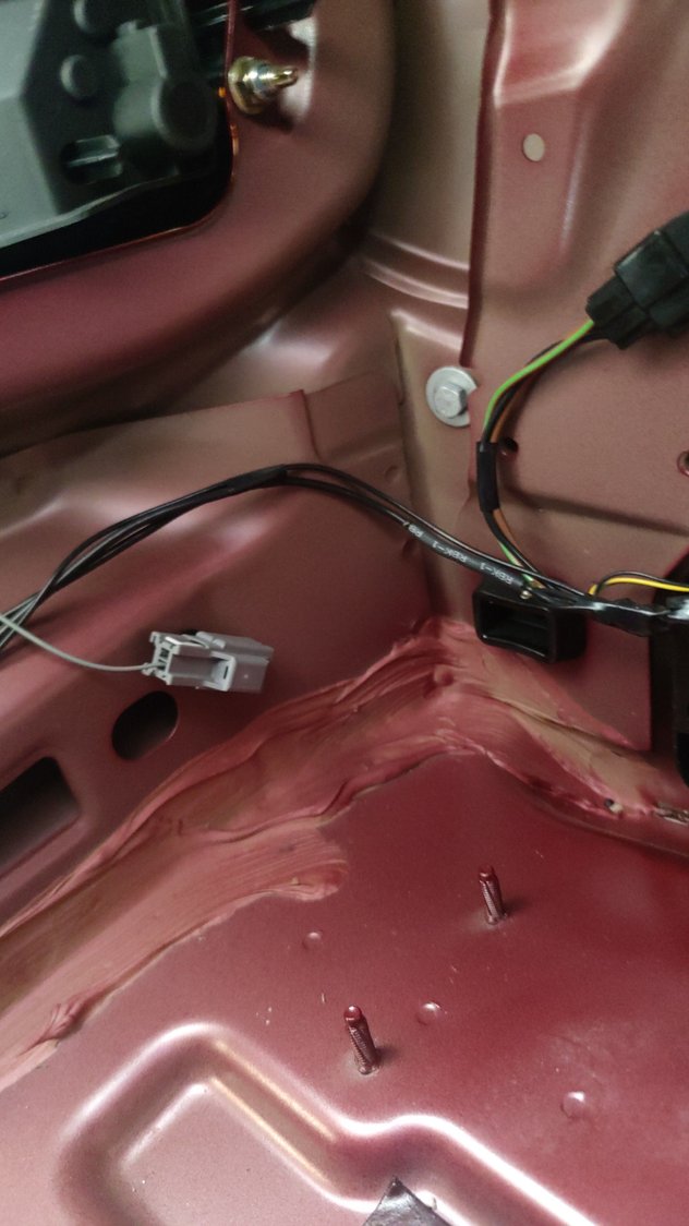

I'm gathering information in order to retrofit the BT to my X-Type 3.0 Sport 2005MY to gain the hand free phone capability from my smartphone.
It hasn't SAT NAV console, but the two displays model.
Today I have removed the rear cushions and the left boot trim and took few pics to the connectors:
Under the rear seats
Is my X-Type pre wired ?
Is my shopping list correct? :
  • Phone Module 2W93-19K350-
  • External Microphone
  • D2B Fibre Optic link lead
  • Metal bracket for the phone module
  • Modified left boot trim
Is the BTUM under the centre console necessary?
Have I to source a modified harness to link the phone module in the boot to the connectors under the rear seat?
I'm very grateful to anyone would help me with suggestions and inputs 😊
