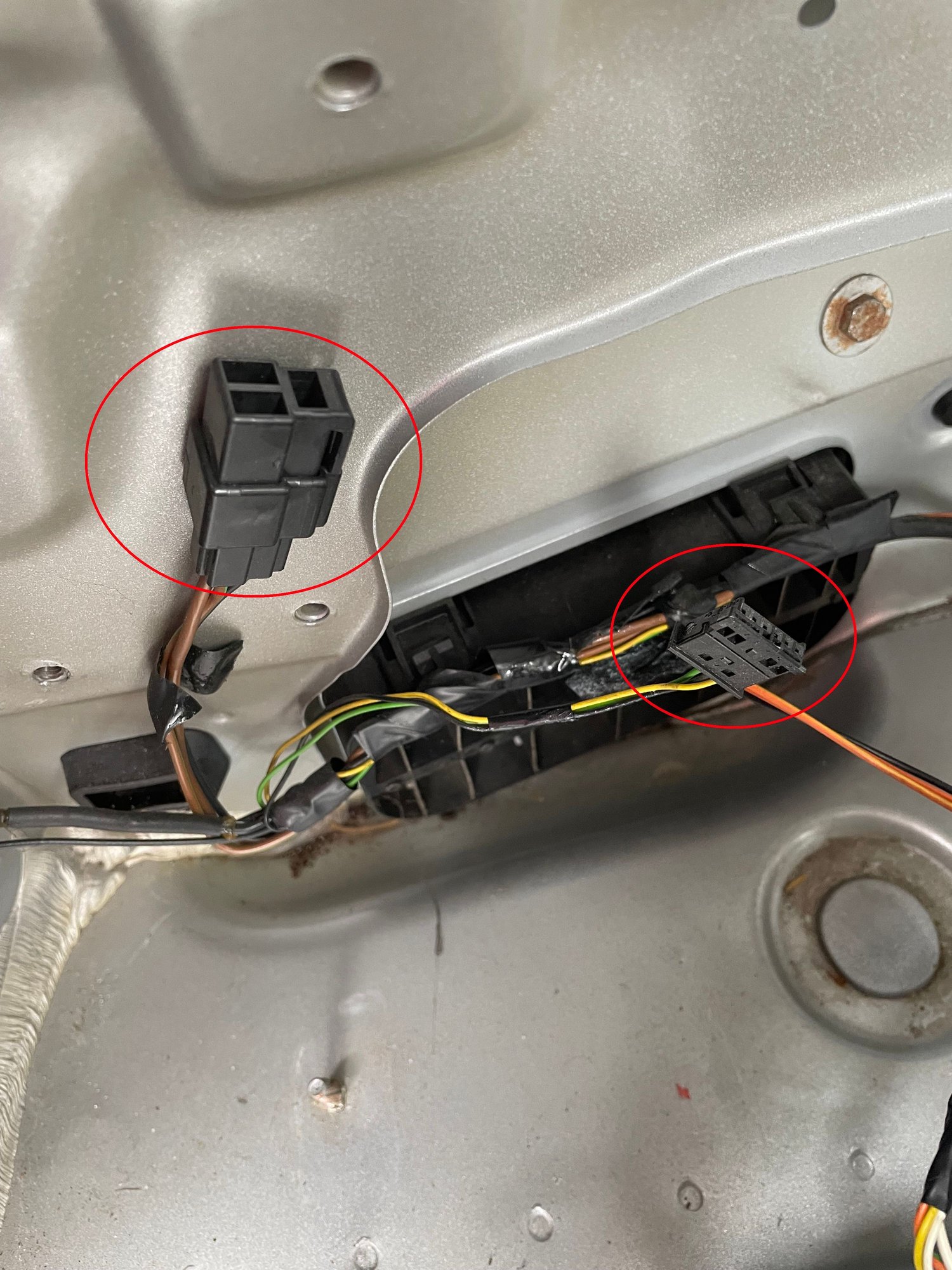

I have a 2006 x-type and bought additional bluetooth phone and voice modules for it. the bluetooth phone module was an easy fit, but I cant find the cable for the voice module, all the threads i've seen indicate that if the cable for bluetooth phone is there then the voice should be as well. i've taken the back seat out but cant see any cables there, but I did find the cables below behind the cd autochanger, and satnav units. Nnot that they appear to be the same size for the voice module. does anybody know what they are for? the small cable (wires black, yellow and green) appear to run to the front of the car.

its the small cable (Lead two connector) that puzzles me as it does not seem to fit the Voice Module. I cant seem to find it on any diagrams either.

found it (I think) - its a cable for the inclination sensor?
