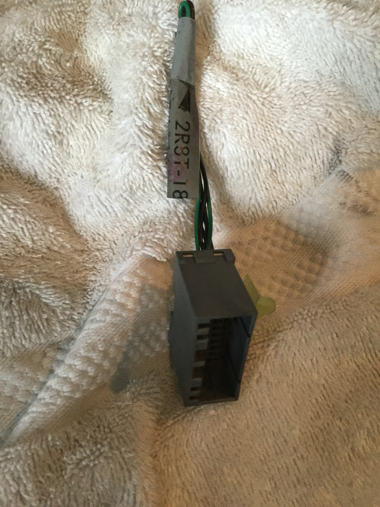

Old Apr 2, 2016 | 02:12 PM
magmedia's Avatar
Joined: Mar 2009
Posts: 901
Likes: 258
From: Eastern, MD
Originally Posted by guppy710
Thanks!!!
I guess I will need to find this part.....
Part looks like this...
Thanks
Mag
Attached Thumbnails bluetooth mic issue-photo254.jpg   bluetooth mic issue-photo389.jpg
