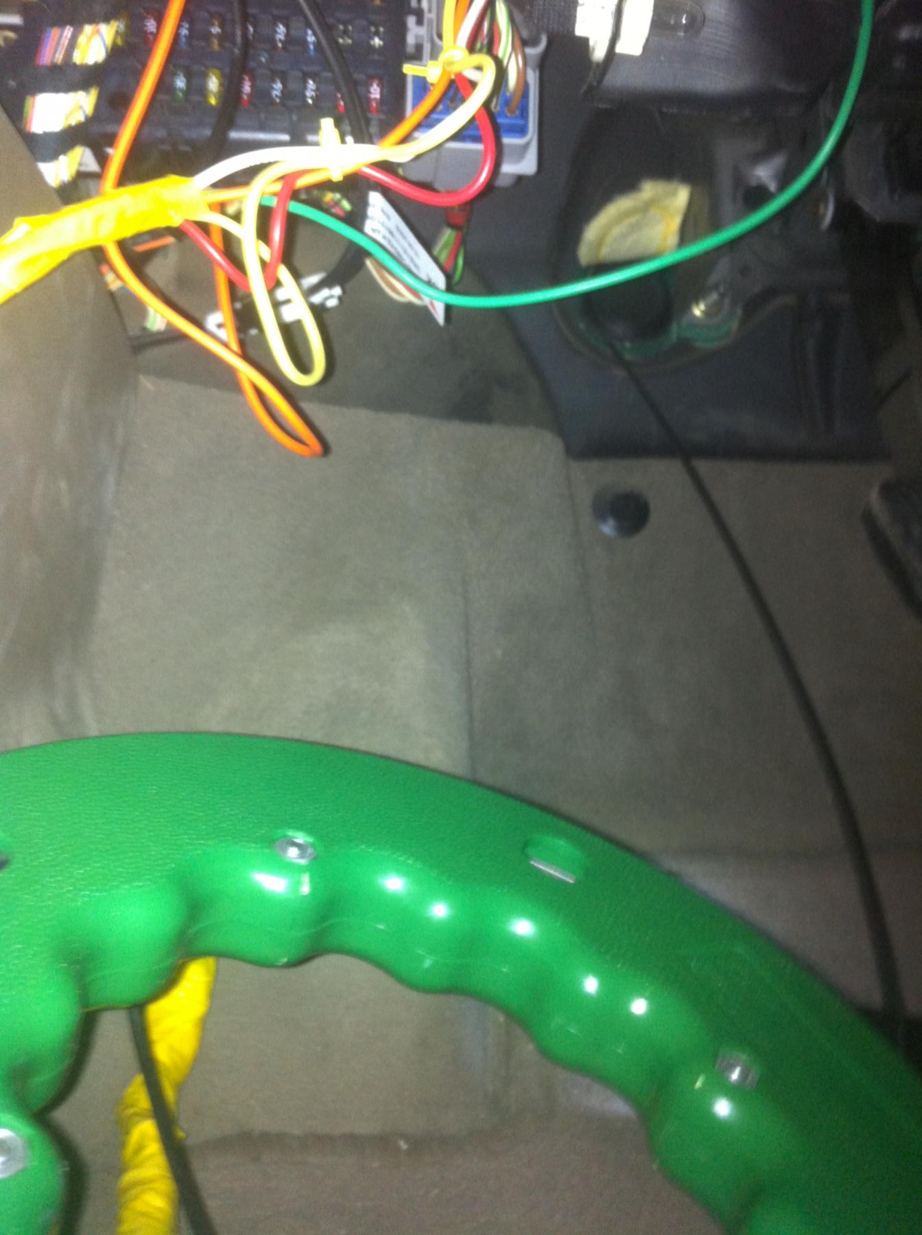

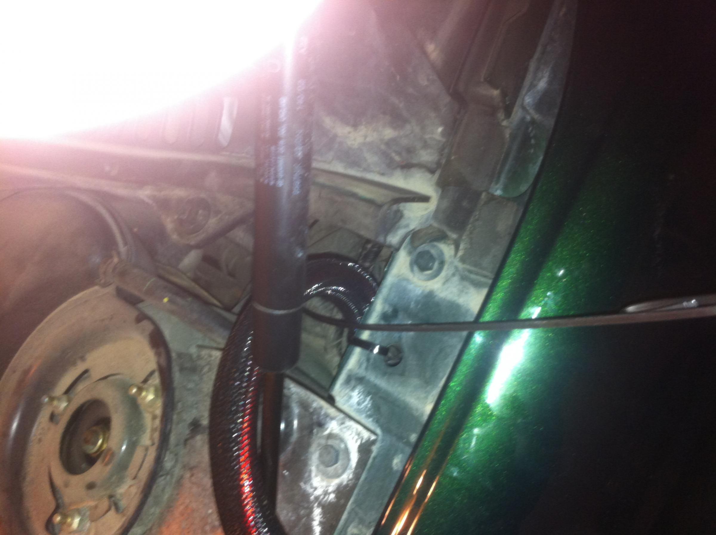

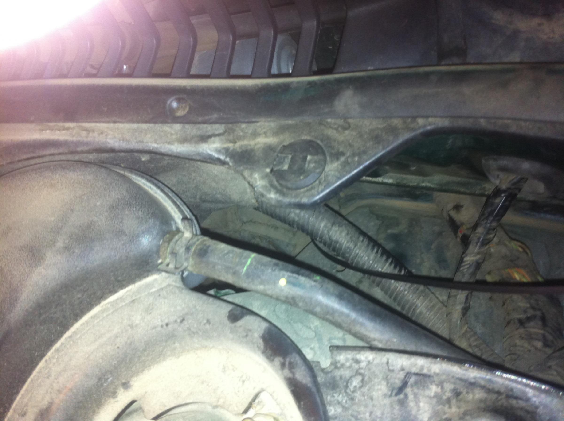

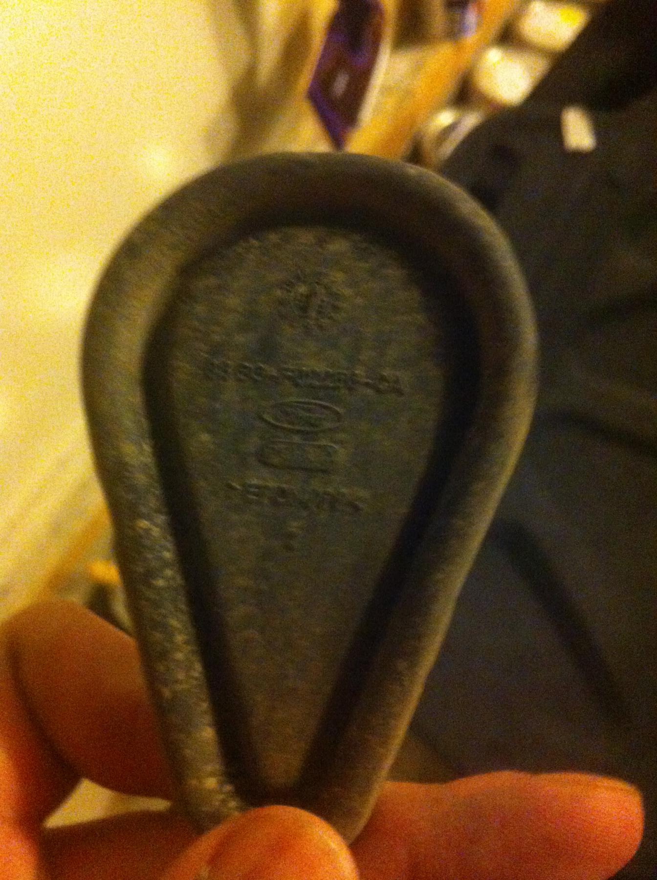

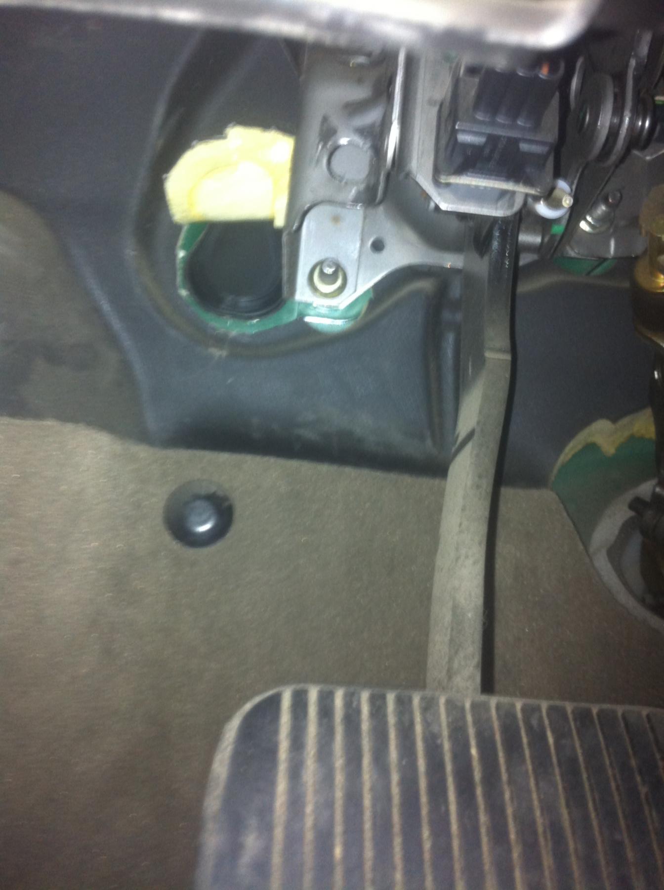

ok guys finally progress and don't you love it when car manufacturers just make it easy for you to do everything. just takes me aages to figure out. Right got some pics here. Theres a grommet right behind the brake pedal where you will see the fire wall slightly scissorred out but still stuck on. The rubber grommet is Kind of like an eyedrop shape. here are some pics. I am running a 4gauge wire and an 8gauge wire through there
