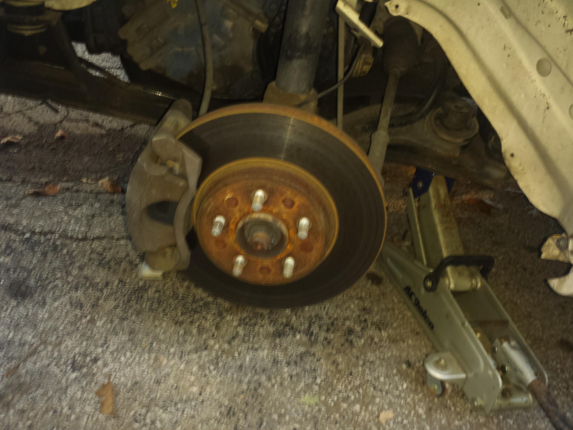

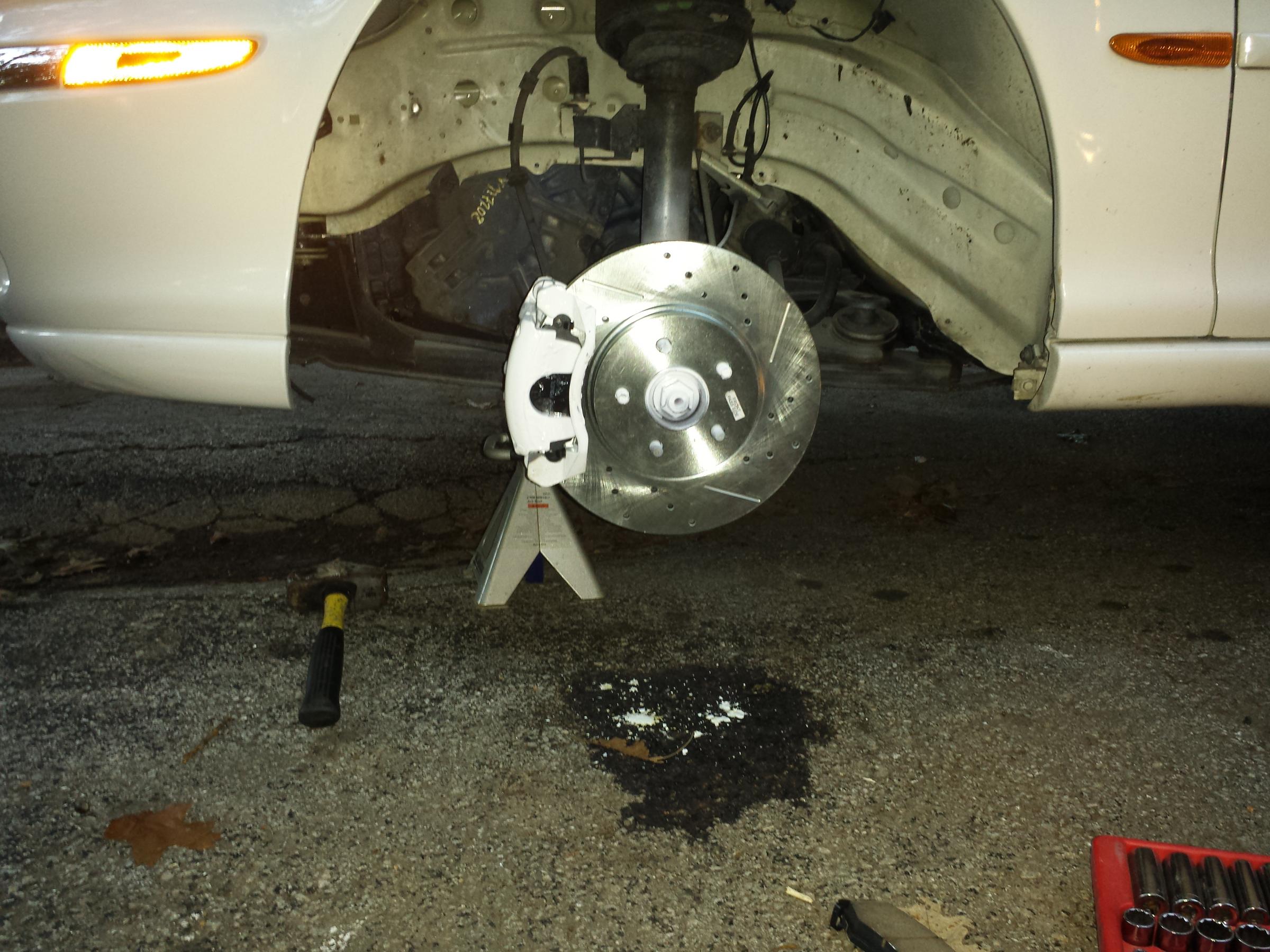

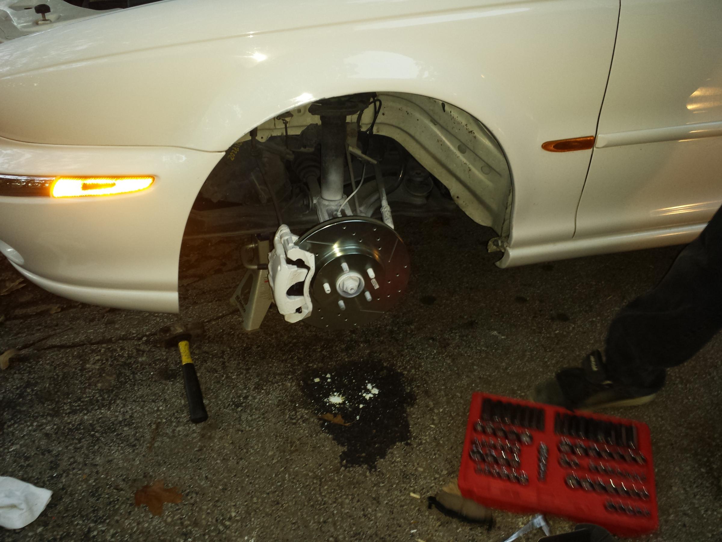

Im putting these on tomorrow, I will include a before pic of the wheel and post an after, they are zinc plated so will keep a nice shiny almost chrome look behind the wheel
before pic stock rotor

Syrup, a lot of us have put on the slotted/cross drilled rotors. I like the added stopping power that they added. But, also be aware that they are a little noisier than the factory rotors as these will tend to make a whirring sound during the first braking of the day and also under hard braking.
When installing the pads, I would also recommend using a little bit of stuff called "pad glue". It goes between the pad and the piston or the pad and the caliper and it essentially glues the pad to the caliper. This not only keeps the pad from chattering when not using the brakes, but also minimizes the squeal that is common with rotors.

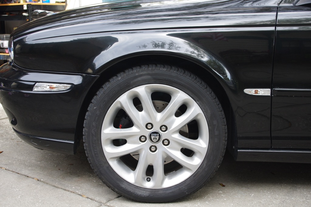

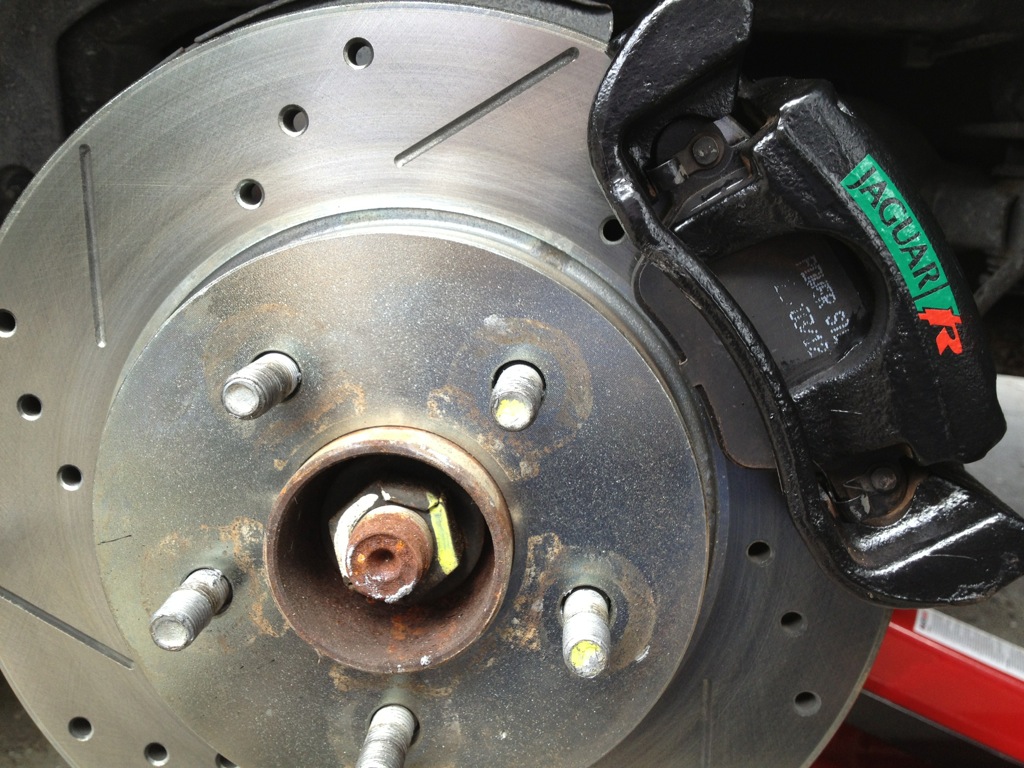

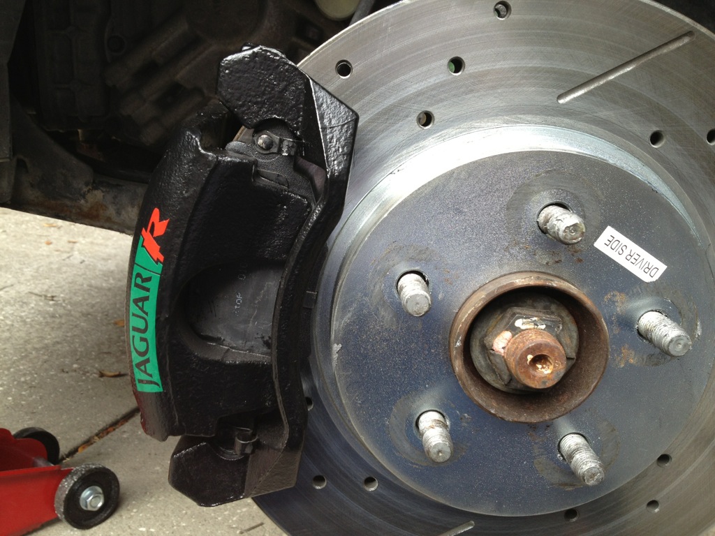

I did mine a little over a year ago. I'm very happy with the results. Also painted the calipers and found these decals on ebay. The painting kit was excellent except for the paint brush. I spent half the time peeling the bristles off the wet paint.
[/URL]
[/URL]
Attached Thumbnails X Type slotted and crossdrilled rotors-file-24.jpg   X Type slotted and crossdrilled rotors-file-23.jpg   X Type slotted and crossdrilled rotors-file_zps381fdc2e.jpg   X Type slotted and crossdrilled rotors-file_zpsce4068a5.jpg

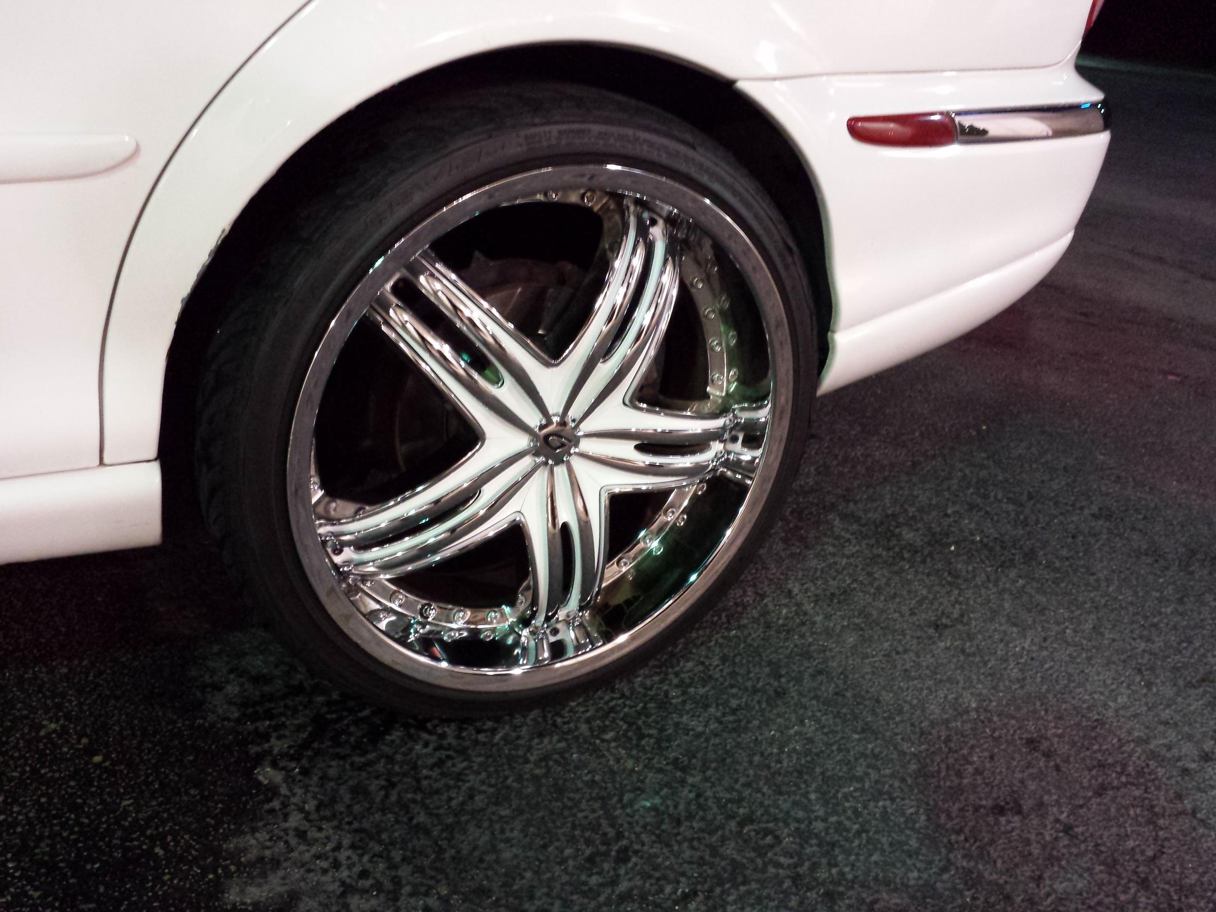

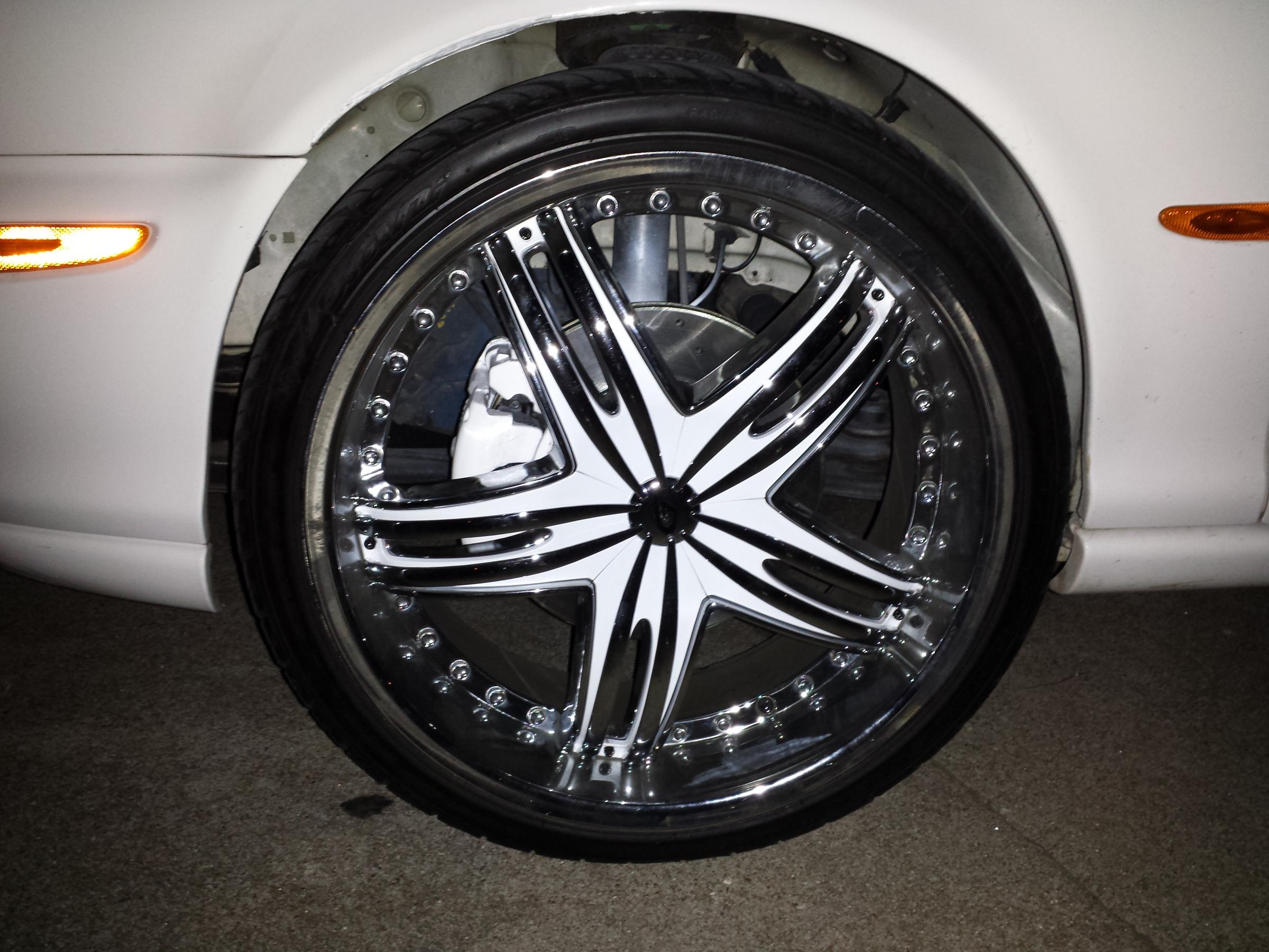

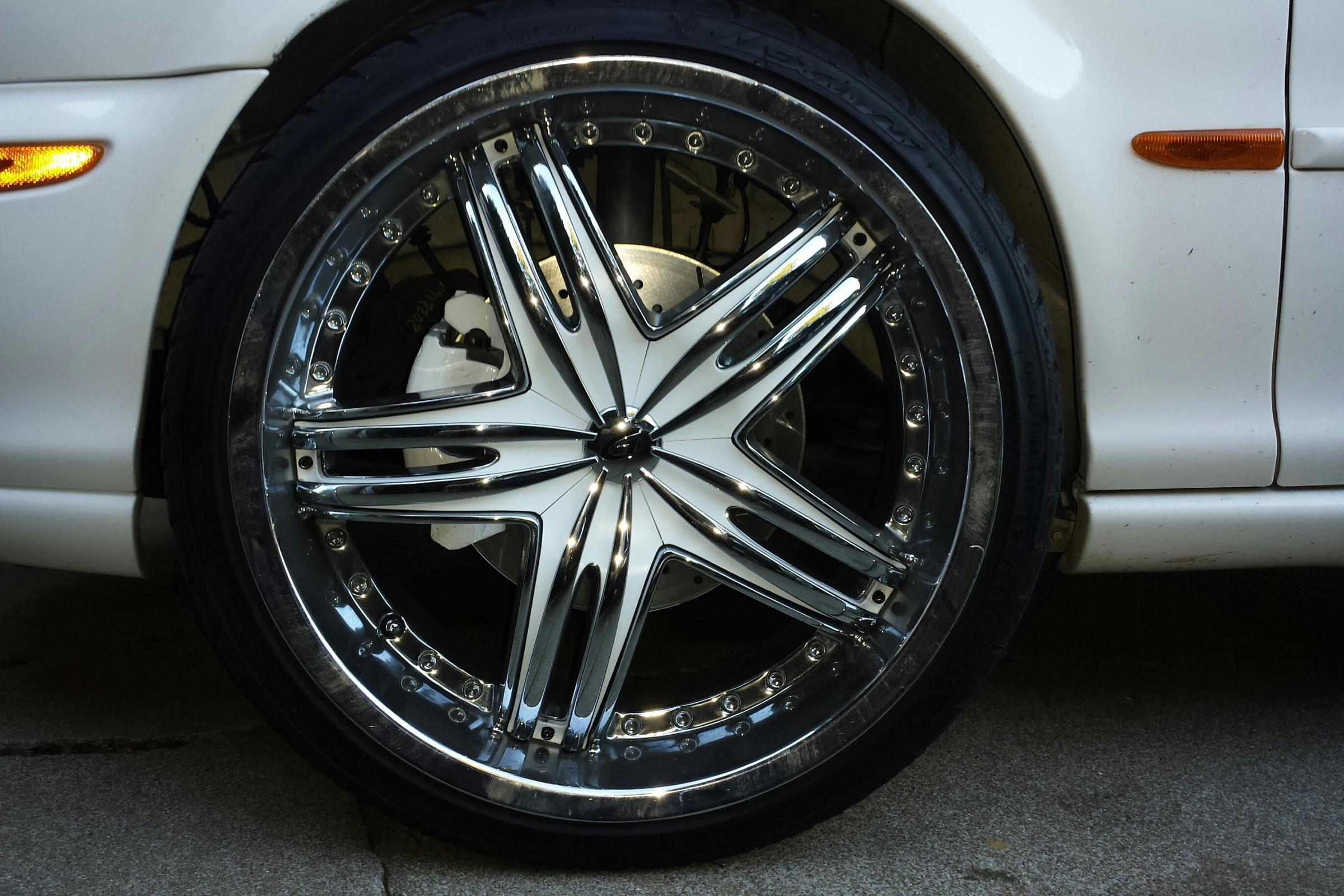

Ill have side pics when i clean the car tomorrow during the day
Attached Thumbnails X Type slotted and crossdrilled rotors-x1no.jpg   X Type slotted and crossdrilled rotors-a8ei.jpg   X Type slotted and crossdrilled rotors-83si.jpg   X Type slotted and crossdrilled rotors-fulj.jpg   X Type slotted and crossdrilled rotors-xa4d.jpg
X Type slotted and crossdrilled rotors-g6ig.jpg   X Type slotted and crossdrilled rotors-vudd.jpg   X Type slotted and crossdrilled rotors-jh88.jpg

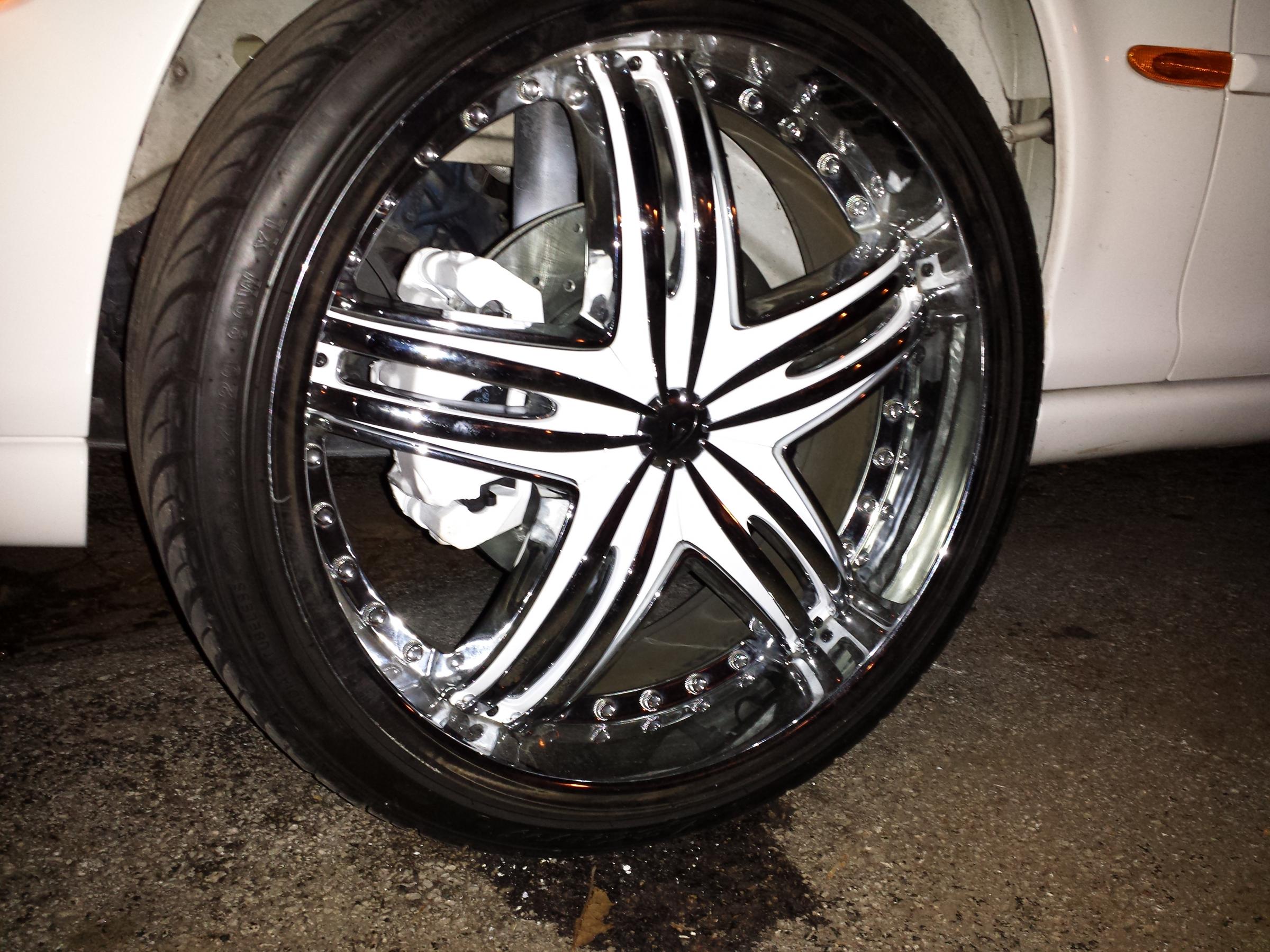

Day shots
