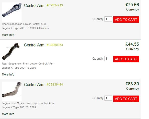

When searching for the arm on the internet, I found that there are actually two different arms that can be called rear lower control arm. Do you mind looking at the attached picture to point out the correct arm. Hopefully in the future I can become more knowledgeable to be able to identify the different components.

619jag, you are after the middle one in your list. If you look, it talks about it being the forward/lower arm. You may also find (especially if you notice that your rear tires are leaning in at that top) that you may need to replace the upper control arm too (bottom one on your list). But, if you are replacing the upper arm, you may want to go with the upgraded arm I ran across (comes from a Volvo S40) as it is also adjustable and can allow the shop to set the tires to the correct orientation.
Hey guys, indeed I changed the lower control arms and that completely took care of the problem. It was really a night and day difference. After the old arms were removed, visually they did not appear to be worn out but when feeling them out they were extremely loose and overly flexible (the bushings) as compared to the new ones. So glad the problem got resolved and that the Jag rides as it should.
