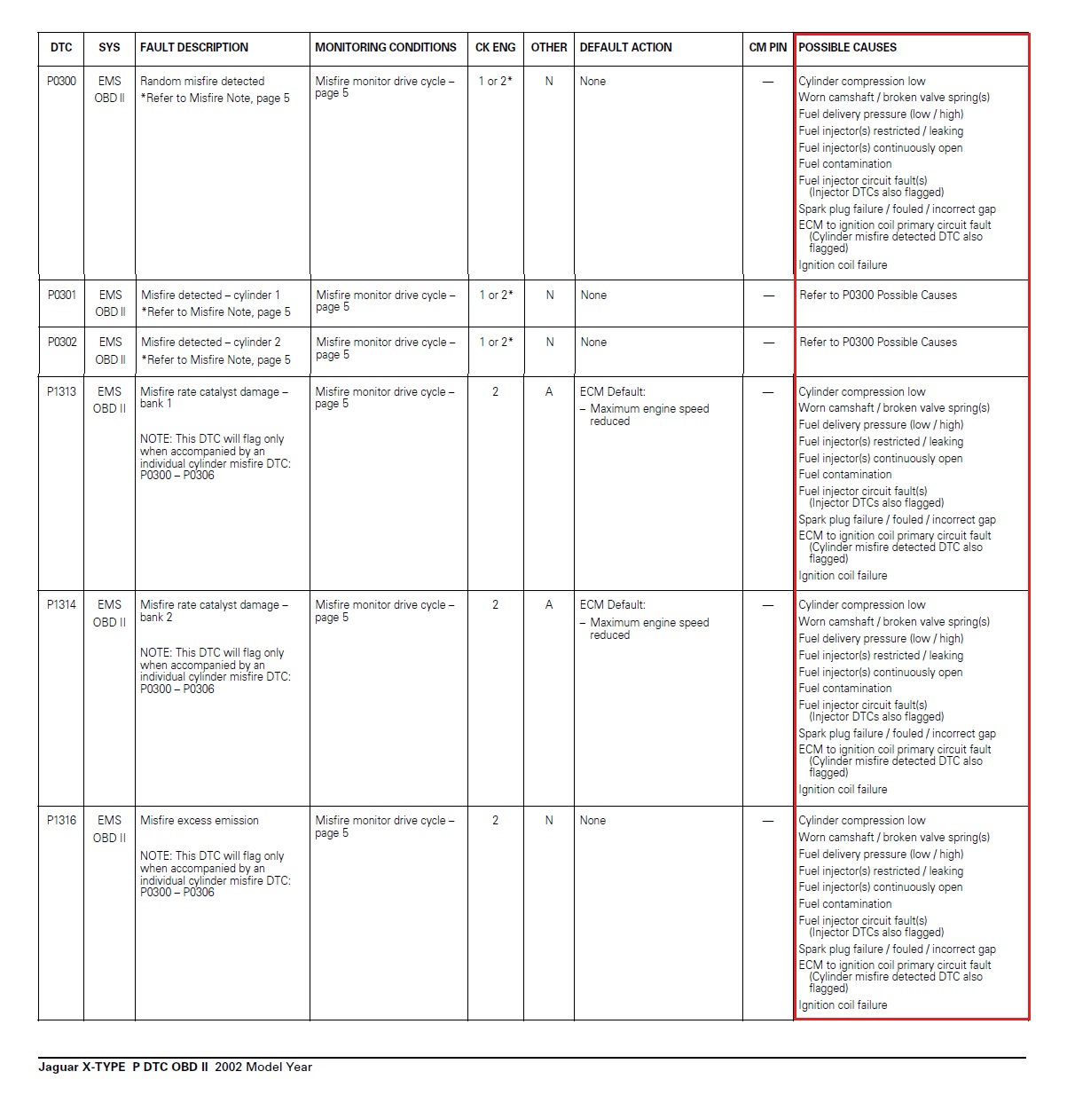

The Possible Causes for the codes you have are shown in the box on the right in the following table taken from the Jaguar DTC listing:
Any of the mechanical faults listed would be an amazing co-incidence on a vehicle that was running OK prior to the degrease. Fuel delivery faults are equally unlikely. The fault code causes will have been water in the ignition coil pack harness connectors or spark plug holes.
