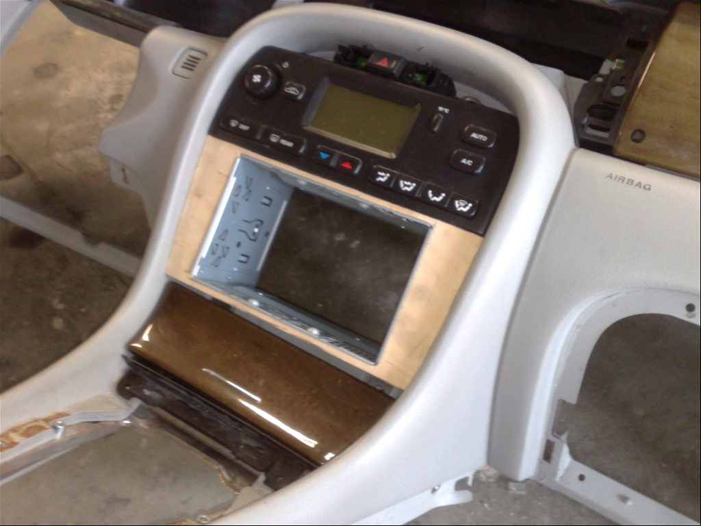

Well I just finished my introduction on the New Member Section! Now as far as the center console goes I have thought about an aftermarket set up as that is what I had in my last car, however the shape of the center console seems very specific. My concern would be how it would fit? Would there be an unusual gap between the aftermarket setup and the original pieces or is there going to be a big spacer block that’s going to just sitting there to hold it in (both of which I would not be a big fan of)?
Old Aug 25, 2013 | 01:15 PM
Aonsaithya's Avatar
Joined: Mar 2012
Posts: 1,072
Likes: 269
The big spacer block is the only solution I've seen here. There are plenty of old threads on installing an aftermarket headunit in the X-Type, do read them. There's important stuff such as how some deeper headunits don't fit in the top 2 slots because of some climate control thingy behind the dashboard.
Old Aug 25, 2013 | 03:36 PM
Thermo's Avatar
Veteran: Navy
Joined: May 2008
Posts: 14,803
Likes: 4,102
From: Great Mills, MD
Shaguar, unfortunately, if you are looking aftermarket, you are going to be force to use the spacer block. Other members have used them and what they did was to color match the plastic with the color of the radio or with the rest of the plastic for the center console. So, are you willing to have the looks of the plastic trim or pay the bigger dollar to have all the factory components installed.

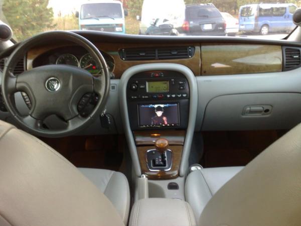

Well I guess those are my only options then. I’ll have to look around to see which way I go on that. If I put an aftermarket setup in does the climate control that is stock go out the window or would that hook up somewhere?
Old Aug 26, 2013 | 12:44 AM
Aonsaithya's Avatar
Joined: Mar 2012
Posts: 1,072
Likes: 269
I did see one car with the climate control panel hidden in the glove box, but that makes little sense to me really.
Attached Thumbnails Center console changes?-rycka-albums-jaguar-x-type-picture1965-30.jpg   Center console changes?-38083160017_large.jpg

I like the way that looks a lot. I'm definitely gonna go with an aftermarket head unit! Thanks guys for the help.
