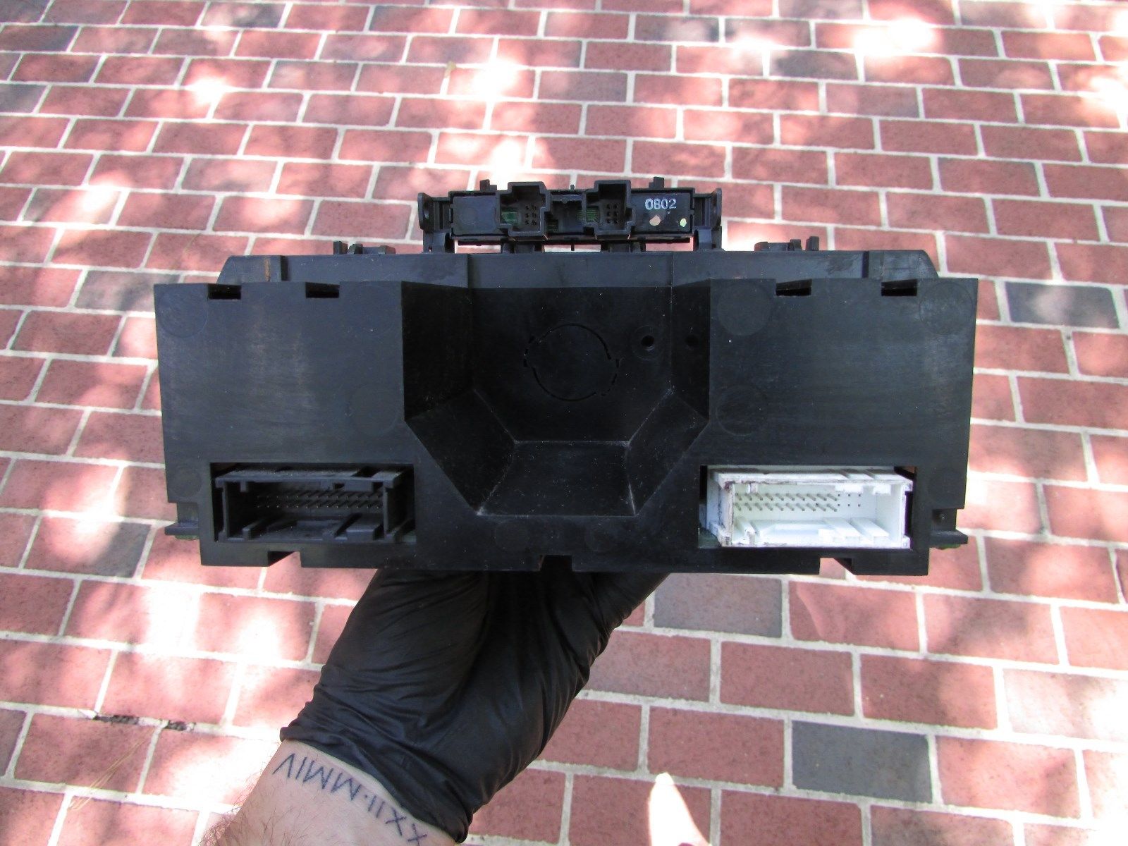

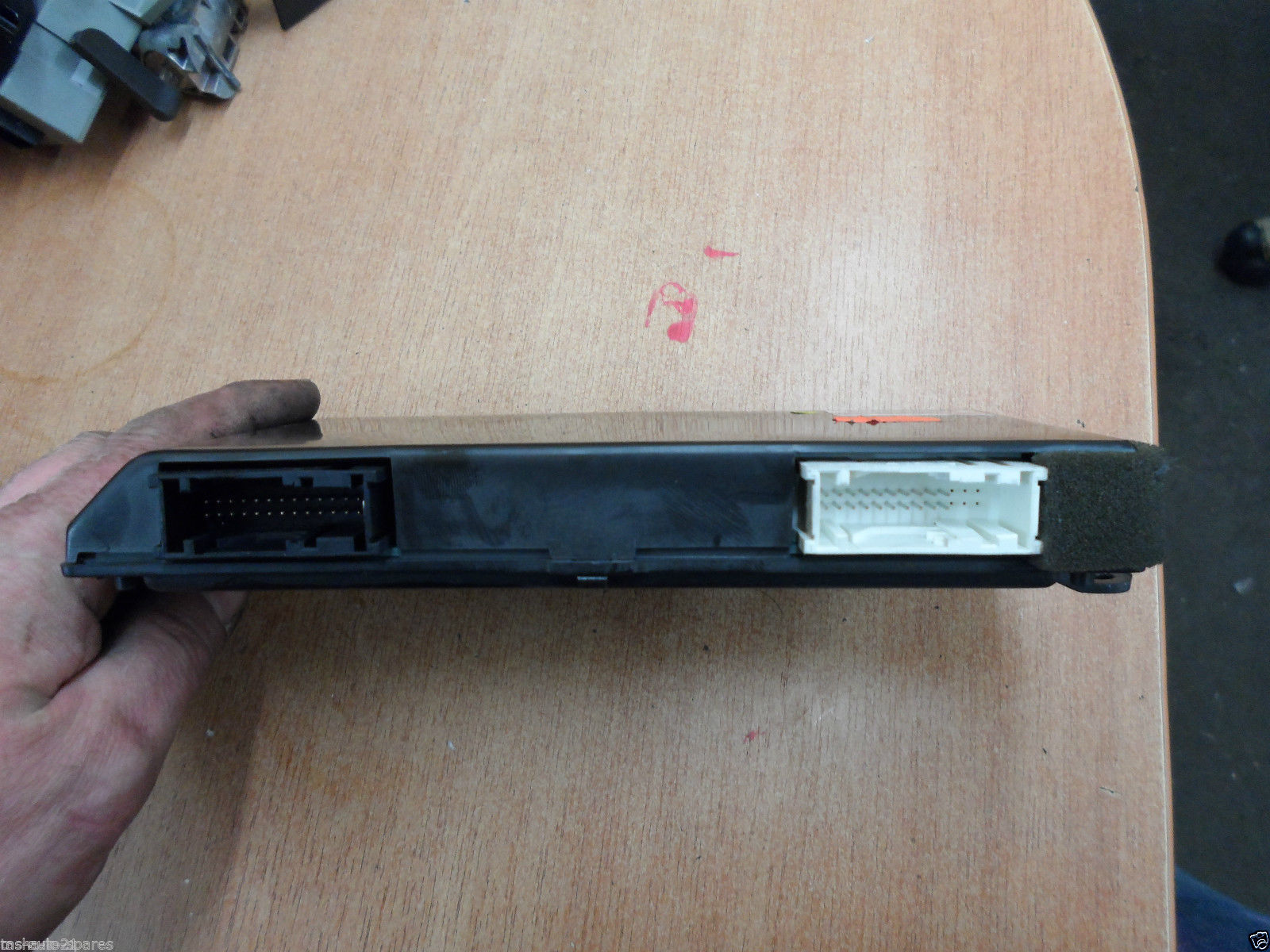

You will have this unit to control the touchscreen(pics 1 & 2)
You now need this)pics 3 & 4) connections are the same!!

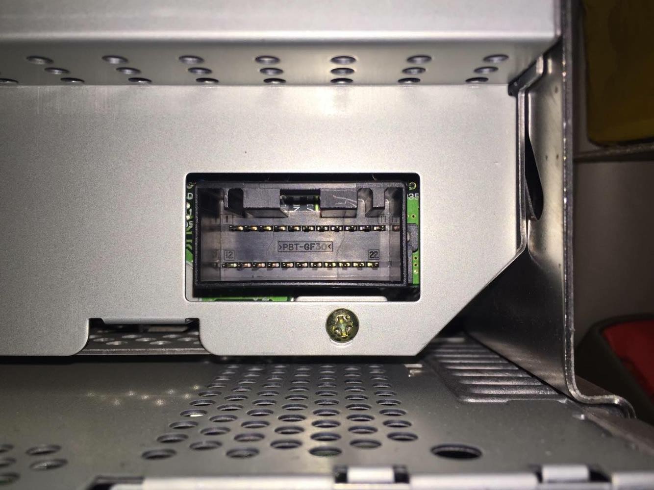

Default aircon connector
trying to post an image of the connector the garage says doesn't fit, ahh here we go, does anyone recognise this?

Have you removed the RCCM(Remote Climate Control module) unit(picture 1 & 2) as well as the touchscreen/CD/radio unit??? It is attached to the right hand side of the heater/evaporator unit behind the dash. It can be accessed easily by removing the carpet above the RH foot well and reaching up

From: Clydebank, Scotland
The picture you have posted is the connector for power/speakers etc. you will need a harness adaptor to convert it to fit the new head unit. Any reputable ICE dealer should have one!! E.G. - http://www.caraudiodirect.co.uk/ct20...-jaguar-x-type
