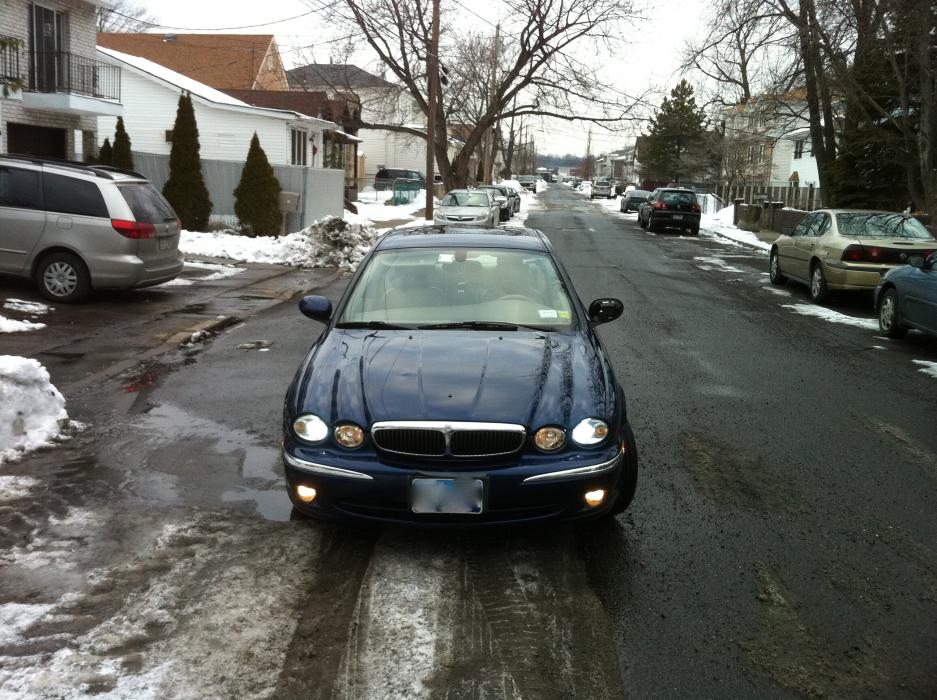

i made a thread before and i got some stuff fixed but i have the check engine light one with error code P0171 which said "system too lean" and i opened my hood and i hear hissing sound coming from the engine area(look at pic below) and i just cant seem to find which hose is which bc i read some other threads and the posters said to check pvc hose a brake booster hose and some other hose but i dont know where these hoses are located bc when i bought the car it didnt come with owners manual. The last pic is the one of my car lol and yes i know my side mirror is missing someone robbed it -_-"
