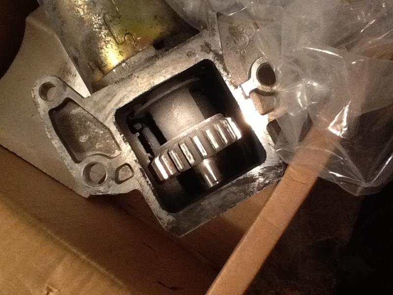

My '05 manual transmission is making grinding noises just after ignition. Before taking her into the shop I would like to learn a few things for myself and try cleaning the starter. I had heard that clutch dust can gum up the works and a cleaning and proper lubrication may fix the problem.
I think I can get the starter out just fine, but I was wondering if there is a specific cleaning and/or lubrication agent or tool that I need to use? Can you share any advice on the cleaning process?

Andahaion, as for a cleaning agent, stick with good old WD-40 and a clean rag. Get the starter out of the car, spray in some WD-40 and start wiping. Add more WD_40 periodically to help keep the gum loose. Then you can also use your finger to move the gear inside the starter to make sure that it moves freely.
If you see that the edges of the teeth have raised metal edges, you can take a fine file and trim those edges down. You don't want to really remove the metal off of the teeth, you just want to square the edges back up.

Just closing this loop: was unsuccessful in even getting the starter off the car. For some reason I just couldn't get to the solenoid electrical connector. So, called my fav shop and am having them replace the darn thing. Kind of bummed myself out.

Default All Fixed
It's been a few days since the shop replaced the starter. Good news is there's no longer any grinding noise. For future reference, attached is a picture of the old starter. You can clearly see that it was quite dirty and the gear did not move freely at all.
So, big thanks to the forum for the help. My only regret is that I was unable to change this out myself. I wonder if there's a special tool needed to get to that little solenoid connector? I'm not sure how anyone short of a pre-teen Chinese gymnast could have gotten their hands/fingers and tool in there to remove. Guess that says enough about my abilities...but it feels good taking care of business (TCB).
