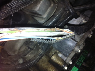

Thanks Thermo i believe you put me in the right direction i was concentrating mostly on a bad sensor. I check the wiring on both side of the throttle body and did not find anything out of place or damage.So i started checking along the whole wire harness and found a section that was a little to close to the belt and one wire was spliced. i repaired the wire and with the test drive i did notice a improvement in the performance but the light did come back on and if i punched the accelerator it will still flutter and the amber light will come on w/cruise control not available.
Also if it in the park position and i rev the engine there is a hesitation. It sound like a cough before it goes veerooom!
