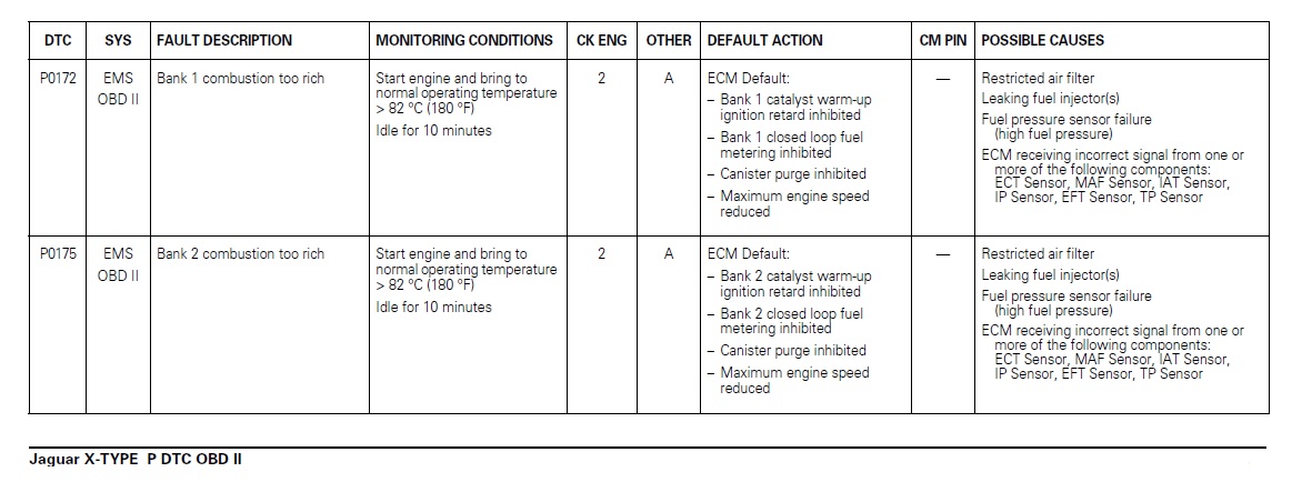

Here's the extract from the Jaguar DTC listing for P0172 and P0175:
There's more sensors than just the Fuel Pressure Sensor could be the cause.
