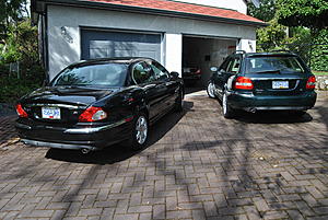

And here is important advice: have both the transfer case fluid changed (75W140 synthetic) and the transmission fluid changed (if it is an automatic - that unit is a JATCO 506E unit used also in Mazda, VW, Land Rover and others). There is no difficult in servicing these very reliable and highly UNDERrated cars - they are wonderful highway cruisers! Tell your hard-working son that this is not an oriental stoplight jack-rabbit - he should resist the urge to practice full acceleration starts from a stop - this is very hard on the AWD transfer case. Treated properly, these cars are good for 250,000 miles.
My wife is now in year 15 with her 2002 manual-shift X-Type which is used daily and sits outside 24/7. In these 15 years it has had TWO (2) mechanical repairs: replacement of an oxygen sensor(quite common), and replacement of the water pump - nothing else.
It receives no special treatment, just an oil/filter change once a year (and the transfer case fluid has been changed once). But it is treated with the respect that a Jaguar deserves - the result is that it looks excellent and drives as it did when new (and we have had two other X-Types, same story).
Attached Thumbnails Considering buying an 04 X Type for sons first car-What to look for?-x-types-003.jpg
